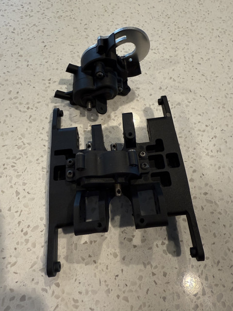

Starting with the basics everything pretty much checked out. The center universal will be replaced not bad I’ve kept worse in service.
html photo link
2 crunchy bearings so a full new set; I remember the days of trying to clean and service them but not anymore. Also added their steel transmission gearset. These things are no joke, I’m not fond of the rotational weight but whatever. I don’t really remembering why I ditched the originals but they must have been worse for wear.

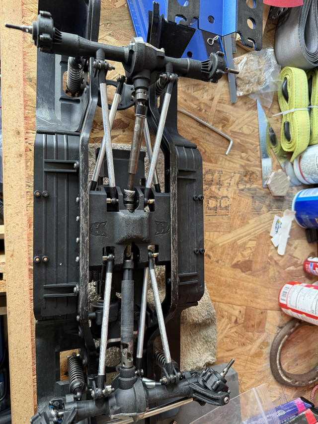

The set of GTS came in, got the links installed and the wheels mounted again so I guess it’s officially a roller now. I haven’t worked on a single car this much in a long time. Oh how I miss it…
FWIW the bottom shock eyes on the GTS fit the ball studs on the Redcat’s on the front. I had to shave a little from the axle housing between the double sheer mounting on the HD axles.
