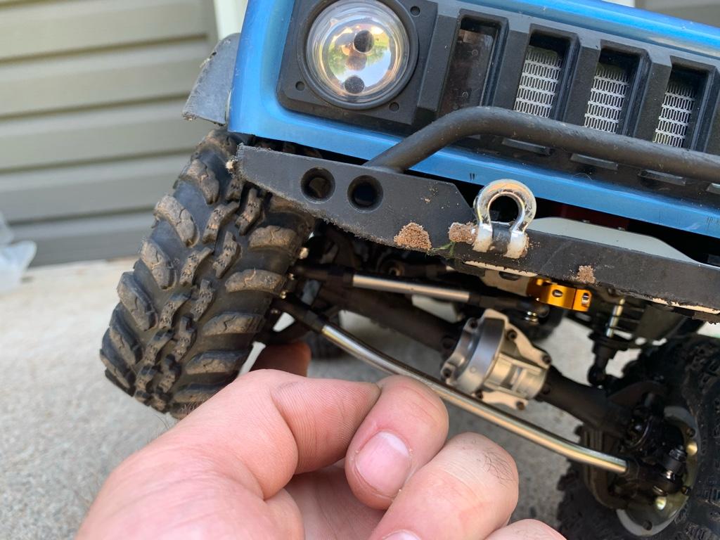

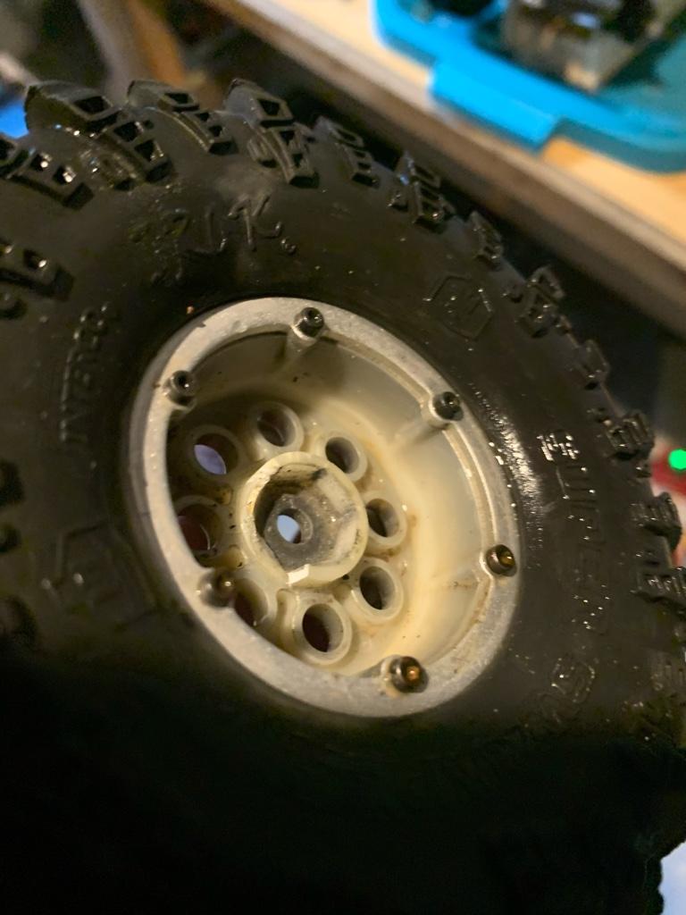

Well today was a carnage day. Broke the hex drive in a wheel and twisted the club 5 link down.
It’s hanging really low here..
Gave it a flip
Now the bend is angled up and away from the pumpkin. Hopefully this works good. I smashed the tie rod quite often and it was definitely a detriment to today’s run.

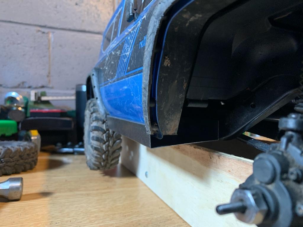

Well with Rona out of commission I decided to boat side it. Used 22ga sheet metal. Turned out pretty good. I’ll be doing a full set of fenders and what not but this is where I’m at today.
Gave it a flip

Sorry to see the carnage! However, what you have shared is the exact reason I sent that setup back. I knew that there was going to be issues when running the setup out in the wild, especially with the way the front link flops up and down and hangs so far out in front. The other issue I had was the tire rub after bolting the links on the knuckle and didn't feel like dropping more coin on wideners and etc for an already funky setup. Last but not least I noticed issues with the steering radius when driving around inside and found the stock setup to have a tighter radius.
Hopefully you will find a happy medium with that setup and still be able to use some portion of it. I also bought a tire combo with club5 dual stage foams and the freaking foams were 10mm too narrow for the tires he paired them with. As for me I have eliminated anything designed and made by club5 from my shopping lists. Happy wheeling!

Idk I’m happy with the club 5 stuff. Everything is very well finished and the fit of the mount was superb. While I agree the tie rod could use some more work I think it’s a good set up. I twisted it up and it works fantastic. Just enough clearance at the pumpkin lock-lock and it sits higher than the axle centreline. Works great. Ymmv
Got the fender kick panels roughed in and brazed on. New tub of flux showed up today so I got right to the heat :))
I’m pretty sure these square corners I put on the leading edge will get hung up but idk I’ll try it.
