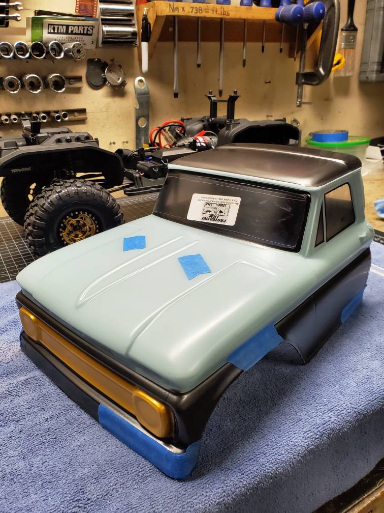

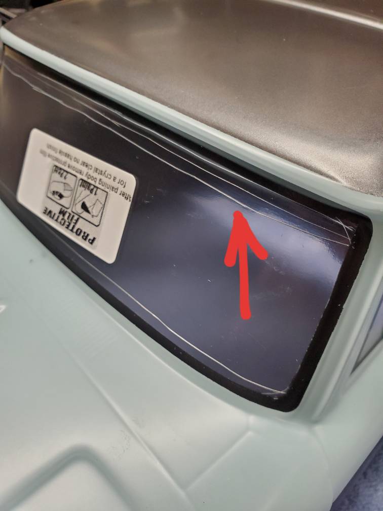

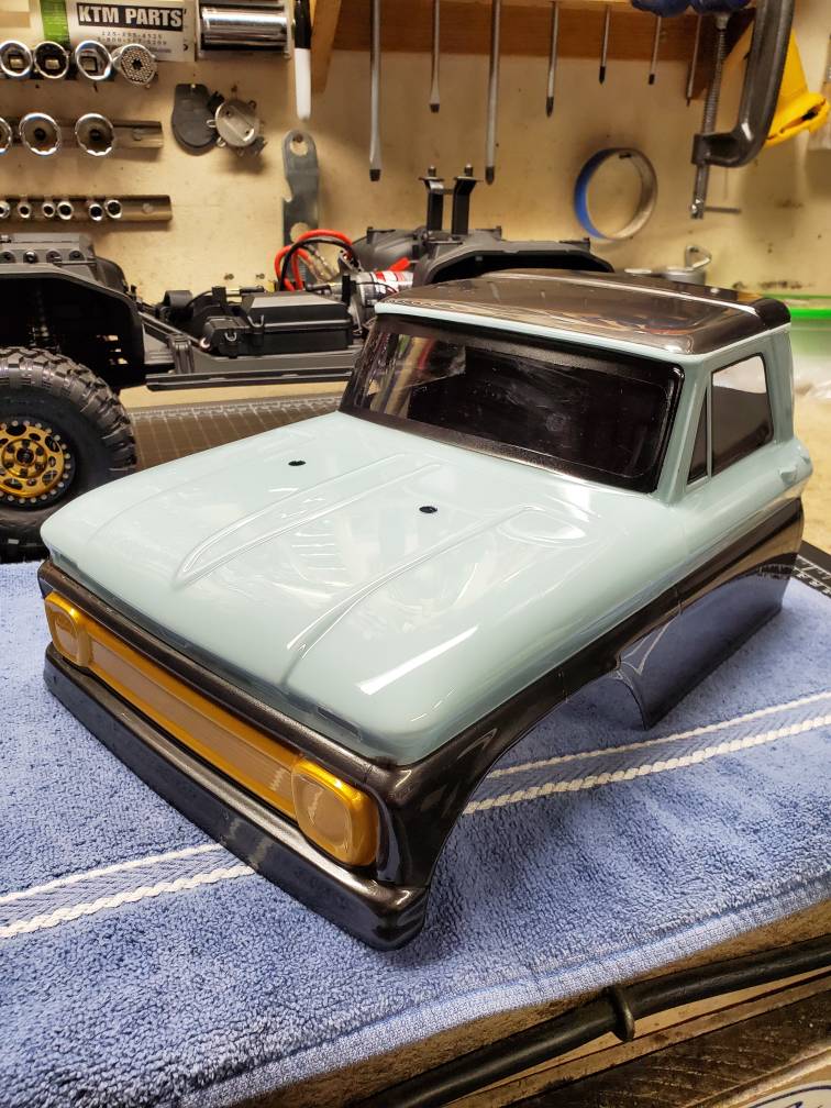

Everything's been coming out really great with my paint. The one area I struggled was trying to do the window trim on the inside. Unfortunately I got a little heavy-handed with the hobby knife and cut deep scratches in the lexan.[emoji53]
I had two thoughts for fixing:
1. Tint the windows by spraying a smoke color on the inside, however I have a feeling it really won't hide the scratches?
2. Since the protective film is still on the outside I can trim around the windows and paint with a flat black on the outside?
What's my best option here? The door windows came out nice it's the front windshield and rear window that have deep scratches/cuts.
So bummed! [emoji37]

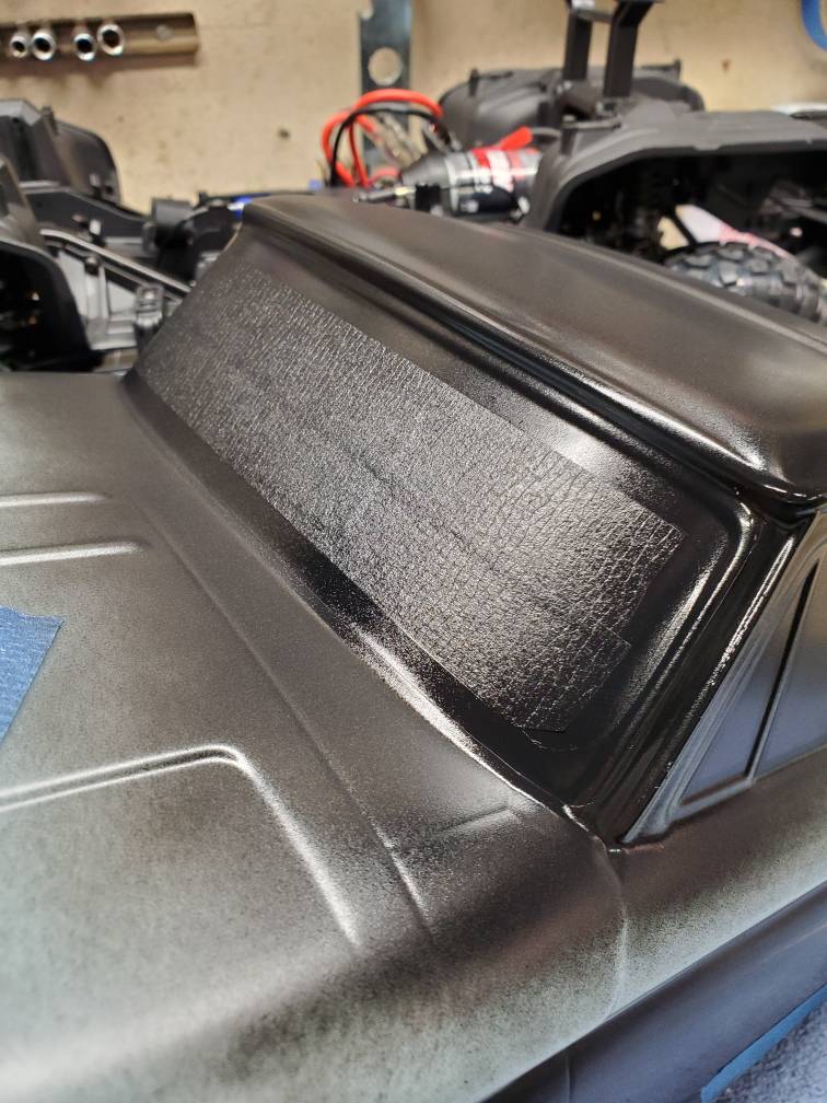

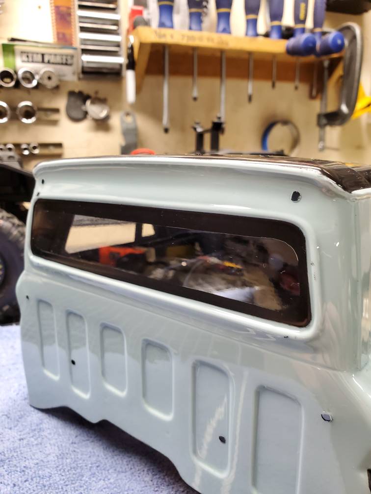

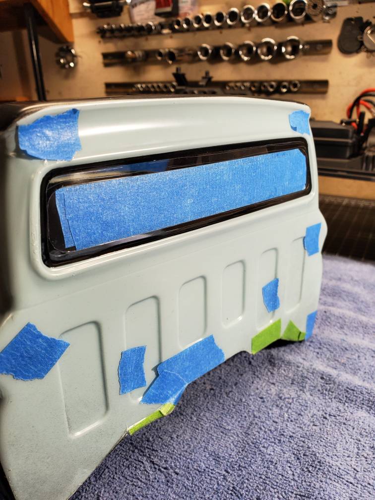

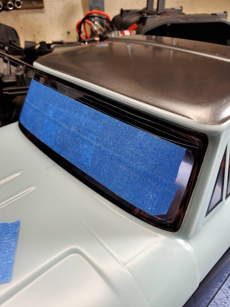

Well I realized I need to suck it up and trim the overspray film so I did it already and it wasn't too bad at all it came out real clean just need to shoot it with flat black paint. I used the blue tape to give me a straight edge to cut on the inside line.
The rear windows is going to be the tricky one to make it look right.
Sent from my SM-G973U using Tapatalk
That wasn't too bad! If all goes well I'll be able to shoot paint tomorrow if I can get the paint!
We're going to save this paint job after all!

I think masking the outside of the windows to create a larger window weather seal is your best bet. Seems like that’s the direction you’re headed. That Testor’s paint is an enamel base and probably won’t hold up long on lexan/pc body. I’d score a can of Tamiya, Duratrax or similar for lexan/pc.
Like mewalsh suggested, stick with Polycarbonate/lexan paint. Using that enamel Testors will prove a worse error than you knife marks. That said, yeah, either widen your moldings or stop looking at them. As your body ages and scratches they willl begin to blend in. Perhaps another option is to turn that windshield scratch into a scale crack:mrgreen:
You painted it up nicely, it looks great!

I would suggest a banner for the front windshield and maybe some old-skool louvres for the back window. For the lower scratch on the windshield, you could make it look like a cracked windshield by making a spider web crack in one of the corners. "thumbsup"

This or I'd just roll with it, it'll soon be all scratched up and barely noticeable. Great looking paint on a sweet classic, I'd just leave it, maybe gently buff by hand on the inside with some tartar control toothpaste would reduce the cuts visibility, try it on small part of the rear window first though. "thumbsup"

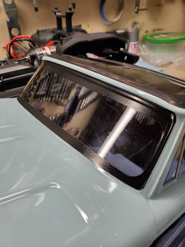

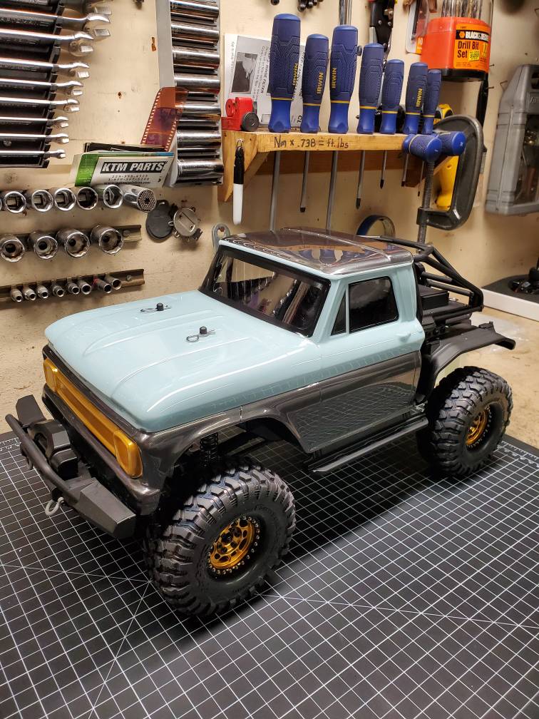

Paint is happening... I'll let dry overnight and peel masks tomorrow! [emoji106]
