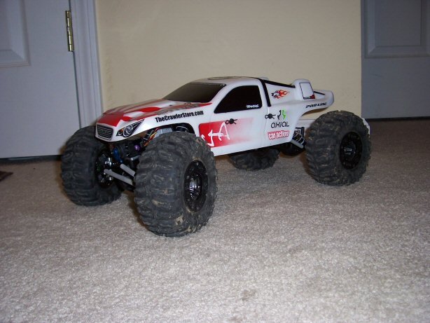

Hey Guys, I just finished Building my First Crawler. It's an AX10. Took it out today and i am Hooked :) I did alot of reading on this forum before building it and it has helped very much. Well now Im ready to turn it into a full compitition rig. I do not know what route to take so I would like some input on what I should order up.
Heres what I Have now to start with.
AX10
Mamba Max
Integy 55T
5000 MAH LIPO
ACE 1313 Servo
(2) Airtronics Rock Crusher Servos
M11 Control
Spectrum 3ch Reciever
What do I want to Have?
I want a full on compition rig that I can use in the 2.2 class. I want the best of everything (i dont know what that would be though) so I need your help.
I have been looking at the CKRC stage 2 kit, the hustler 2.2 chassis and such. I like the way the Hustler looks but is it going to be the best to have the ability to win ? (if i learn to drive it of coarse? :)
Should I go with a Tuber and get the Hustler, or should i just tune the Stock AX10 ?
What about the RC4WD R2 tranny w/ disconect? Do I want the DIG ?
Upgraded Shocks, Which ones ?
What parts or hop up Parts should I get and from where?
Relace Stock Tires?
What Foams?
Which Bead Locks?
Should I keep my LiPo or go with saddle packs over front axles. If saddle packs which Batteries should I get 6cell- 8cell , 1500Mah- 3000 Mah, and where from
Bacically,
What would you order up if you could put this A10 together any way you wanted to , and create a dominating sweet rig.
If you have a sweet idea then please let me know. What all i would need to complete this Project and where i could order everything from?
I know I just asked a ton of questions, sorry :) Any and all help in coming up with a complete package would be greatly appreciated.
Once i get enough input or a nice set of plans, I will order everything up and then do a Live Build of this project.
Ill title the thread........
Converting stock AX10 into a DOMINATING RIG... or something like that :)
Look forward to some input. Thanks, Patrick

my ideal comp ax10.
4-link mounts
aluminum C's and knuckles up front
straight axle adapters out back
heavy duty R&P's
Bent lower links
r2d tranny and servo mount
jato shafts
softer axial springs
hitec 5955 servo
axle mounted batt
losi claws on axial BL's
kreepy foams and lead strips
probably more that im forgetting. Man I would hate to tally up the bill for that setup. :roll:

----The Stage 2 kit would be a nice upgrade. A hustler 2.2 would work well too, but honestly I havent been super impressed watching the 2.2 versions compete.
----Stick with the stock Ax10, but do the following:
---- Put 3/4" fuel tubing inside the shocks as limiters. Run 1000 weight diff oil all the way around, and softer springs in the front. Get the upgraded servo plate, and use a little battery pack next to it up front. Put lead wrap weight or airsoft BB's in the front tires, and depending on what tire you run, you might want some cut foams in the front and wider cut foams in the rear. Bent links are nice. There are many other comp tweaks for scorpions- go to the ax10 section and read up.
----Yes, if you are serious about competition, you'll want dig.
----You could either limit the ax10 shocks, or eliminate them and go with some Traxxas XXL big bores. That'll make your ride height awesome.
----Aluminum knuckles, C's, lockouts, straightaxles, HBZ carbon fiber set, etc.... All from many of the vendors in the vendors section, or your LHS if they are cool at all. ;)
Relace Stock Tires?
----Yes
What Foams?
----Cut the foams that come with whichever tires you buy.
Which Bead Locks?
----Stock Axials are fine, unless you have chash, then I'd get the new MSD aluminum beadlocks.</b>
----You'll want some kind of battery on the front axle. Go with a little 3 cell Lipo.</b>
Bacically,
----Everything can be ordered from the vendors.
Converting stout stock AX10 into a DOMINATING RIG... or something like that :)
----The key to total domination is less about truck, and more about driving ability. Practice...

Well Guys, Thanks for all the input amd PM's
Thanks to your help, I put together a list and have ordered the following . Thanks for listing all the vendors for me also, It really helped
From Bender Customs
SW3 Silver frame Chassis with exstended skidplate (Eisier to mount the R2 Tranny or the Axial) Brad is a super cool guy, he even went to His Local Hobby shop to get the Jato links to ship out with the Chassis. Way Cool of him.
From RCP Crawlers
I got the Aluminu Axle C's, High Clearence Knuckles, Losi Rock Claws, Kreepy Pink Narrow for front, Kreepy Red Wide for rear. Super soft Axial Springs and A HPI Bug Body
From RC4WD
I got the Black R2 w/ Disconect and the Staight Axle Lock Out and Stainless solid axles
From Local Hobby Shop
Went with the Axial Front Battery/Servo mount . 1250 Mah 3Cell Lipo to mount over Axle. Axial Bent Links and Misc Hardware to complete the conversion.
From MSD
2.2 Hot Shot Aluminum Bead Locks, ( Awsome set of Wheels)
Its Like waiting for Christmas to come, I cant wait to get all these parts here so I can start rebuilding and end up with what I hope will be a pretty capable rig,
Ill post some pics once I get it all together. Along with the changes I noticed from the mods and Conversion. Thaks again for everyones input and recomendations.
