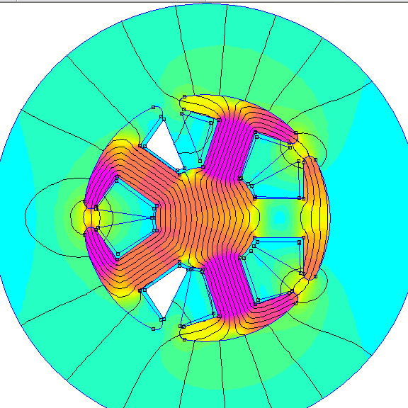

"Somebody" wanted some custom motors for a top secret project, and off the shelf armatures just won't cut it. So I started modeling up the magnetic circuit since I couldn't sleep. Basic square circuit at first so I can judge the flux intensity at 20 turns and 50 amps. Now we start shaping the head and setting airgaps and back iron thickness. Fun stuff designing from scratch! "thumbsup"

Another armature we are working on, this time for my team drivers. This is the stock Crawlmaster armature. Even though it took first place in 2.2 Pro this year, I know that it can improve greatly. I won't reveal how though, that's my secret! Dare I strive to match the TorqueMaster in torque? :mrgreen: At the least it is a good brain exercise and will get me back in the swing of Maxwell's equations.

A great start to some custom arms for my competitive drivers. Not only did they pull first place in every class at comp nats this year, they got first in all the Scale classes too! I owe them some work!
First step is to take out the "hot spots" where it saturates first. Second part is to bump up the ability to generate torque. Done and done.
Sagami lamination saturates at 90 amps in air. Holmes lamination saturates at 140a. When I get back home to a powerful computer I will throw some magnets and back iron into the equation and re-run it. I can only run one phase at a time (crappy computer) so the values will be lower with a fully energized arm.

More work on a new armature, for my own rigs and driving team. Shown here is a magnetic representation of the current lamination shape, pink represents saturation of the armature at 80 amps. So of course I have to try it and beat it. Efficiency, torque, and brake will increase. Combined with Neo Magnets it will make one helluva motor.
