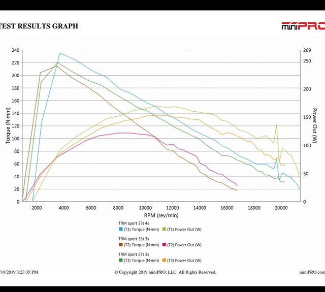

First off, punch is how much power you have from a standing start and has zero to do with top speed. It has more to do with Torque then anything else.
A trx4 comes with a 21t 3-slot 550 motor which is so much better then a 20t 5-slot 540motor.
Bigger motors produce more torque.
Lower turn motors produce more speed.
You want both.
Power = Torque x Speed
Higher voltage increases power
lower gears (smaller pinion) converts speed into torque. (power doesn't change)
A 20t 540 motor is just slow, but it doesn't have much speed or torque, so it doesn't have much power, so its not really good for anything except longer run time.
If you want to do burnouts and crawl then you want power.
To get power use a 550 motor can be 3slot(more power) or 5slot(more crawl), 2200KV is the sweet spot for brushed motors for maximum power. (that's like 8-10t 5-slot 550 or 21t 3-slot 550)
Then throw as much voltage as you can at it, preferably 4s, but most cheap esc's are 3s only (like the Hobbywing 1080)
Then adjust the gearing till you have the best blend of crawling and burnout (larger pinion for more speed, smaller pinion for more crawl)
The thing is there is not really enough power in a cheap brushed motor to do both burnouts and crawling well until you use 4s lipos and have the right motors and gearing.
Paying 4x more money for a higher quality brushed motor can almost double your power.
IMO if your thinking of doing this then just save up and go with a quality setup like a Mamba X and Puller pro. If you get a 2200kv puller pro-R you can run it on a 6s lipo for burnouts and switch to 3s for crawling.

You say you have a 5slot now? A 20t 5slot is about a 40t 3slot rpm wise... And a 540 will be weak compared to a 550, as have been said. You need torque and power, not runtime...
Pop a 10t 550 5slot in and you should be almost back to where you where, but with smooth low end.
