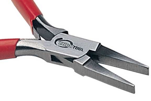

first start out with a nice set of tin snips some nice flat nose pliers

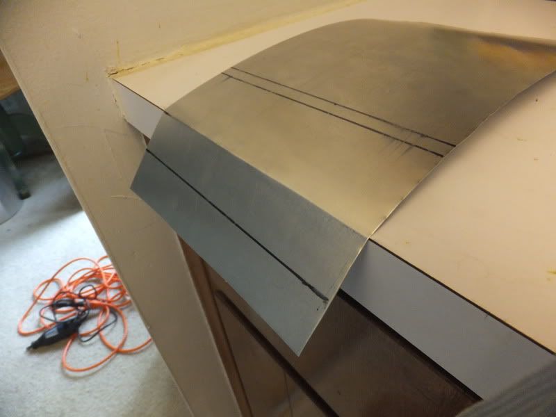

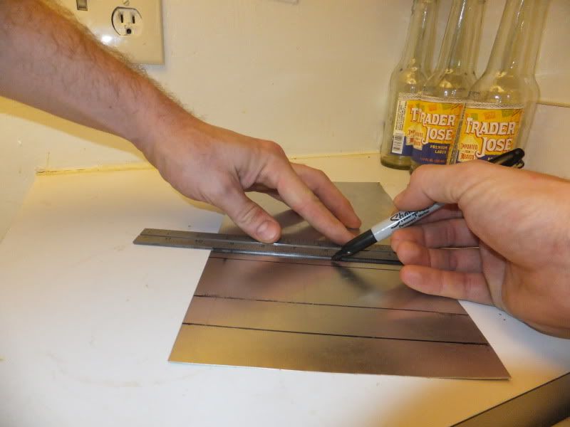

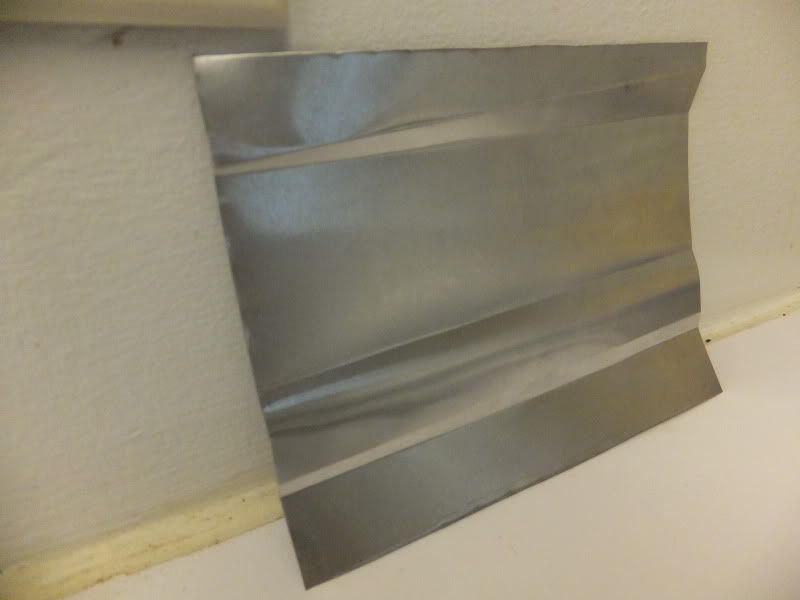

first you want to mark all your lines. i usually use a pencil, but for these pics i used a sharpie so you could see the lines
then you want to line up the ends of the lines with the sharp corner of a counter top, coffee table, work bench, something like that.

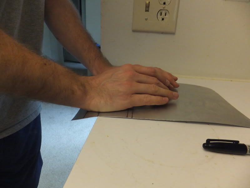

the next step it where you need to make sure you have extra sheets laying around because once you put a crease in you can't get it out. practice, practice. sometimes i like to use some masking tape to tape the sheet to the counter before i bend, but did not do that for this example.

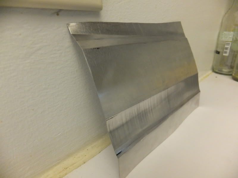

take the flat of you palm and apply pressure to the lines in firm jerks of your body weight, it doesnt take much to put the little crease it, after you get a crease in with both hands you can use your thumbs in the same manner to really sharpen up the crease.
then go ahead and start creasing your other lines. and you end up with something like this. for the slightly curved area you kinda need to roll the surface over the corner, it is not as exact as the creasing technique, but can be done to make a nice filleted curve.

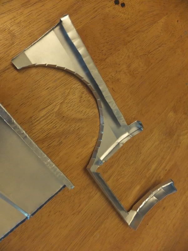

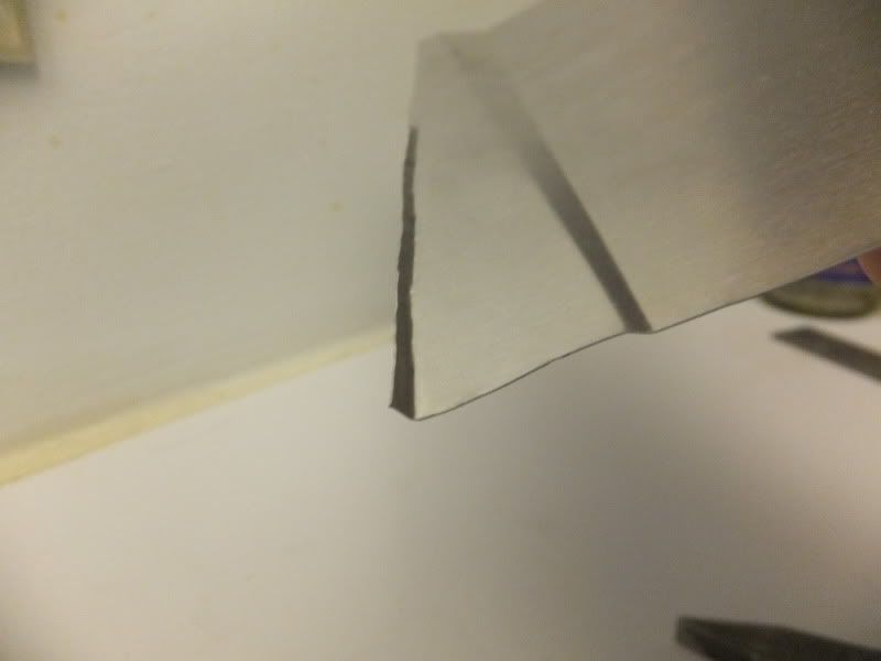

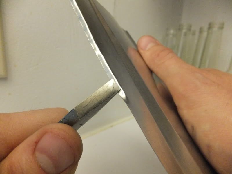

now you need the flat nose pliers to put the edge on.

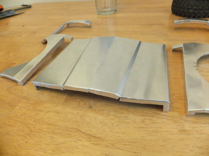

this edge makes the piece more structural in nature and gives it a nice solid feeling. i like to make the edge somewhere in the 1/16-1/8 wide. you just take you pliers and starting at one end pinch the edge down. take you time and dont try to make a 90 bend all at once, you can crack the flashing and ruin your panel. you want to make 2-3 passes with the pliers along the length of the edge to complete the edge.
you can go crazy from this point and make double edges, as seen in my M-715 build. (see signature link) these will give you a nice strong U channel that you will feel confident can take quite a bit of abuse before it will get wrecked on the trails.
