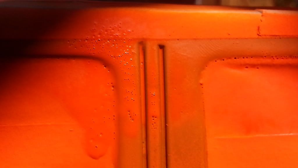

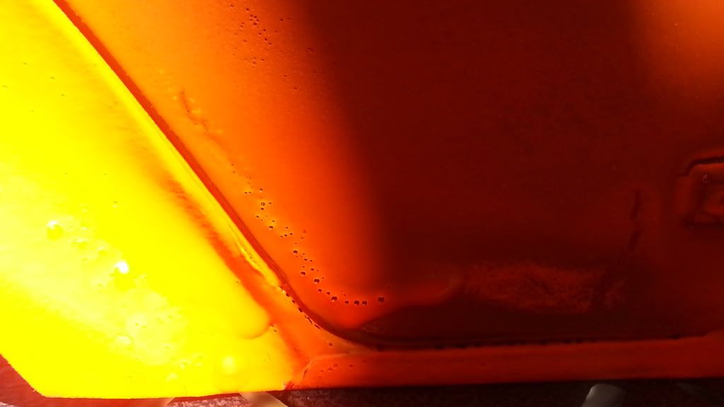

Applied the first layer and immediately saw a fury of air bubbles, significantly more prevalent than the first.
:evil::evil::evil::evil::evil::evil::evil::evil::evil::evil::evil:
I nearly threw it on the ground to say F it. :shock:
I've since let it dry and am perplexed as to why this is happening. I will admit I recall air bubbles forming on a lexan body where I touched it with my finger and left my finger print. Is this the culprit? I'm not cleaning thoroughly enough prior to applying? This is also my first time using Tamiya paints but I've heard nothing but good things about them. Am I painting too close? Too thick of a layer? Help me paint gurus!!

I dont think it is air it looks to me like solvent pop it happens when the primer or base has a different dry time then the top coat , how long between your primer and top coat ? I just had the same thing happen to me but mine was on a hood for a 1:1 tractor trailer ....
It can also happen if your paint it a little heavy or thick the outer layer drys before the inside and the solvent cant get out

check the products you are using for the recommended dry/flash/recoat times - it looks like solvent pop to me too.
most solvent based products should have a flash/recoat of within XX minutes OR after XX hours...
As an example - within 30 minutes, or after 24 hours. (not actual times, just an example) if you miss the recommend short window - the 30 minute example, it is best to wait the longer time - the 24 hours in the example, before trying to recoat.

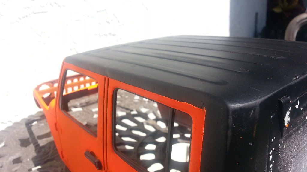

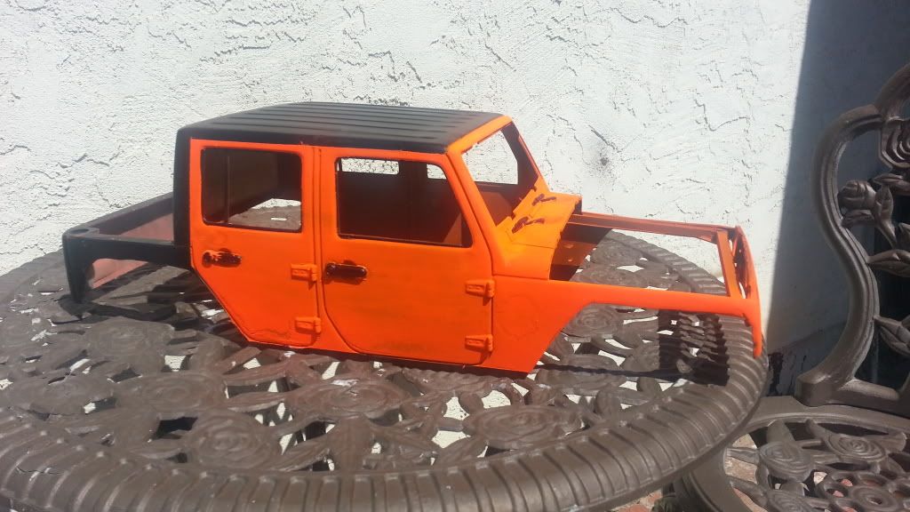

Did not.find any flash info on the testors can. Well I let it dry for 72 hours since I was out of town. Went to paint today. Masked, washed thoroughly, and put down a layer of orange. And this was the result.
As I told a friend I nearly threw the body across my garage but didn't.
I think I'm just going to sand the entire body down to plastic, and start over with all the same brand/age primer and paint. Too frustrating to apply more orange if this is the result...more sanding and reapplying, at this rate ill have 20 coats before its "nice"
way to much paint, and judging by the finger print, something wasn't dry when the paint went on.
you probably got something oily on it as well if all you used to clean it was water, oil from your hands can cause fish eye.
could also be a paint solvent base issue, some paints dont mix together well and can cause previous paints to melt and bubble or wrinkle.
i dont know about lacquer and enamel,see it happen alot with different spray paints, was it painted when you got it?
i wouldn't put anymore paint on it, as think as it is, it'll be days before you can sand it. it'll just gum up your paper
