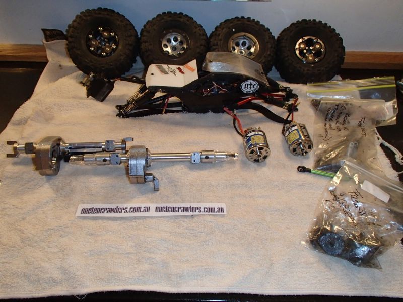

The parts I started with
Parts List
- Berg V1 Axles - modified by Hulksta Engineering
- Blitz Pro-wound 35T matched motors
- BJv3 Chassis, custom skins
- Fronts - were Vanquish Products DH Pro Comps with 3 slugs per
- Rears - Proline 2.2 8 Shooters, for now
- Sedonas all round
- traxxas Big Bore shocks with the Rod End mod & Mini T front springs
- Lower links, front and rear are (I think) XR10 Hi Clearance Delrin
- Uppers wer homebrew 8mm delrin fronts and axial HC bent rears.
- Tekin FXR ESCs
- Hitec 7954 HV servo @ 7.4v
- CC 10A BEC at 7.4v
- Futaba 4Pl and 2106GF rx

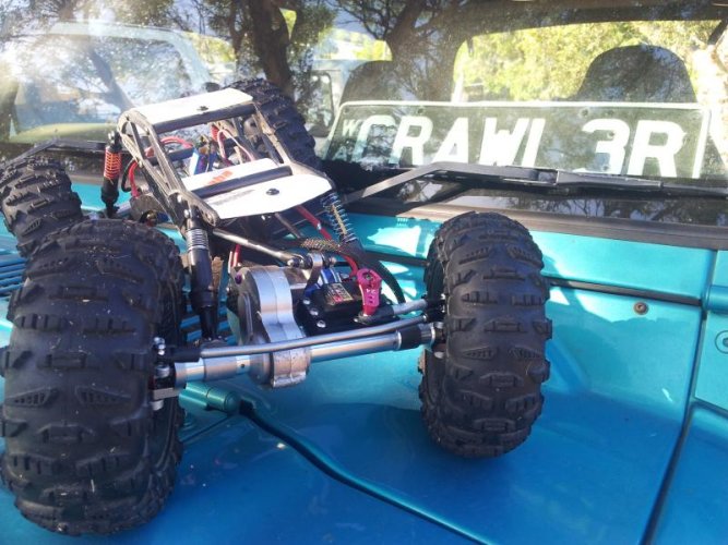

That resulted in this
Bit of bling thanks to Mr KLaBeaume
file.php
Then I decided to do it even more proper like and added
- a set of VP BERG VVD's - pre release units that had a small machining issue I needed to fix up
- VP SLWv2 respun Wheels
- VP Ti Uppers, front and rear.
- D-Lux Knuckle weights.
- CtBM 850m Ah 3s pax.
Now it looks like this....ready for season 2013.

Looks great big brother. Its good to have another rig in the pro ranks this year.
Berg experts if you have some input for this build post up, it would be great to have some experienced help."thumbsup"
With Battery, without knuckel weights, she weighs in at 2125gms, 4lbs 10oz.
No lightweight, but no barge either.
I am investigating RCBros rear tubes and other forms of exercise, but will run it first to get an idea of how it performs before I start boring holes in things."thumbsup"
nice start man . shave those donnas down an you can save alot od weight"thumbsup"
Slowride is right. You can save some weight by shaving the sedona sidewalls. Also makes for better forward grip because the tires can flex more around the rock. You may have to change foams after you shave em depending how much you take off. Sometimes you need too, sometimes the foams you have might work better. Just depends.
Also look into Dlux berg tubes. Super light, slippery, and everything is completely adjustable. Makes things like castor and link spacing way easier when you can choose where the mounts go.
You will love your berg. IMHO, the best rig to build on."thumbsup"
Xr guys might say different but thats just like ford and Chevy, and this is the Berg forum. :mrgreen:

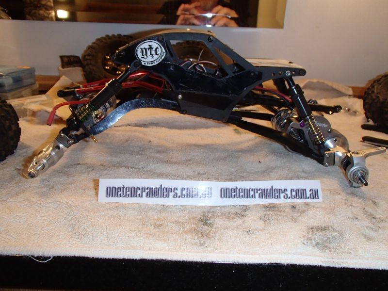

Crawlers, I give you the Hulksta 'Un-Named' CF Berg set and forget Chassis.....
file.php
The build list you see before you is thus:
Front Axle
Vanquish VVD's
VP High clearance Knuckles
Delux Knuckle weights
VP Ti steering and drag links.
Hulksta milled axles and Servo slot/mount/screws
Hitec 7950 Servo @7v
14T Pinion
LaBeume CF Cover
Chassis
the "Un-Named" CF Hulksta Set and Forget Berg Chassis - just frickin' gorgeous
Hulksta bent TI Upper and lower links all round.
Clear skins
Rear Axle
Hulksta 6mm TI rear axles, modded lockouts
Milled housings
RCBros Rear Upper Link Mount
16T Pinion
LaBeume CF Cover
Electronics
35T Blitz Hand wound motors
Hulksta Smashed HH Br Minis with CC BEC @7v
2104GF Rx w/- 4PL
7950 Servo
Wheels
Shaved Sedonas mounted to Beau-Spun and slotted VP SLW V2's (Hulksta didn't do these)
CI 5.25 Narrow Softs front, Narrow Mediums rear
725 hubs up front, 225s on the rear
Lovin' drivin' this rig!
