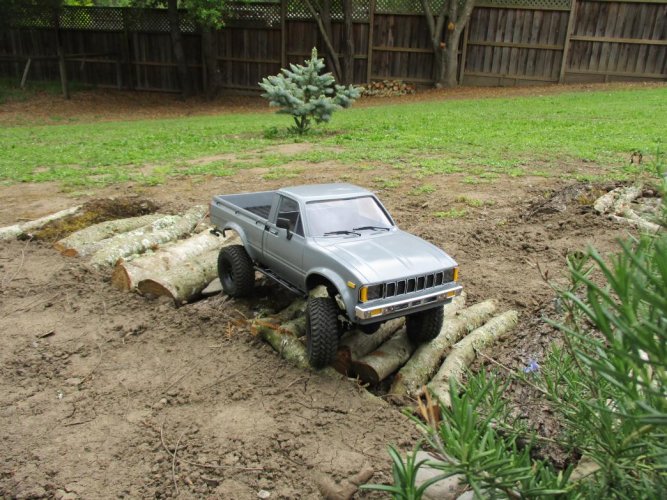

Welcome RW413, bensters response is pretty spot on IMHO. I have had 3 different TFs over the years and liked all of them but never gave them a chance the show what they can do with just a little work. If the Marlin was offered as a kit I would have gotten one but got a TF2/Mojave kit. And now thinking back I should have just purchased the Marlin:mrgreen:. The LWB RTR will probably be a great way to start out in this hobby, I really like the looks of that body too. Lastest TF2 for me.

Edit: Bill, wassup? Great to see you jumping in here too, nice Yota! :)
