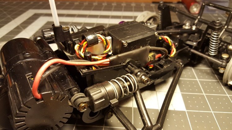

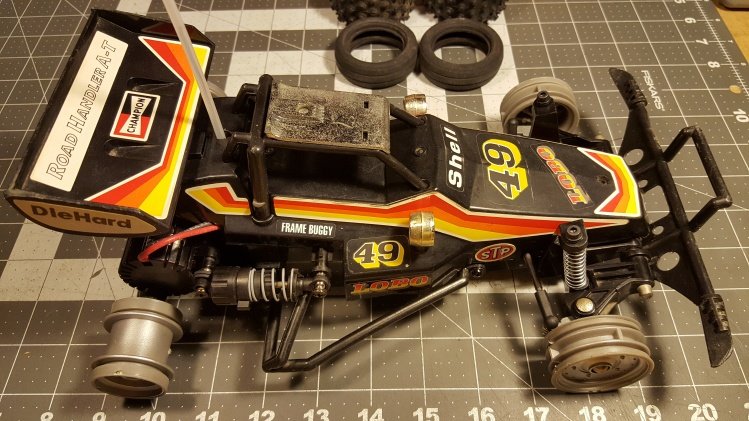

I've been on a nostalgia kick for awhile. It start with converting original Tonka trucks to be rc. My wife and kids got me the re-release of the Tamiya Hornet, my very first hobby grade rc. I also got a re-release of the Tamiya Boomerang, my first 4wd buggy.

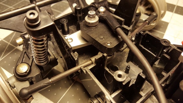

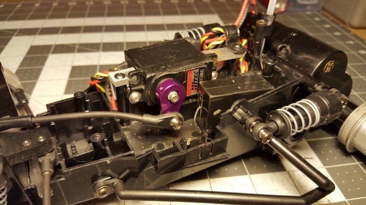

Well, a couple moths back I was on eBay when I saw the first rc I every had, a Sears Lobo. I decided I had to have one. I bought one in good condition and it was still in working order. But, like any builder here, I needed to make changes. Two major changes: the electronics and the suspension. For the electronics I wanted proportional steering and throttle. In went a full sized servo, a Holmes mini br esc and new motor (sport tuned Tamiya 380). The suspension as more of a tuning. Actual dampeners on the rear and softer springs up front.

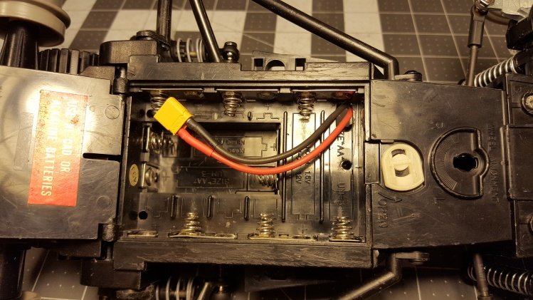

One primary goal was to set it up such the if I ever wanted to convert back to the original equipment I could. So the only permanent change was to drill out a hole into the battery compartment to plug in a Lipo.
I have the original tires that are in pretty good condition but I order up some different tires to run with. Still waiting on those to arrive. Once I get them I'll do some videos.
Here are some pics of how it came out
