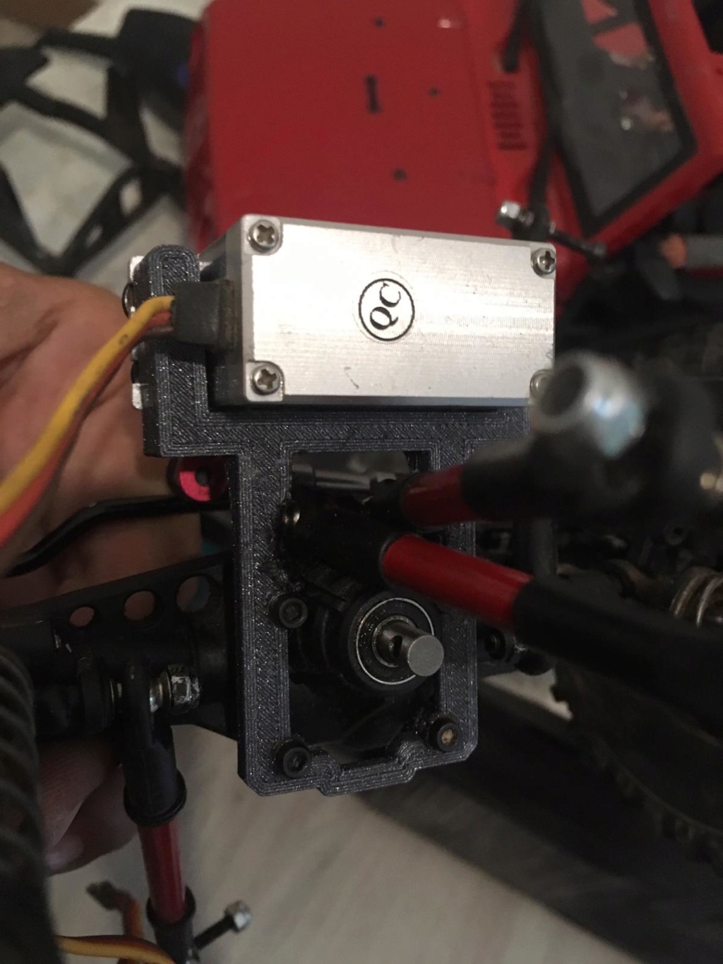

As the servo will go on the axle, a 3D support with reinforced material although one day a metal from China will arrive .... I ordered the metal by recommendation, but for now the 3D one holds

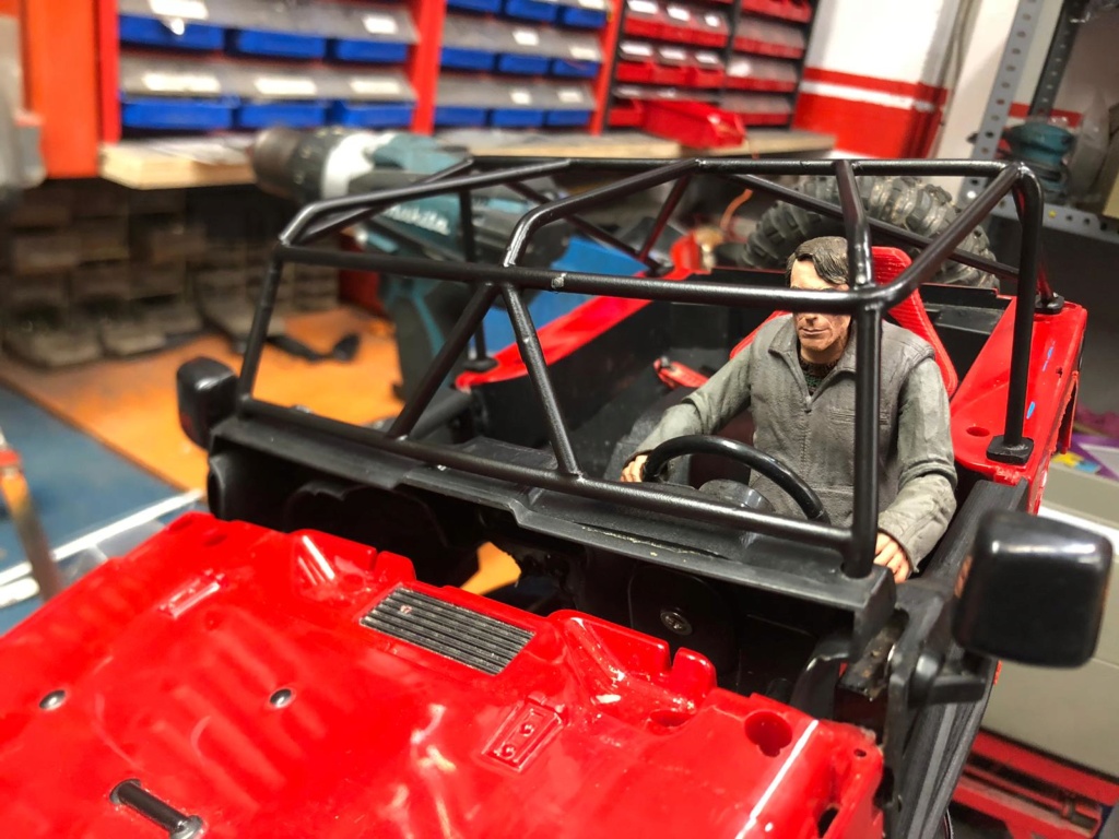

Here the work of bars, which corresponds to me to thank fellow Asitreck de Amurrio, he is the artist:

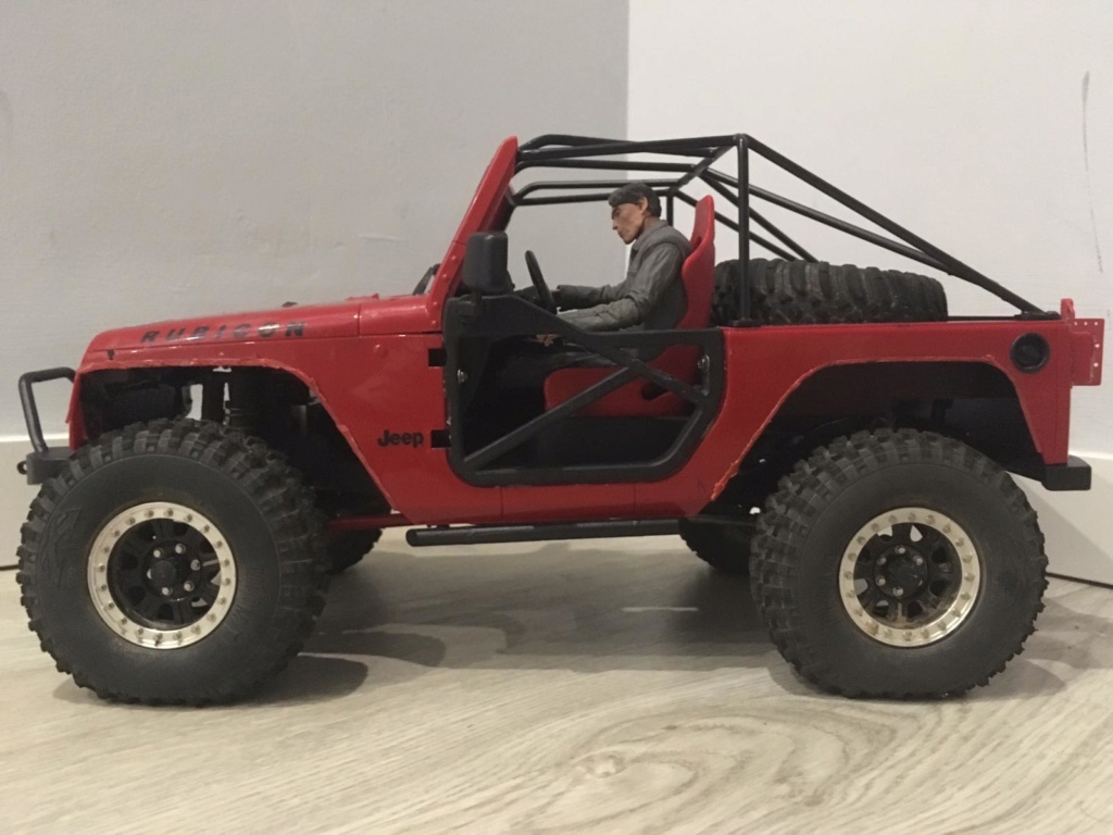

Some photos of the set, fins and details need to be outlined but it looks more less hehehe
This work took many hours, it seems simple, but it costs its own, although it is worth covering those gaps, it gives a lot of realism when using it in the bush:

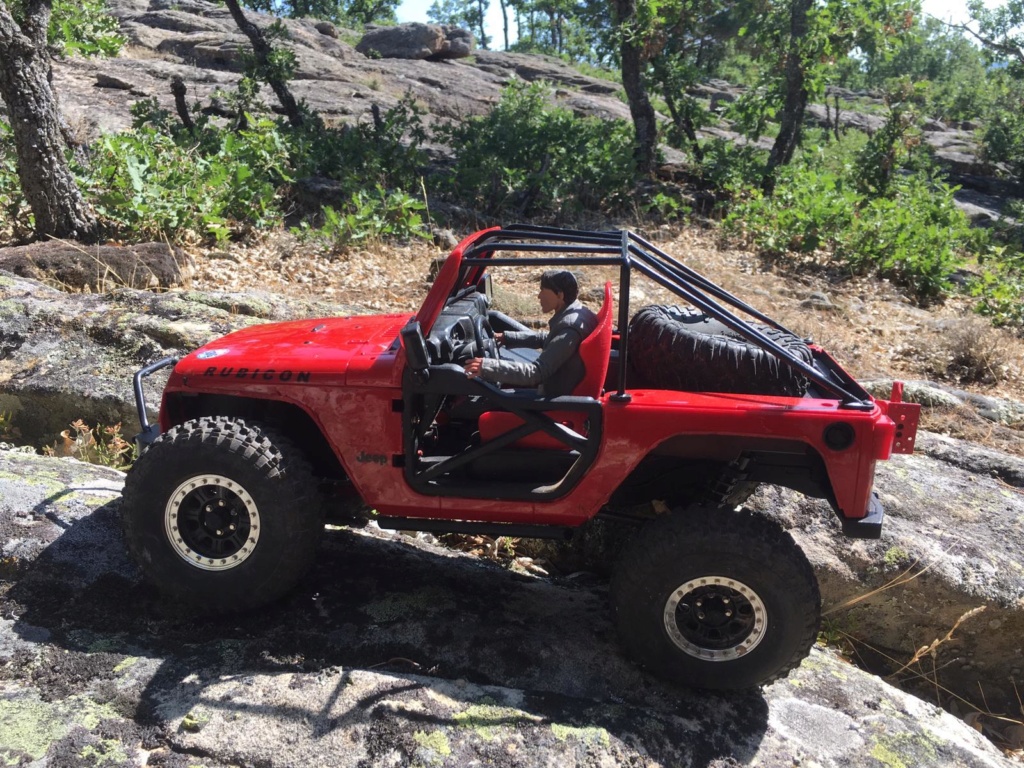

A few photos proving it in Soria (Spain), touch shorter rear shock absorbers and finish profiling fins, the rest is perfect:
