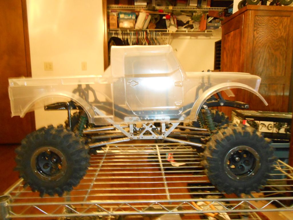

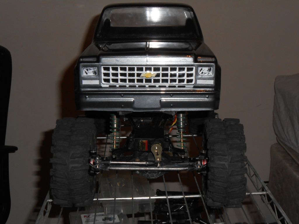

With all the rain ive been getting in my area i decided i needed a new mud truck. Ever since i saw rcbros burly mud truck conversion i knew it would be my next mud truck project. I haven't decided on a body yet so a honcho will be used for mock up.
http://s260.photobucket.com/user/highlift2319/media/DSCN0181_zpsjwm6er27.jpg.html

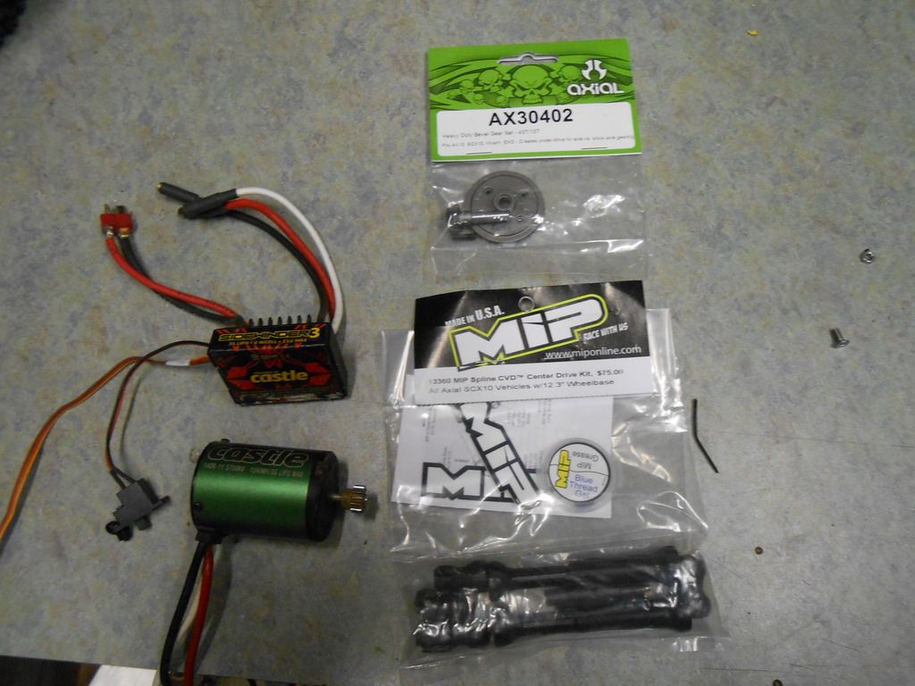

Since ive got a thing for jeeps i got the nukizer jeep body. Also some drive shafts and under drive gears. I plan to have this drivable this weekend.
Thanks for looking.

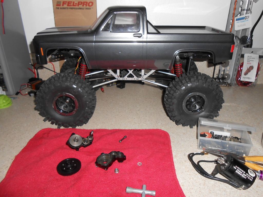

Got a new body :mrgreen: Also electronics are in. I decided to go with a Holmes water proof 3300kv system on 3s. All thats left is final mounting of body and esc, smaller spur gear. Thanks for looking.

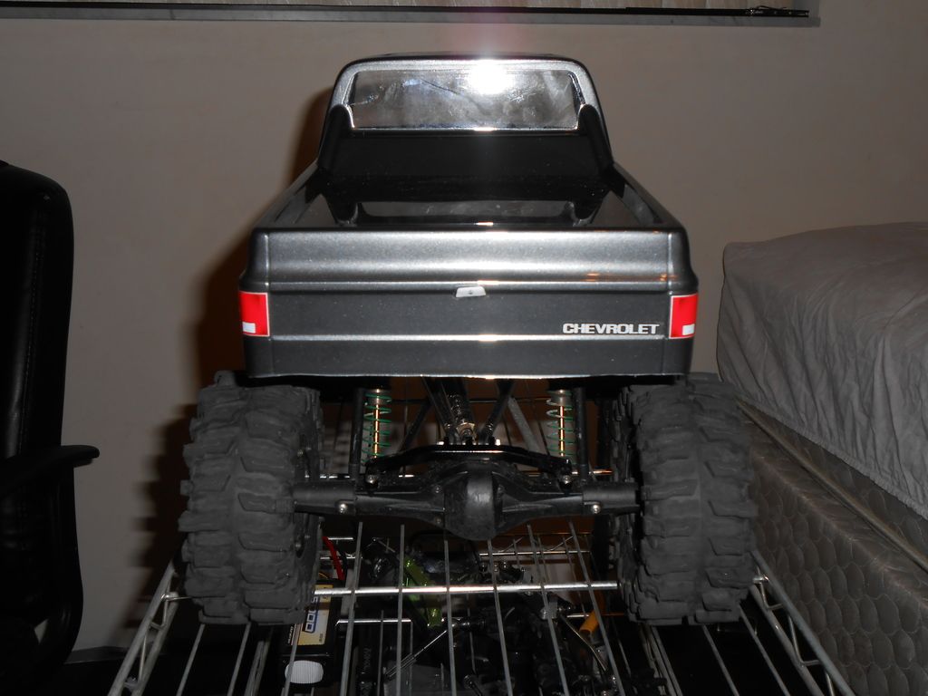

Havent got in the mud yet, its coming. I went this route for performance and simplicity. I highly recommend a sway bar in the rear and the battery mounted across the frame rails behind the front shock tower. Testing in the front yard with the setup i mentioned allows me to make controllable full throttle take offs with out lifting the front end. Thanks again for looking.

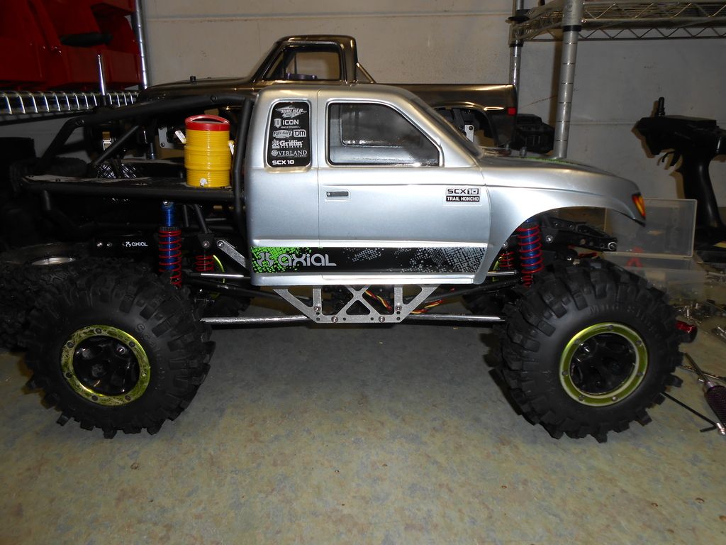

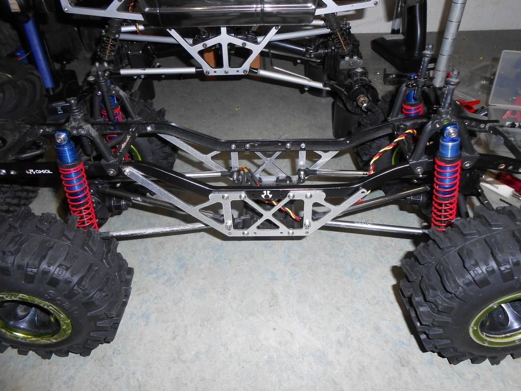

I decided to bring this truck back and completely rebuild it. After killing the motor and ring and pinions, i decided to build new scx10 axles with XR wide beef tubes. Also im changing the body to the tfl racing bronco since i couldnt sell it.
For now im in the mock up phase. Im thinking of going with a 13in wb. Thanks for looking. Oh and i got these tire at todays comp and swap, doese any one know anything about these tires? Ive seen them before thanks
