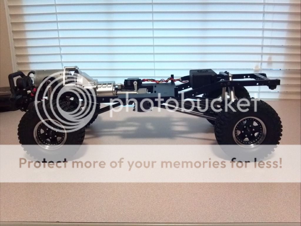

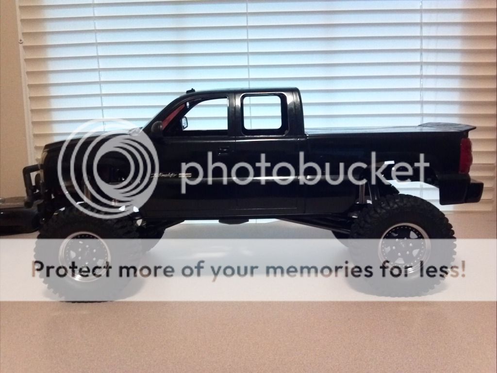

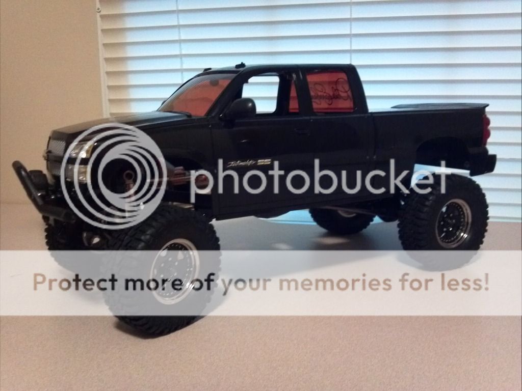

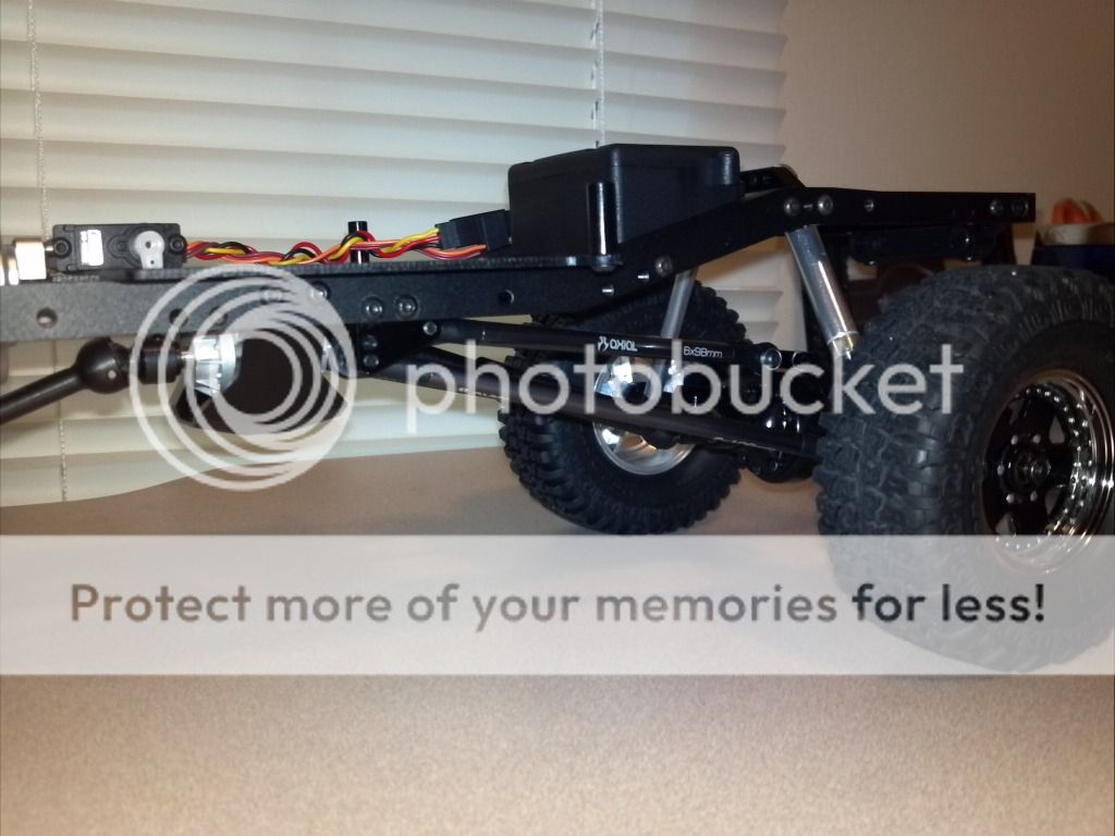

I just got started but I couldn't wait to pics some pics so here they are. I'd like to hide the battery in the bed and I'm stuck trying to decide whether to do a bed drop and build a tool box for the battery or do a tonneau cover or maybe even a bed topper. Can't decide on a color yet either. Anyone got an opinion on this? This weekend I plan to get the body mounted, fab some wheel wells, flip the shackles/mounts, chino the front leafs and play with some different springs for the front shocks to try and soft the suspension up a little. Here is the part list so far. It's nothing fancy but I think it will perform fairly well and make for a good looking scaler. I remember reading somewhere about how to remove the red tint & Earnhardt logo from the windshield. I did a couple but searches but came up with nothing. anyone else remember this?
Silverado SS body
4-linked rear w/Axial 106mm lowers 98mm uppers (12.2" wb)
RC4wd XVD's & rubber sealed blue bearings
JunFac Universals (95-140mm front & 107-142mm rear)
Hitec HS-985mg (steering)
Corona DS-339mg mini servo (shifter)
HH-35t handwaound (540 can for mock)
Rooster Crawler ESC
Yeah Racing head, brake & signal light kit
Cougar PS3i 3ch radio
Associated TRS401-ss receiver
Old HPI bumper for mock
Tony's Screws hardware

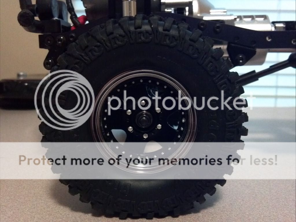

Man you sure have some really still hands to paint up those Pajero wheels! They look great!
Ah...something different, I'd leave it black
Sure wish there were other options for 1.55 wheels besides steelies and the other 1.55's in the RC4wd stable. Wheels look great...."thumbsup"
Yeah, the white 1.55 steelies that came with the kit just didn't looking right with this body. I could paint them black of course but I figured that was too much because you couldn't tell what kind of wheel it was then. That's why I detailed the Tamiya wheels to make them stand out better.
It's almost there. I've gotta get a set of better shocks. Now that it's 4-linked the stock rear springs are just too soft. I haven't run it other than just setting the trims up so i don't have any videos yet but I'll post some more pics today.
Hey kills have you got your truck finished yet, would love to see some more pics and videos!
