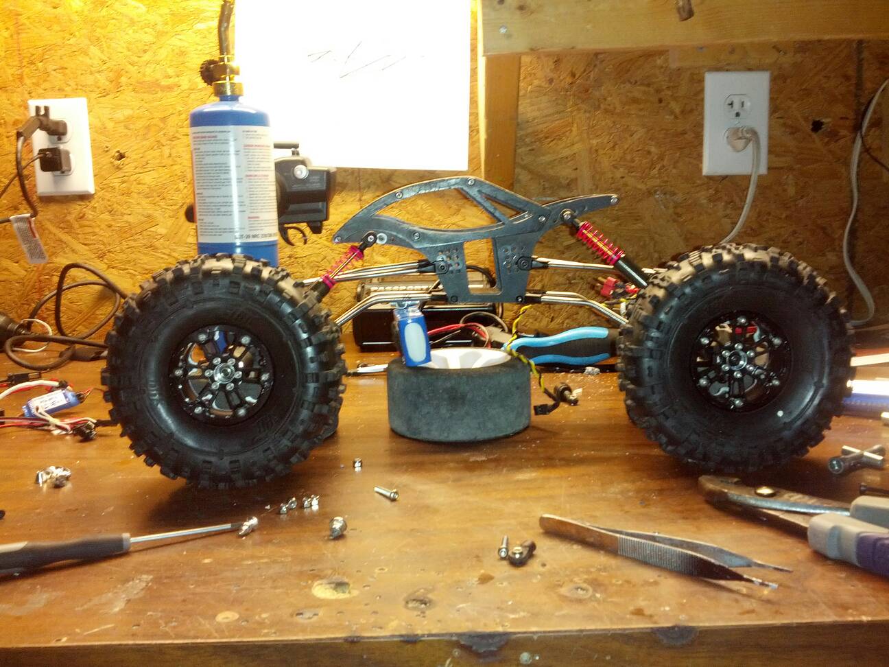

So after all this I just wasn't satisfied with my chassis or the rig break over. So I went on a hunt for a cheap chassis. I came across a Viper II and for some reason really liked the look. So after about a week and a half of talking to the RCC member, he decided to help me out and meet in the middle on the price. The chassis was flawless when I received it minus a few skid scratches. I have a practice course I built in my basement and after running the viper II on it I am in love with its break over as compared to my bjv4 chassis
For shocks I went with inverted traxxas big bores with mini t springs. I like this setup a lot. I am just having problems with shock oil setup. Its either to thin and causes massive axle hop and rollovers or to thick and my rig out runs the shock on obstacles.

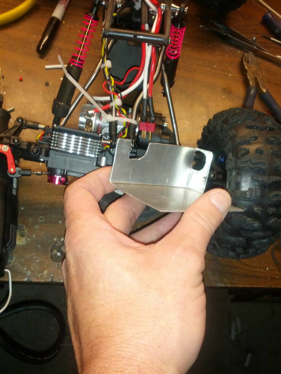

I decided to try and lower the weight a little, so I removed my homemade servo armor, trimmed wires down to only what is needed and removed my wheels to drill them.
Not the difference I was looking for but it adds up. After five or six practice runs I decided to sipe my rovers as I have read it help out a lot. And I agree after siping the tires and adding a soft tuning ring in the front, it is much better on steep or sharp angled approaches. Here is how its sits for now. Waiting on some Custom Fiber pieces, and saving for some Holmes Hobbies motors.
