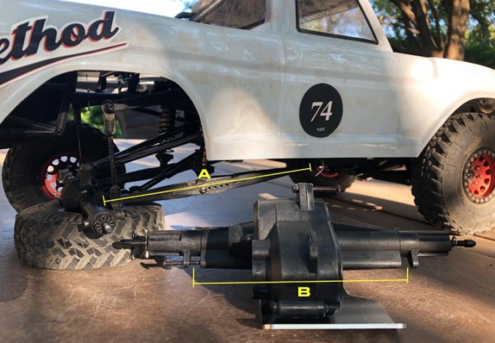

I will follow you if you answer my question as follows: how wide are the rear a-arm mounts on the original MOA axle?
Sent from my SM-J337T using Tapatalk
Not sure what you mean. The MOA axle has no "A"-arms - it's solid axle. Do you mean the trailing arms that hold the axle in place? Here is a pic of it.
A= 165 mm (6.5")
B= 140 mm (5")

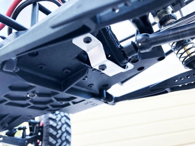

Not sure if I posted this one? You can kind of see how the scx10 II kit trans is hanging down from the hole I cut into the chassis:
You will like it :-) I used a Yunfac shaft I had laying around. The way I installed the trans I needed a shaft length for a distance of 95mm minimum and 105mm extended - I think mine came off of a Gmade Sawback.
I originally had a yeti trans in mind too but don't remember why I didn't follow through with it. I think it was too big for the available space.
Thanks for the info! I did see the bracket earlier. I've been sketching up a couple of designs that are more protective, kind of like a skid plate/trans mount, that will align it in the same spot.
