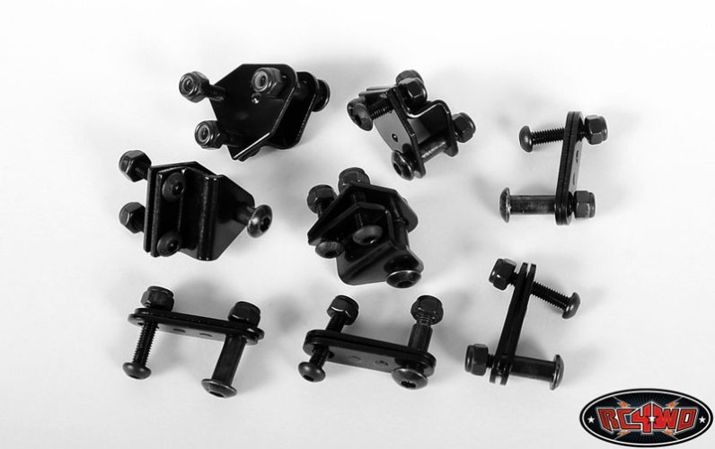

Will the Leaf Spring Shackles and Mounts Work on the Axila SCX10 Chassis?

I've been looking at those too, I'm sure you could get them to work. I'm most likely going to make up my own parts and then use Yota axles."thumbsup"
Not sure about those, but you should get the Rcbro's scx10 leafspring kit.
Well you will have to get it from someone on the board, I don't think he's going to make those kits anymore due the slow sales from the last batch. Too bad, I would have bought a kit to save myself some work.:mrgreen:
I've got that kit on my scx with yota axles.
I had to drill a hole in the rails to mount the rear mounts.
The fronts fit with a spacer on the inside and outside of the chassis rails to center them.
I also got the gcm kit to move the springs in line with my chassis rails
because the rc4wd axles mounts are a little wider.
