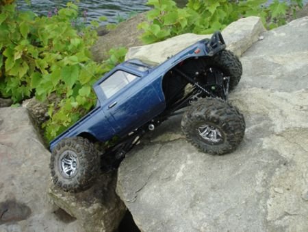

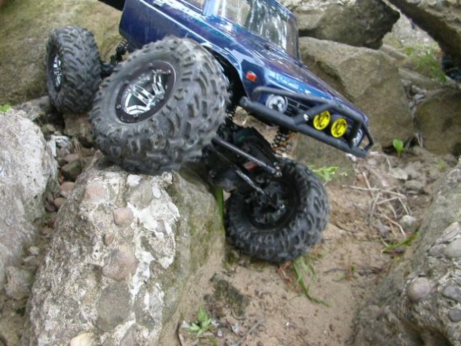

went crawling today over at the LHS, heres the pics of my WK with the rock lizards, and the headlight system I installed... may have to post some night pics to show them off.. LOL

I just eliminated the stock rear stearing lockout, I flipped the steering knuckles inboard and installed a pair of "Rustler" Toe Links, I used the screw hole in the rear link setup as the tie in point, (the lower of the two center holes)... Now I no longer have to deal with one of the rear wheels "steering" itself and making the stock brace fold when it encounters an oddly angled rock or surface.
I dont think the stock one would have broken but the flexing of it was a royal pain.
