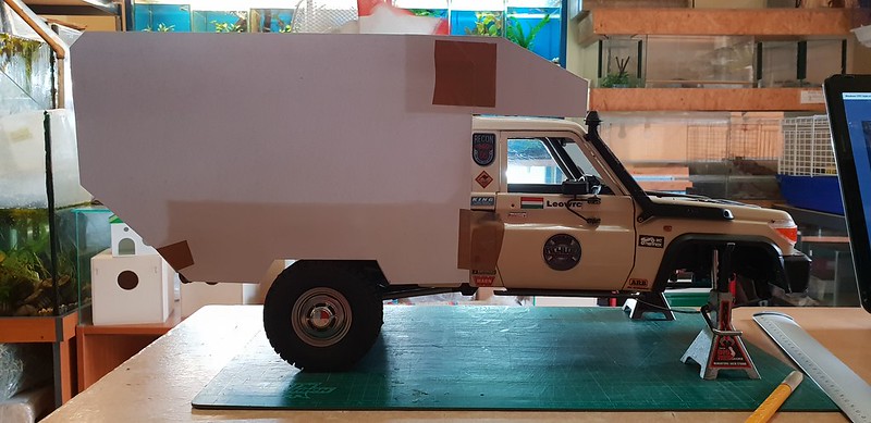

The plan is something like that.

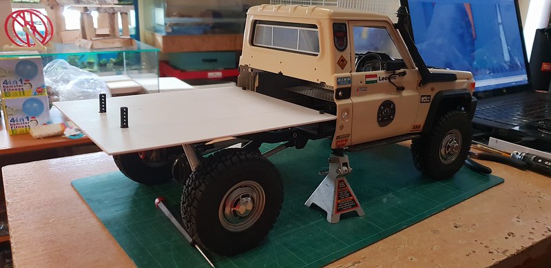

The first test, even paper.​

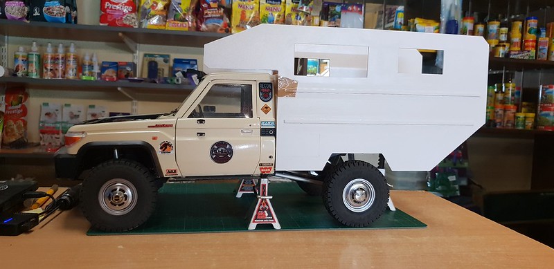

The floor plate of the dwelling:​

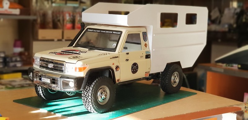

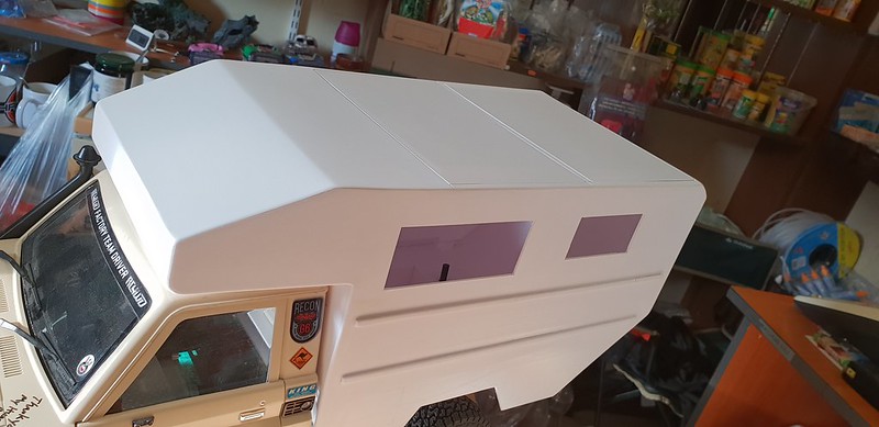

These are the final side panels.​

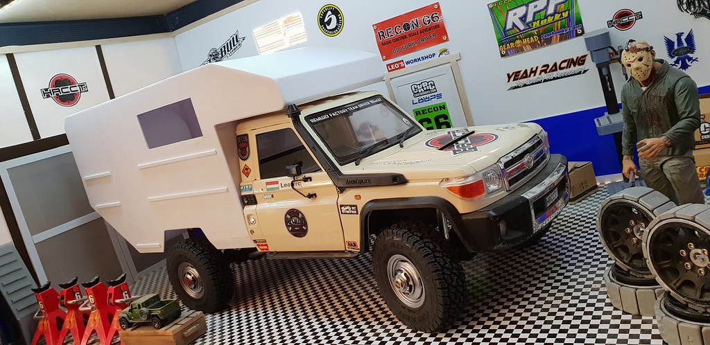

One of the important details.​

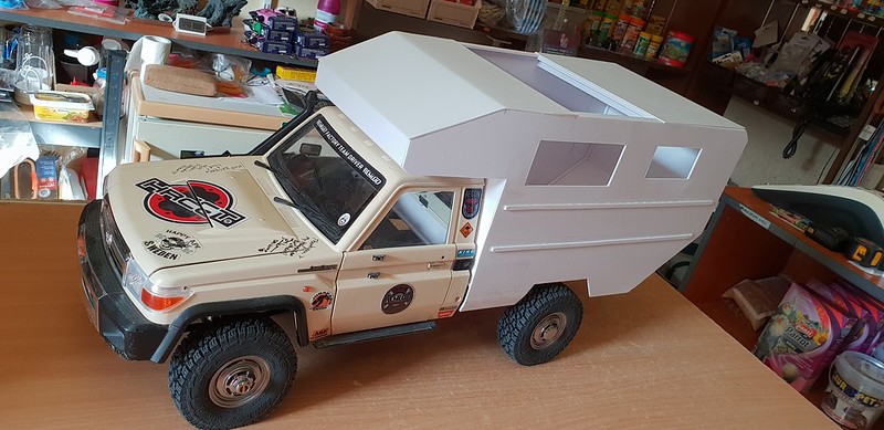

A little posing.​

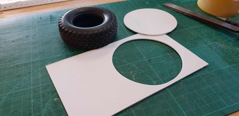

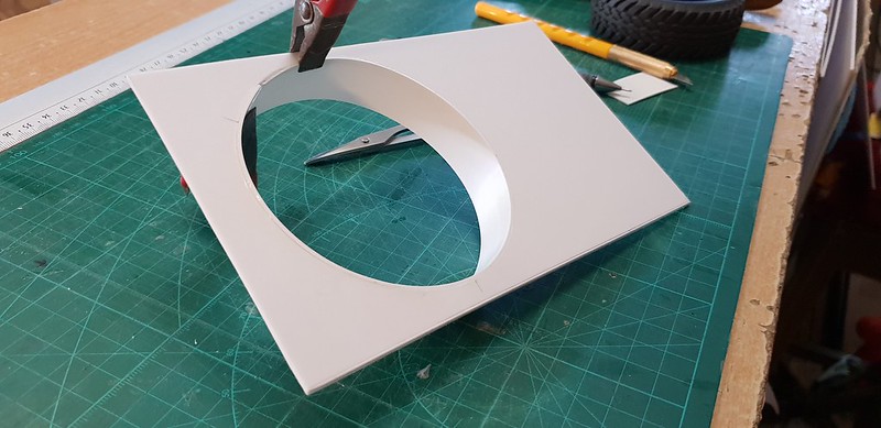

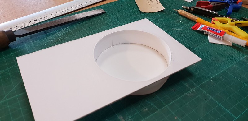

The next step was to build a spare wheel's recessed mount.​
To be continued.....
