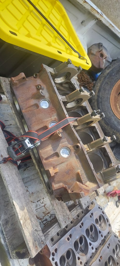

Got some good news yall! Went to the machine shop n picked up the block, crank, new pistons, n old heads. Im pretty excited, ready to get back on this build. If yall are close to northeast AL n lookin for a good machine shop, i recommend t a's automotive machine shop in piedmont.
Block was bored 0.030, they put the cam bearings in n the freeze/casting plugs in, which i wasnt expectin. They ended up turnin the crank 0.010, even though i couldve got away with stock, tj said id be better off doin it right the first time.
I had them pull my old pistons off the rods n put the new ones one. He checked the heads, n unfortunantly, one is cracked between the valves. So im searchin for a set of 351w heads or a set of 5.0 explorer heads. If i buy aftermarket, ill go aluminum, with 2.02 1.60 valves n roller rockers.

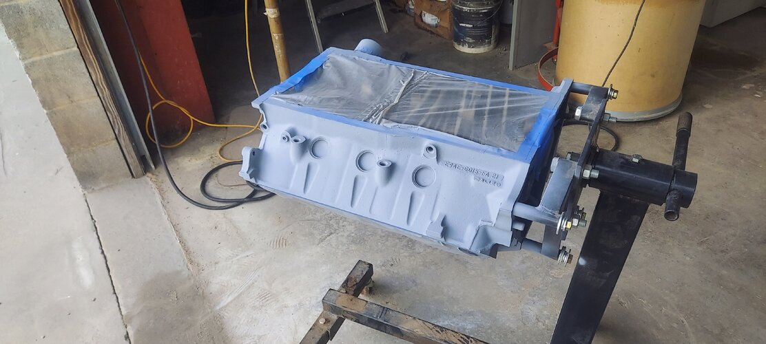

Howdy howdy yall, got a lil update. Finally got started on lil b's new heart. I went over it with a wire wheel n some small wire brushes for the tight places.
After gettin the block all blown off, wiped down, n taped up. I shot some primer to it. Went with 2 coats of primer, just to be sure i got a good cover. All the paint, primer, n clear i used is duplicolor, so i knew there wouldnt be any issues. Been there, done that....
After the primer dried a bit, i got started on the paint itself. I wanted to go purple, but the local parts stores didnt have purple, n i wasnt goin to town to get it lol. I know, i know, lazy bum 🤣 So i went with a med to light shade of ford blue. For good measure, i shot 3 coats about 10-15 min apart. Really like how well it done. Sure will look good with all the aluminum parts on it.

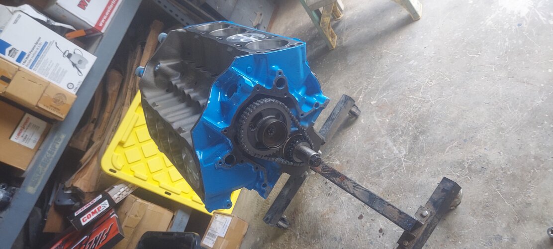

While i let the blue dry a bit, i started gettin stuff layed out for assymbly. Hit it with 3 coats of clear, for a lil protection of the paint. On to puttin rings on the pistons. Wasnt to bad, for doin it by hand.

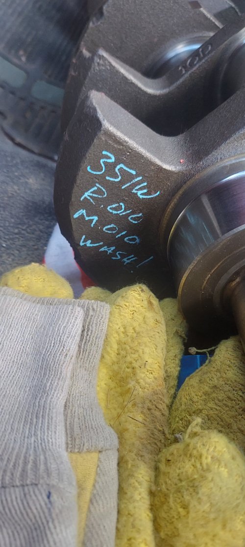

Well, lets see wat we can get done next 🤷‍♂️ Not near as much as i had planned, let me tell u smh. Got the new cam all lubed up n slid in, torqued down the cam retainin plate to 12 ft lbs. Went to start puttin main bearings in, n heres the stoppin point, ugh. I ordered the wrong friggin bearings 🤦‍♂️ These are for a 289/302, not a 351w. So i called up the parts store in our lil town n she has stock size bearings, but i need them .010 bigger. So theyre supposed to order them mon, n should be here wed.
Hopefully we get them wed n can atleast get the bottom end done. Ive got a guy that has good aluminum heads come thru a couple times a month, so hes goina hook me up with a pair. Ill post another update soon.

I ordered new rod n main bearings n didnt realize they were for w 289/302, not 351w. So i ordered another set, the correct ones this time lol. Sunday, i was workin on gettin the front bedroom ready for my daughter to move in, n come across a set of 351w bearings i forgot i had. Just so happens, they were .010, which is wat i needed. Kinda aggrevatin. So yesterday, i got the mains n crank mounted up. Was goina start on the pistons, so i got the crank bolt, but it wouldnt thread in. I tryed for a good 5 min, with no luck. This mornin, i thought about it, n used a tap to chase the threads. Ill b dipped, bolt went right in smh.

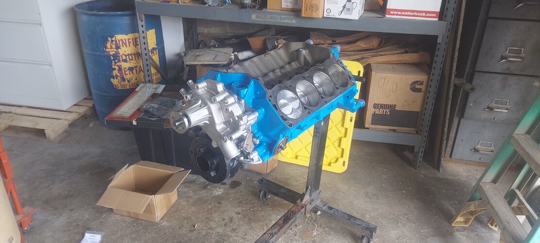

So today, i got the pistons in, everything turns so smooth. Thru the double roller timing chain on, followed by the timing cover. I bought a stainless hardware kit from alloy bolts, which seem to be pretty good hardware. But, theyre a bit short on bolts here n there, ive had to use a couple of the stock bolts in the timing cover n water pump. Not a big deal, but i was hoping to have all matchin hardware.
After i got the cover n water pump on, i shot a couple coats of clear over them. Really love how its lookin. Waitin on a set of heads to come available thru a guy. Cant wait to hear it fire up! Waitin on a new pickup tube n have to finish cleanin the oil pan, then i can finish up the bottom end.
