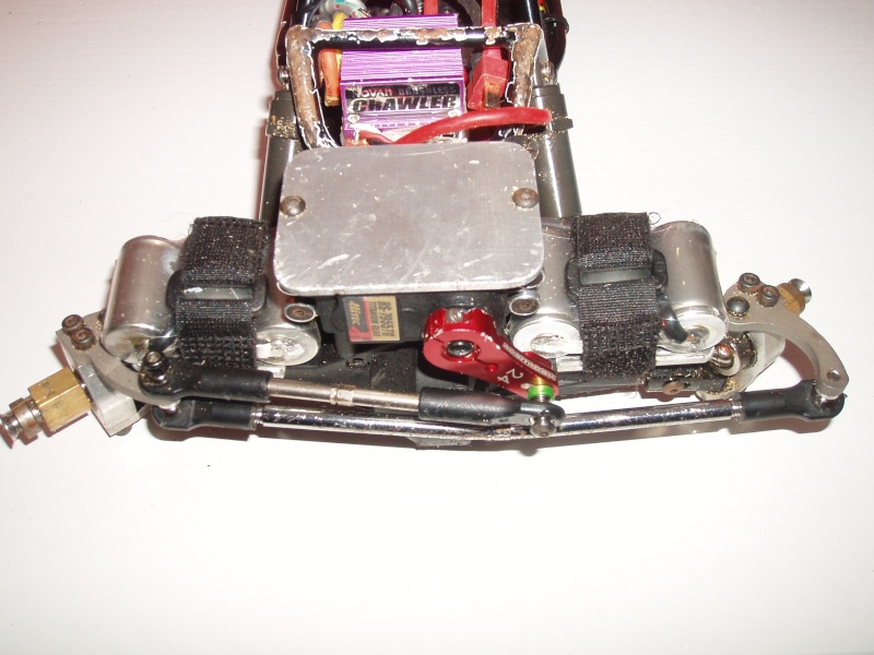

I'm considering an AX10, and I wonder if anyone could tell me what would be best of a lipo (1450 2S) on the axle or a split-pack (6c 1500 2/3A) on the axle? For the lipo I need to move the servo to the left of the car, but with the split-pack I guess I can use the stock servomount?
I would go with the Lipo if you have a charger that can handle that battery chemsitry. However, I would bump up to a 3S if your ESC is good with that voltage. I have good luck with the Zippy 1500mAh 3S packs from Hobby City. They are a good price and fit nicely on the front axle:

Maxamps site has a lipo saddle pack you can check out, if you already bought the axel mounts the lipo saddle might be a good choice. Ive been looking to upgrade to lipo myself, still looking for a decent charger for a decent price.

If you're looking to get by for relatively cheap you can always get a dc only charger for about 50 bucks from Dynamite, then get a separate balancer like a Blinky or Common Sense makes one I think for about 25 or 30 bucks. A little cheaper than something like a Hyperion, but more limited as it'd only be good for lipo charging/balancing.
