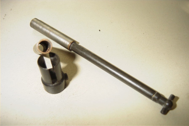

what you guys got?
I know of the RC4WD ... are they good, do they hold up?
I have smoked the stock R&P with JB Weld .... and even tried the gear placement trick... still keeps coming unlocked
Thanks
or
http://www.rcalloys.com/pricelist/txtspool.html
or 4:1 with hardened steel spool :lol:
or if you like the stock 2:1 axle ratio
remove the inner bevel gears
drill out the lower gear and diff cup to 8mm
glue the spool in with Loctite 648 ;-)
