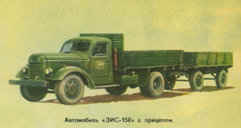

They seemed really tall to go 5th wheel and make a trailer using tamiya semi parts, plus wouldn't pintle be closer to realistic for them?

Either or is prototypical. Russia sold them as tractor trailer units under the ZiS 120N moniker, as well as the version depicted in our kit as ZiS 150. Really, they used these things for just about everything, I can find images of them hauling logs, of three axle versions, found some towing artillery pieces, half track versions, mobile cranes, hell I've found several images of the cab of one of these things transposed onto a light tank hull to make a fully tracked vehicle. I've pretty much got a blank check in that regard, anything I can think of would work.
And, indeed, if I did put a fifth wheel on it, my trailers would be designed for that height. I'm scratchbuilding no matter what, due to the exhorbitant cost of ready made trailer kits. I can get a 12 foot stick of steel c-channel in the right size for about 40 bucks, more than enough to make a trailer(Really a couple of trailers, these never pulled 53 footers), I can get used Tamiya trailer axles for a pittance on eBay, leaf springs...yah, shouldn't be that pricey to scratchbuild trailers compared to buying readymade.
However, I'm probably gonna leave the box on it and go with a pintle hook. Found this on Shapeways and, coupled with who I'm gonna have in the cab(Gordon Freeman will be driving, Duke Nukem riding shotgun), I felt that would be a perfect thing to put in the bed. They also have plenty of spare ammo crates to put in there as well. It's pricey AF so for a while I'll be running the truck empty, but it will look amazing in there, and with that gun in the back I've got no choice but to run pintle hook for trailers.
