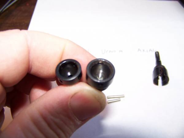

Ok, Seeing as how the cvd's are failing left and right on the new losi I wanted to do a picture comparison with my other 2 rigs to see how they stack up against the losi. What I found shocked me and made me wonder how the losi axle design made it through R&D.
For the record, I do own all 3 of these rigs (although the losi is still in the box because of this cvd fiasco.)
I will walk you through the picture's to point out what I saw as problem area's. I will for the most part compare the venom to the losi because its the only other rig that can turn very sharp and aside from the original issue with the over heat treated stubs the venom has had no drivetrain issues so it can obviously handle the sharp turning without failure.

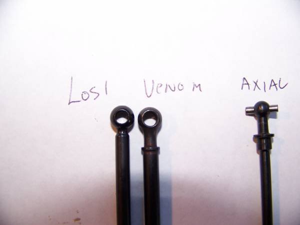

Picture 1
Here is a side by side of all three axles, stubs and pins.

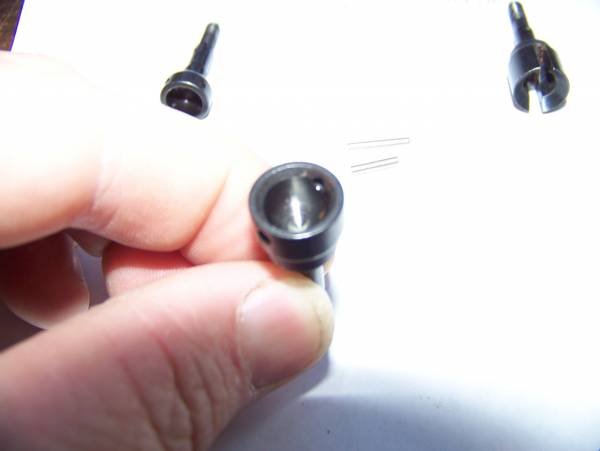

Picture 2
Here is an exploded view of all three, first thing I notice was the losi was considerably smaller than the other two.

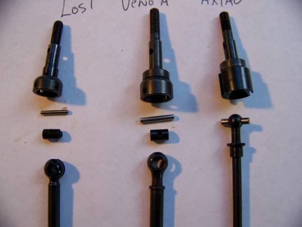

Picture 3
Here you can see the size difference of them, the diameter of the pins in the losi really shocked me ( I read these are the same as the losi 1:18 scale mini crawler) I hope not...they are pretty small though.

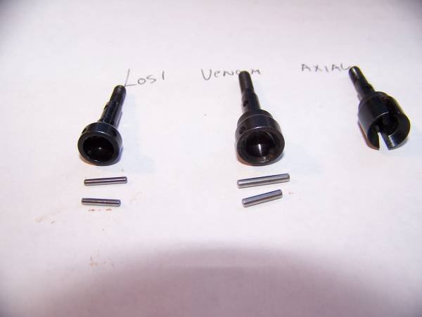

Picture 4
Here you can see that the Venom stub has a beveled inside to accomidate the sharp turning radius without the need to machine down the axle shaft, I think this is where losi made their major design flaw.

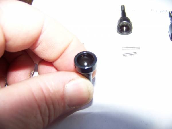

Picture 5
Here is the losi stub, notice no bevel on the inside, there is not much "meat" to these ethier, I was suprised when I looked at it up close.

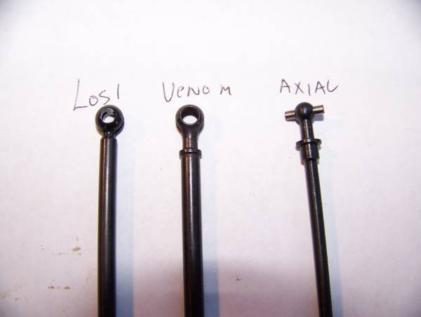

Picture 6
Here are the stubs side by side, the venom clearly is much beefier than the losi.

My thoughts are that once the losi beefs up their shafts they will still have issues with their cups and pins failing, I break a venom axle pin every once and awhile and they are much bigger and stronger, I cannot imagine trying to not break the losi pins, they look like they would fail before the axles would (they should right?) I know I want my pins to fail before I break an axle or something worse. For now I will sit on my losi and see what happens, I am not willing to at this point put any MORE money or faith in this rig.

Seems pretty noticable that the pins are much smaller in the Losi than on the Axial or Venom. The Losi axle looks a little smaller than the Venom, but slightly larger than the Axial. Interesting... I wonder how Rich plans to fix the problems. Thanks for the pictures!

I see trade offs though, the pin is bigger on the venoom but the hole is bigger also so that means the material left for the ball is smaller,,,but it ain't brakin so ,,,,hummm
I don't like the way they necked it down instead of shaving the inside,,,

The CVD design that you have used in the photos i will agree are bad designs. Using a CVD in the type of rigs we have well they don't work at least in the design we have here. In the Axial section there are 100's of post about the pins breaking in their CVDs & i have used those & broken them the problem with the CVDs breaking is the use of the pin, to small of a pin, the pin breaks, to small of the swivel on the axle, it breaks. The problem with the axle with pin going into the slot hub is there is a problem with the forces applied to each other making it hard to slide & they lock up the steering. Also when the pin wears a groove in the hub it really locks in place. The best design os a CVD is MIP's with the bell end on the shaft/axle & the hub having the swivel in it because you can make the stub large. The strongest CVD design that i have seen a LVD & it has a bell on one end but uses a block for a swivel with two pins driving the hub part. These at one time were offered in some on-road rc cars, i'll see if i can dig some up & show a photo of them. I would like to see a driveshaft system like Losi uses on their off-road cars & truck with the star between the axle & hub.

There just isn't enough bulk there to withstand the punishment. Even Lost upgrades the material it still smaller than the Venom's. Design changes will likely mean reduced steering (Key Selling Point)

you could always make your own pins from very high strength steel..thats what I did with the venom pins and the cvds are as good as MIP's from experience this is a fact to me!!! and you can hog out the slot in the shaft and drill a bigger hole in the stub then better steel pins!! not too brittle but not too soft, like a good carbon steel!!
