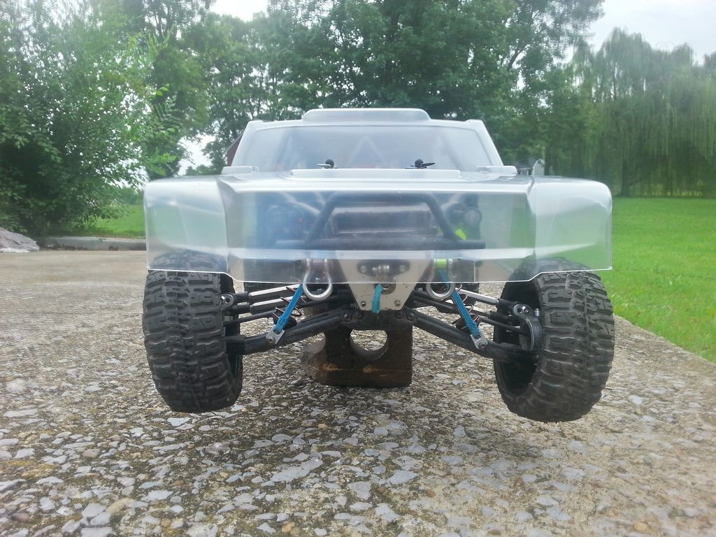

I was most worried about the massive amount of front axle shaft breakages. my rig still
has the rtr dogbones and iver never broken or bent one. limiting straps and 28 positive camber
completely eliminated any binding of the dogbones.

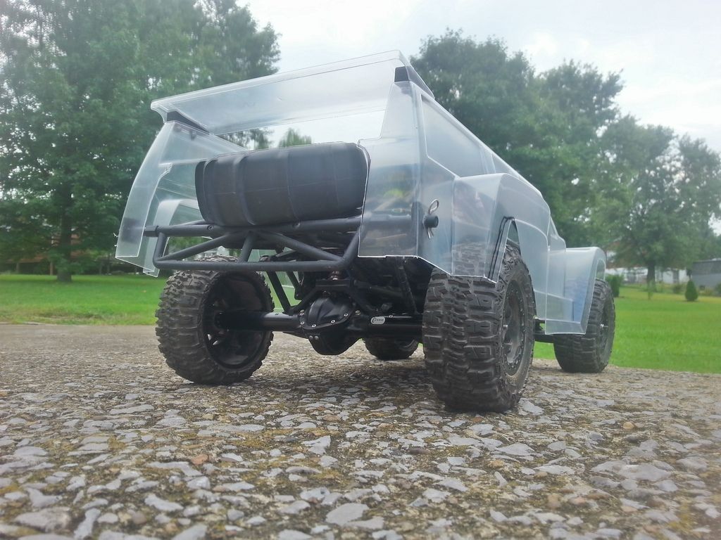

longer than I was patient. the currie axle is ridiculously well made and the rear axle shafts that come
with the centered version are HUGE compared to the stock bits

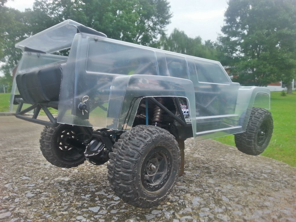

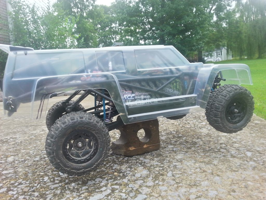

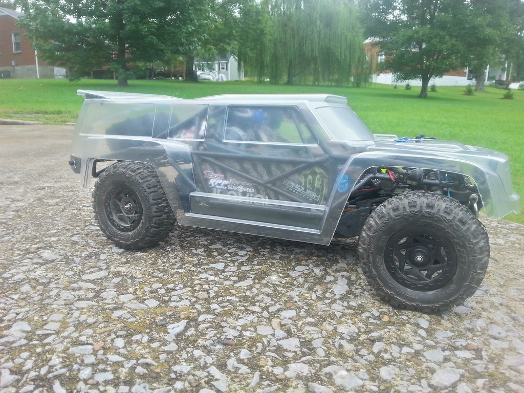

I have been following a few of the yeti-trophy truck builds here and wanted to do something similar, but I needed it to be easily swapped back to full crawler mode so a tires swap, and removing the rear body posts should be all I need to do.
I picked up a set of the vanquish
twin hammers trailing arms and made some custom upper links to shorten the wheelbase by about an inch to better fit short course truck bodies.
this also makes the yeti nearly the same wheelbase as the wraith which definitely helped crawling by being able to break over obsicals easier where the long wheelbase and the
big flat belly pan would have stopped me.
future plans are to get the vanquish sway bar, and a custom front cumper made. I also want to see about getting sharper turn radius. there's a few threads about steering and they all just reccomend
upgrading the stock parts. great for durability and tolerances but none of the options i've seen ACTUALLY improve steering.
I had originally got the jconcepts bajr body but it wouldn't fit over the upper cage. fits great if you were to run without the cage. if anyone wants it
my LHS just happened to have the traxxas dakar body in stock so I snagged it rather than waiting for the proline bronco sct to arrive.

trophy conversion uses a traxxas Dakar body

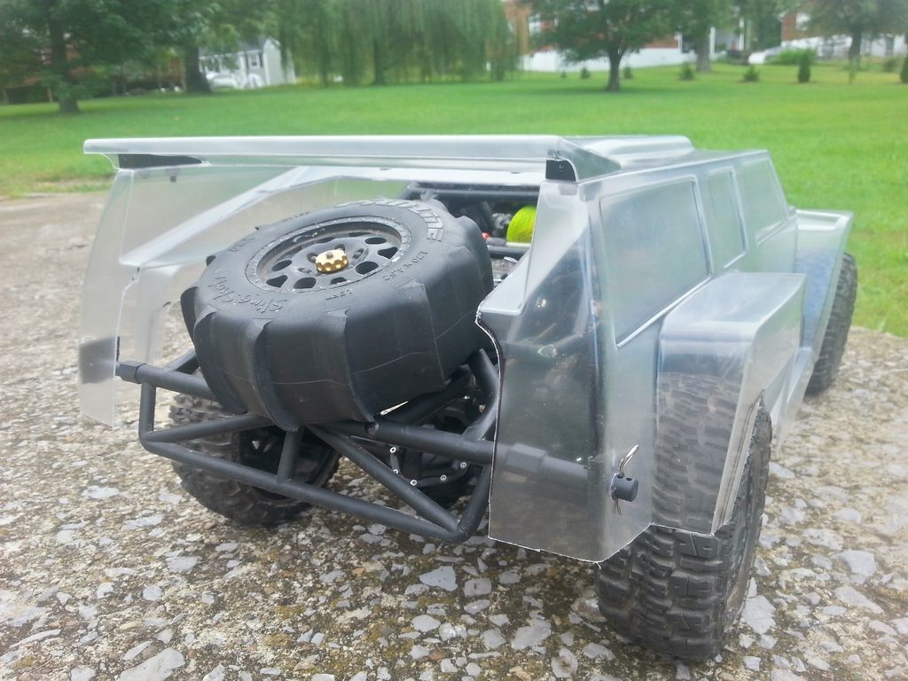

AKA cyclone (walker evans) wheels slash 4x4 rear, losi scte front
proline trencher sct with closed cell foams
slash 2wd rear bumper
