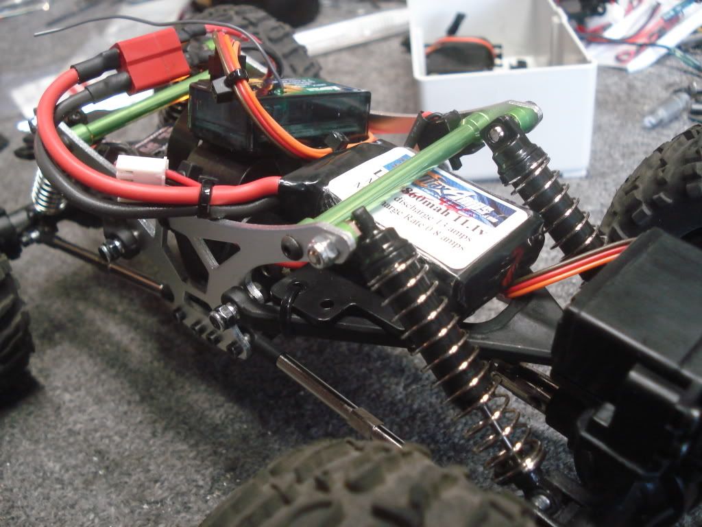

-I mounted the Rx on the trans and the batt and ESC on TLT servo plates zip-tied to the upper three link.
Little Li-Po fits perfect inbetween the shocks:

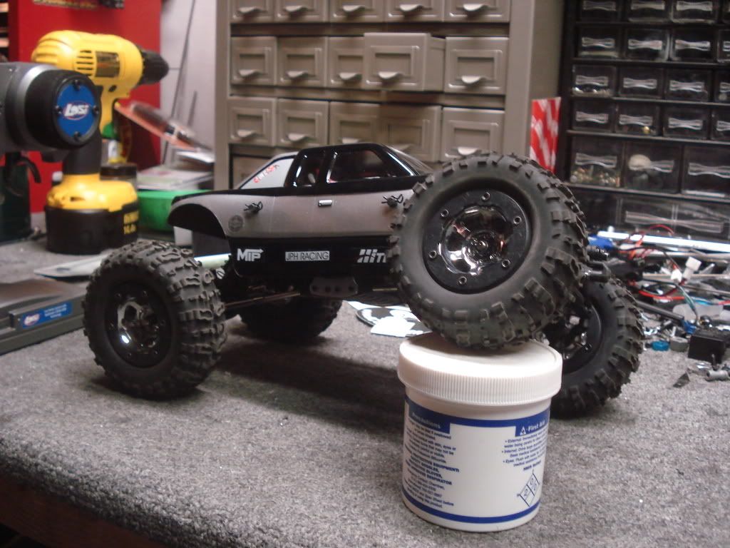

Sits lower for better CofG but hurts break-over angle abit:
I also added more weight to the wheels so now I have 1oz in ech front and 3/4oz in each rear. I also got a new body coming in the mail that I'll mount that up in a couple days.

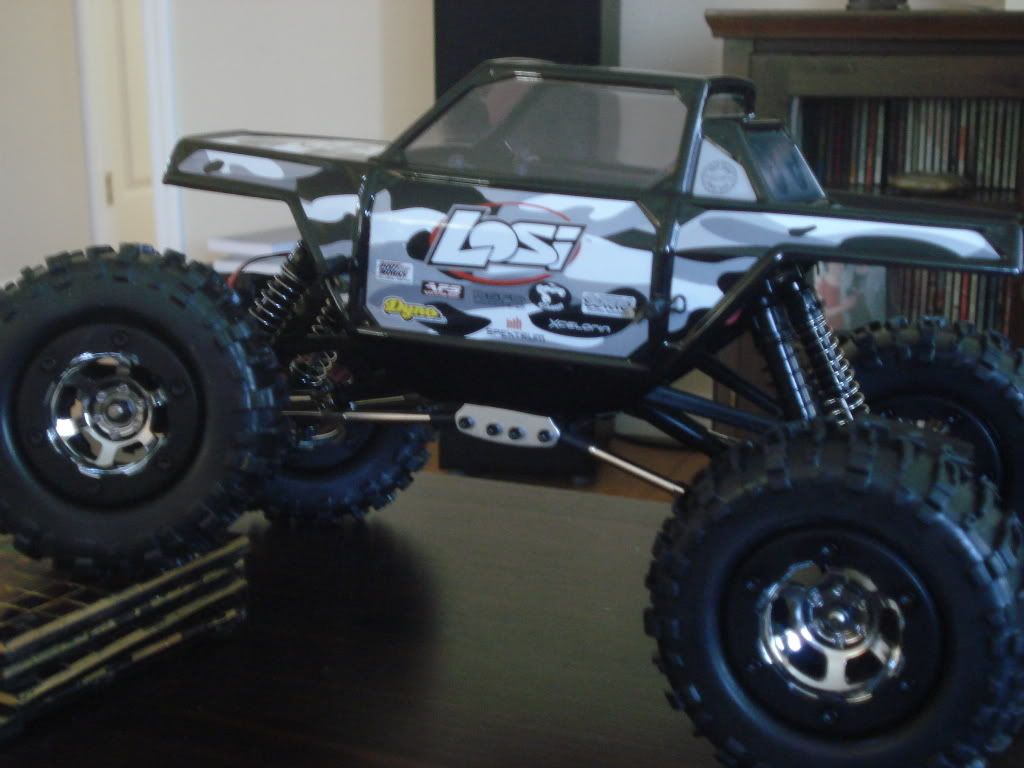

The internal springs helped lower the stance a bit more
flex:
torque twist is gone and suspension seems to works well, I will give it a run tomarrow

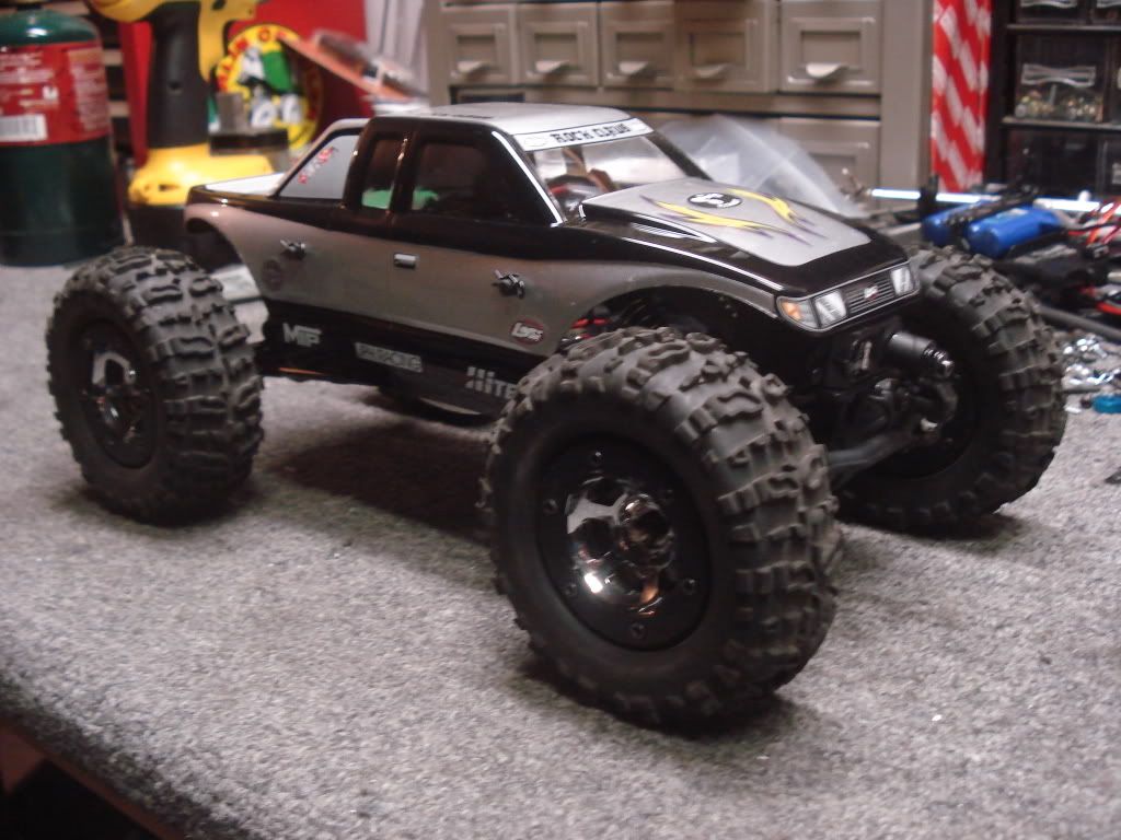

Been doing a ton of work on this little rig, funny casue I thought a smaller rig would mean less work...
Anyway, got a HH Mini-TorqueMaster, nice little motor, I like the integrated PCB with caps, smooth startup and has plenty of torque and wheelspeed:twisted::
(like a pic helps...)

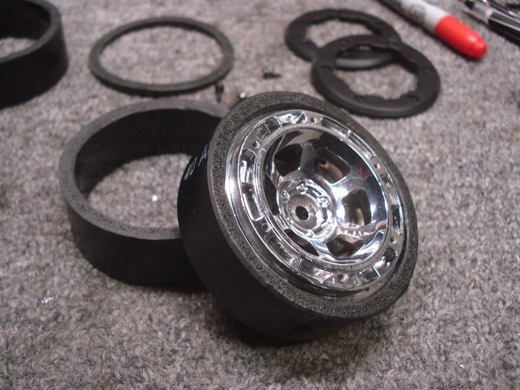

Did the rckjeep beadlock mod with 2"ABS. I cut the width at 3/4" but wish I would have used SCH 80 instead of the thick ass SCH 40
(1/8" air-hole not pictured also added some lead rope under the ring)
Look good with the new Blue compound Bashers, not sure how they will perform...

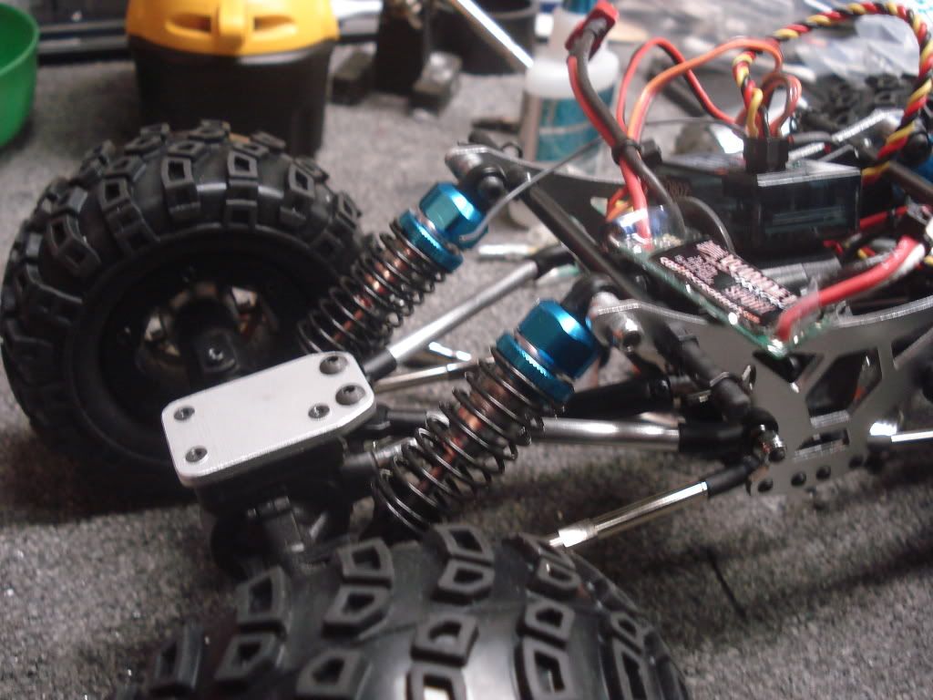

rear 4-linked with custom Al. plate, also added some new shocks

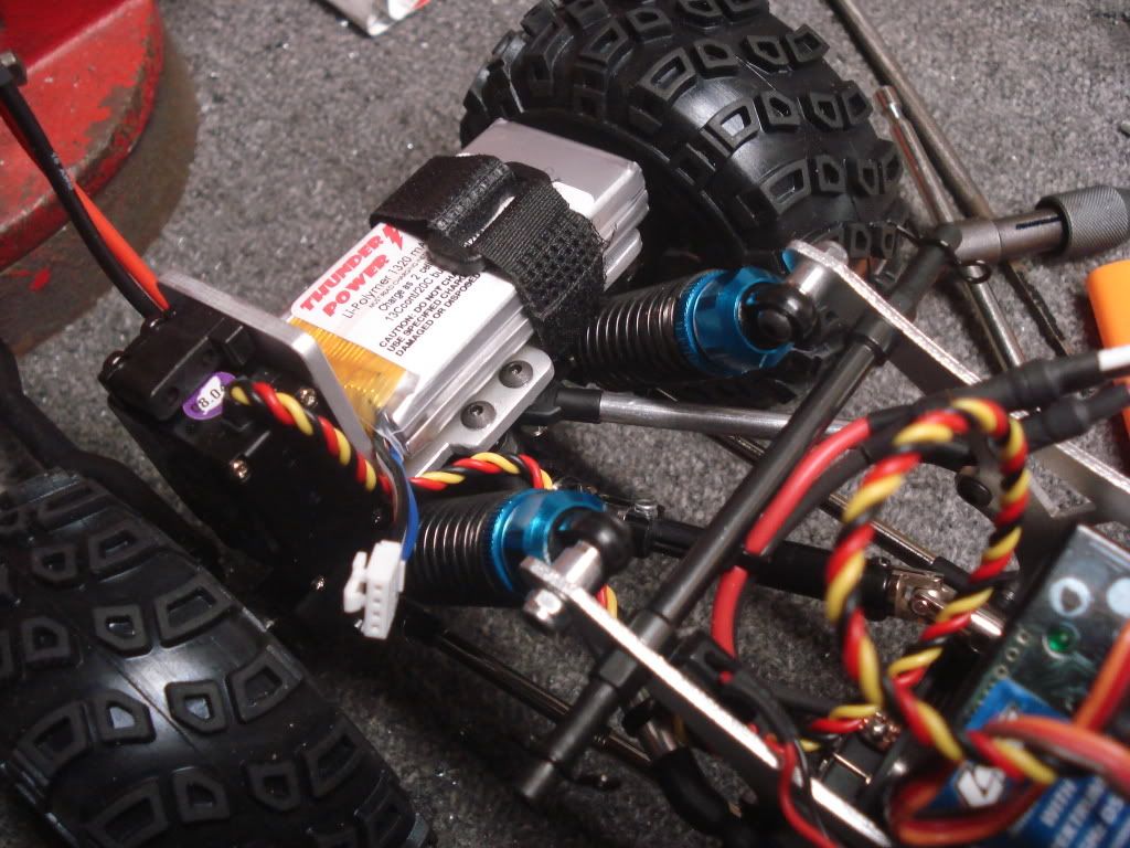

front 4-link with fatrock style battery/servo mount"thumbsup"also a new thunder power 1350 LiPo to just clear the tires

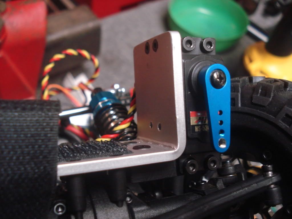

I tried to get the new metal gear Hi-tec servo mounted as low as possible so I used a piece of 1/4" Acetal and counter sunk some screws to attach it to the plate
What's the reason for mounting the servo that way? Just to get the battery on the axle? And why is it called fatrock mounting?
That's the reason, and there is a servo mount like that, designed for TLT axles, that's been around for a couple of years.
