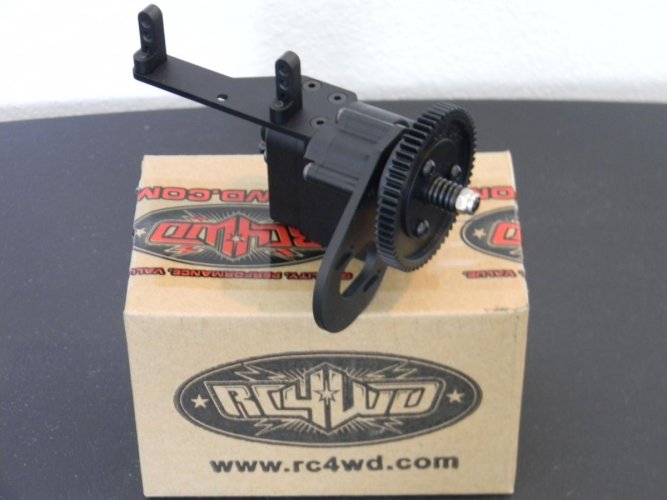

Just picked up a Mattzilla 1.9 chassis and it's time to have another build. I know this should prolly be in the U4 section but this 1.9 section gets more attention, and it's gonna be 1.9. This will most likely be slow and expensive build.
This is the parts I'm planning to use in my build.
Transmission:
-rc4wd 2 speed tranny
-robinson racing steel spur gear
-HV shift servo(not sure what servo yet)
Or I might just use a built up wraith tranny.

All I got for now is the 2 speed tranny, waiting on other parts.

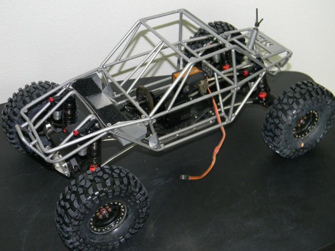

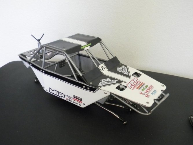

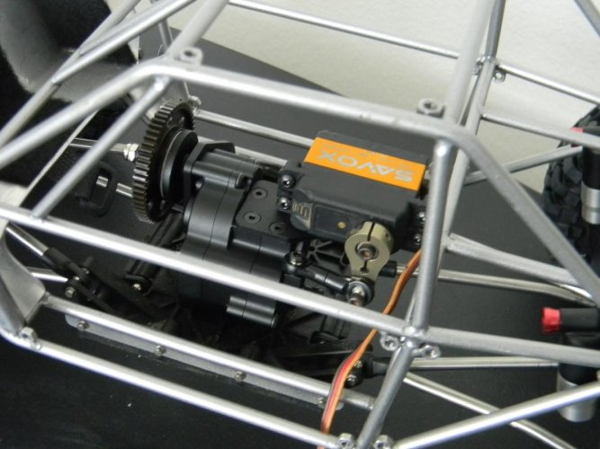

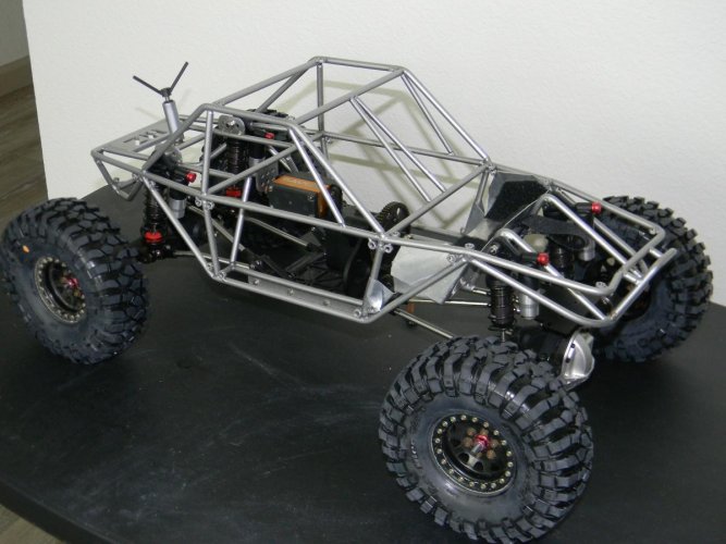

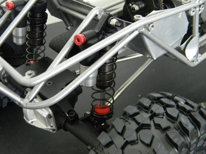

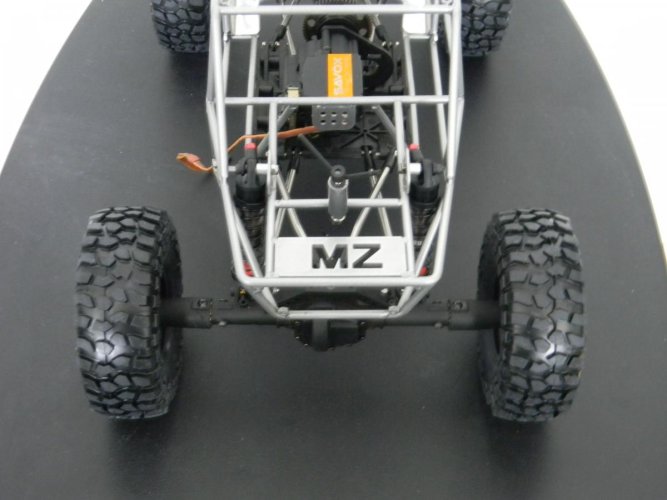

Did some work on the truck last night and it's now a roller. I decided to quit a YOTA build I was doing to focus on this build, luckily the YOTA had wide XR axles already and Gmade piggy back shocks.
So heres the current specs and some pics.
Front axle:
-ssd d60 case
-ssd aluminum truss
-ssd aluminum diff cover
-strc chubs and knucks
-axial hd gears (36/14)
-grip fab locker
-ssd brass wide xr axle tubes
-axial xr10 universals
-ssd aluminum bearing clamps
Rear axle:
-ssd d60 case
-xr10 axle shafts
-axial hd gears (38/13)
-grip fab locker
-wraith lockouts
Suspension:
-Gmade piggy back shocks (93mm)
-metal links idk brand
Drivetrain:
-Mip driveshafts (AX10)
-Rc4wd 2 speed tranny
-Robinson steel spur (58t 32p)
Thanx for looking!

Thanx. My motor and esc should be here this week then it should be ready for a test run. Still need servo mounts and wheels and tires. What would be good tires?
Those wheels are nice .... but the ones you have in those rock beast look bad ass also.
Yea I love those rims in the pictures but those are for my scx10 and I want aluminum wheels for this build to keep weight down as much as I can with that steel cage. I really want vanquish rims but I can get all four Boomracing wheels for the price of two vanquish and I still need hubs. IDK I can't make up my mind haha.

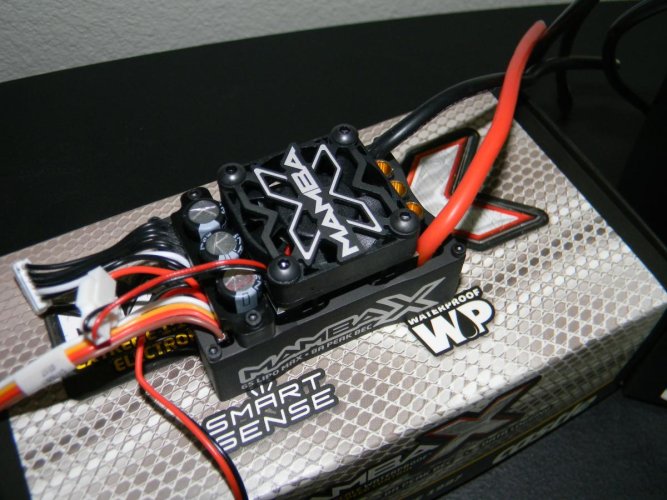

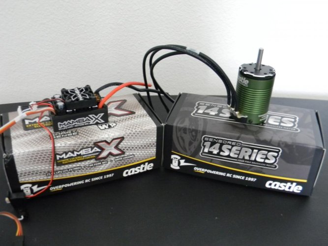

Got the power today.
This new esc is built way nicer than the MMP was this one appears to be all metal with hex hardware. I still don't care for the new sensor wire set up but oh well.
Great build. How do you like those gmade piggybacks? I thought about getting a set for the rock racer i am building but have yet to run gmades
