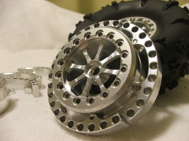

THE WHEELS: Mayhem Engineering 2.2 Wicked J Ultimate Comp Wheels
THE FOAMS: Crawler InNOVAtion 2-Stage Foams
THE TIRES: Panther Leopard Crawler Tires

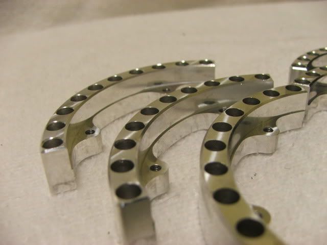

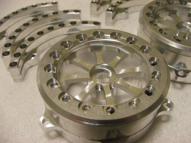

I opened the package from Mayhem and was immediately impressed with the careful packaging of the wheels, each wheel/ring set was individually wrapped and protected, Very nice touch! after unwrapping everything I was FLOORED by the machining quality of these wheels, Mayhem DEFINITELY stepped up their game with these ones!! ABSOLUTELY GORGEOUS!!! Its a damn shame I gotta cover most of these wheels with foam and rubber! The machining on the supports is almost MIRROR FINISH!

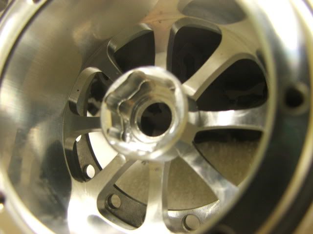

Ok, Now most of you are probably wondering how to weight these wheels. SIMPLE!!!
I simply took my wheel weights and trimmed them a little to fit in the gaps under the support rings! THEY FIT PERFECT!! and I was able to add the perfect amount of weight to them! You have to loosen the support screws before you push the weights under them, then tighten them back up and they are not going anywhere! Super easy and clean! Oh, and the weights that I used were 1/2oz weights, For the guys using 1/4oz weight, just stack 2 together! Easy as that!!

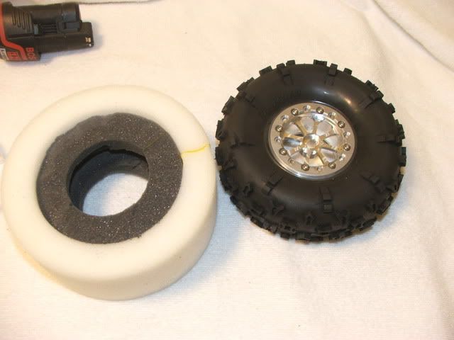

After trimming 1/4" off the inner foam, I channeled the inside of the foams to fit the support rings on the wheels
I then gently stretched the inner foam first over the wheels and aligned them up. Then I installed the outer foam over the inners. Then I STRETCHED the Panther Leopard tire over the entire Foam/Wheel assembly. I found it much easier to do this rather than stuff the foam in the wheel first and then fight to get the wheel in place. This way you can align the support rings from the wheels in the foam and also align the foam inside the tire too! Works slick!!
Sorry but I don't have any pics of me doing that but I can assure you it looks just as I described it!
Heres a pic of the mounted wheel/tire combo next to an unmounted foam for size reference.
The foams look a tad big, but not to worry, they are a perfect fit for these tires and rovers also!!!!

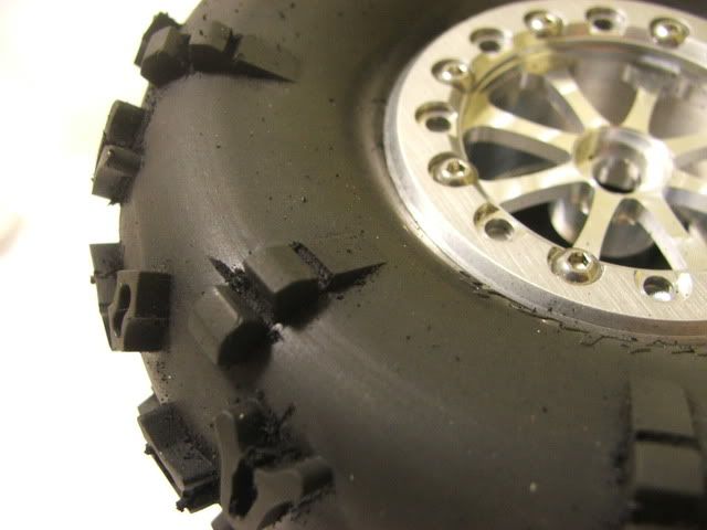

On this set of Leopards, i decided to sipe them as Eddie has described in his other threads, I siped the side lugs and the center tread section.

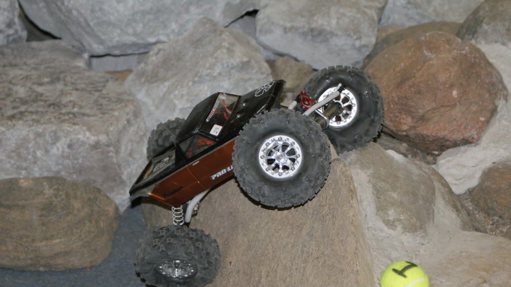

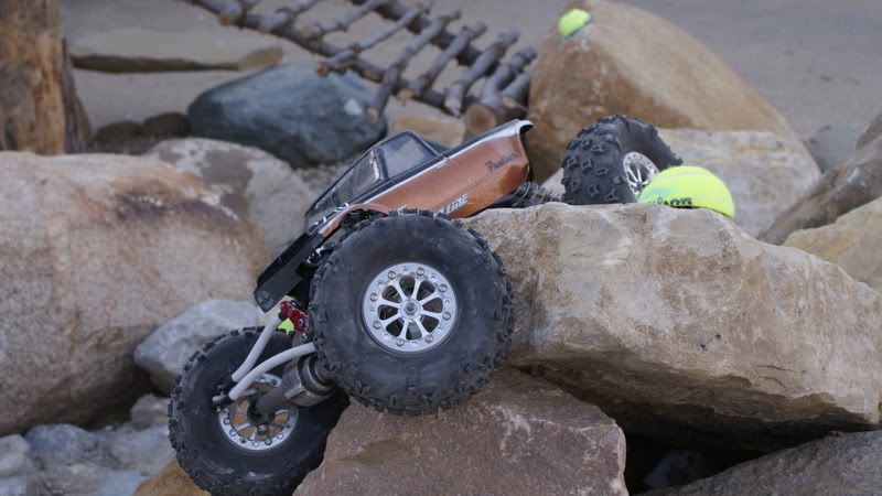

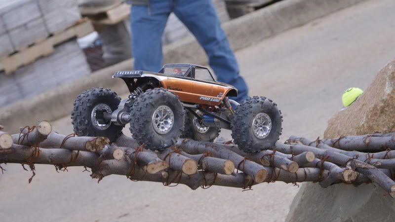

Here are a few shots of this setup in action!!

The wheels performed EXACTLY as I hoped they would, The weight distribution that i used was perfect, and the UCW design is a real asset to my crawler. The tall support rings make undercuts a thing of the past! They simply work! Holes that would normally cause a tire to fall in and wad up were no match for this setup! The supports are tall enough to help in holes and undercuts, yet short enough to still allow the tire to fully flex and still wad up a bit on high traction surfaces! The are completely functional as well as good looking! The ring seems to prevent the tire from wadding up as much and keep more of the tread in contact with the rock surface.
Mayhem Wicked J Ultimate Comp Wheels, A+ "thumbsup"

After reading about Siping the Leopards, I decided to give it a try. I figured it would at least prolong the life of the leopards, considering that my other set was almost completely destroyed and I only had 3 Comps on them!!!!
After several packs through the tires, I still was not terribly happy with the performance of them. I did end up completely removing the side lugs saving the top bit of side lug, This helped soften up the sidewall of the tire and helped with forward traction. However, my old worn out set that were basically Unmodified still hook up better.

Panther Leopards, Siped and side lugs cut. B-
