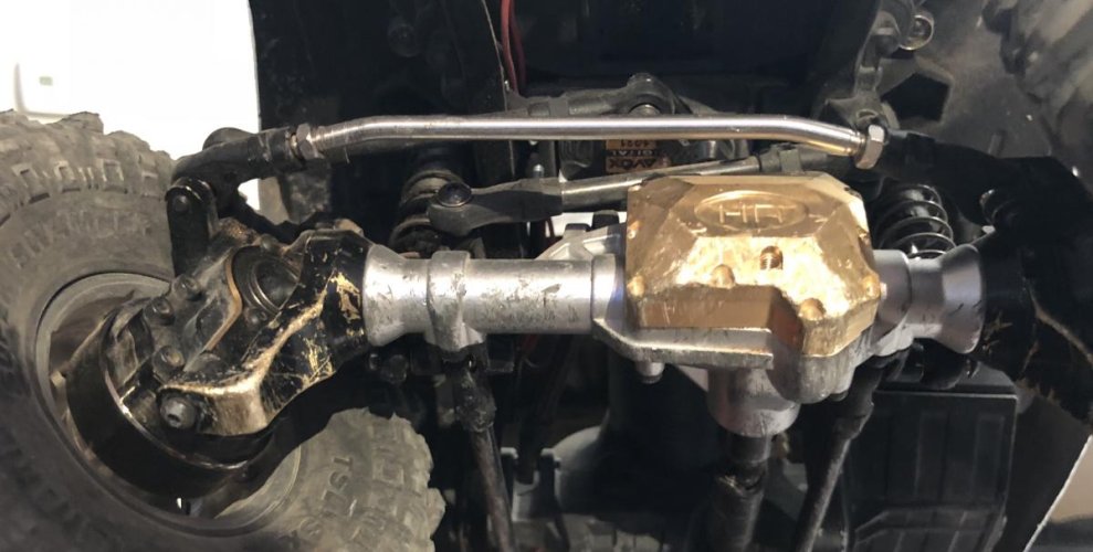

I’m running the ssd portal covers, hot racing diff cover, Samix c hubs, samix knuckles, and the xtra speed axle housings. I’ve noticed performance gains with all of them. This little truck goes vertical quite well. FWIW the ssd portal covers have more weight than samix.
I don’t have many clips of this one crawling but here’s the only example I could dig up https://splice.gopro.com/v?id=9GAZKy
With that being said, I’m not suggested to do it all at once. Start with the portal covers and go from there until you’re happy.
