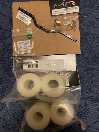

Parts that have arrived: HR knuckles, CI foams, TGH factory fit carbon rails, and screws for panels.

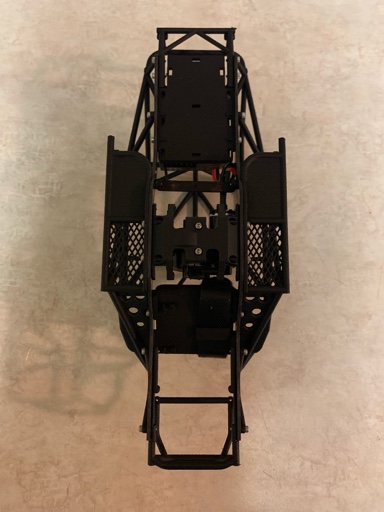

Jumped in head first, painted chassis satin black, installed CF rails, they worked wonderfully! I’m very pleased. I switched to better hardware off ebay (1.4mm), still waiting for HR skid so used stock for now. Painted panels, they’re out drying in garage, updates on those tomorrow. Oh and my wheels say Thursday now, yay! Haha
Awesome pnw. Glad to see it coming together and that the cf rails work! A little tip is dont tighten the front 3 link too tight on the frame I did and it had limited my suspension movement.
Very cool that the rails worked out. At some point you will have to post some close up shots of the rails mounted up. :)

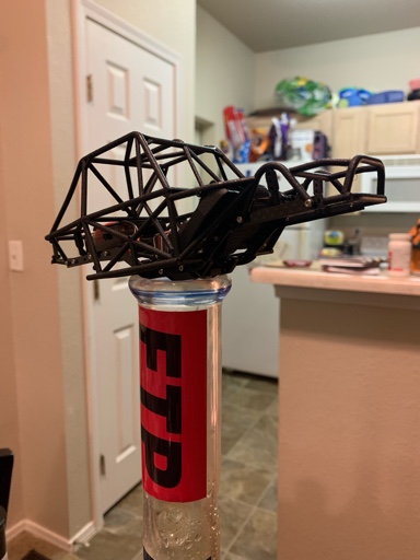

In the process of moving while building this, so my updates are a little spaced out, but she’s basically done! The brass servo mount worked great, it barely makes the servo clear but it worked! The soft CI foams were way too soft for the big scramblers, so I used medium up front and stock in the rear. Losi trekker shocks with the springs trimmed ever so slightly. Mil stone kit off ebay for the wheels.
