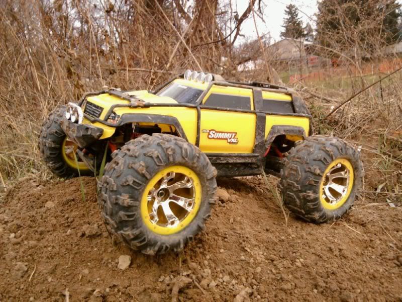

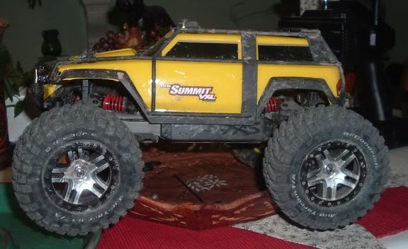

oh man i forgot all about this...ill check for ya but for now here is a pic from today.

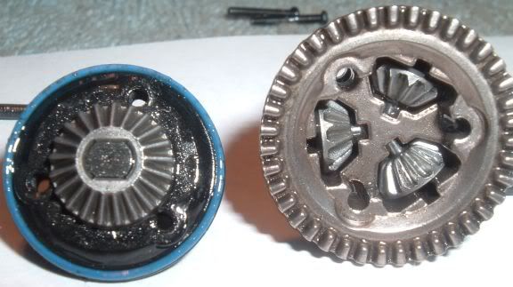

Twisted have you had any problems shreding the gears in the rear diff? I have a Mini Summit with the titan 12 turn and after probably 5 packs my rear diff was TRASHED. I did have my slipper set correctly and there is no visible wear on my spur gear either. What are your thoughts on JB welding the rear diff? Im towing with the idea of tuning my summit for rock crawling.
no problems what so ever and my diffs are almost full of ofna diff lock.i would use something less permanent then jb weld.
Was just thinking about trying that with the diff I trashed. Only on the rear I would still like a limited slip up front.
Try hot glue, I had some axles I bought useed that were hot glue locked and if you leave them a little greazy the glue won't adhere to the gears and its easily removed. Let the glue tack up a little bit but not dry when you re-assemble the diff so it won't glue anything together. My Mini Summit will be here next week, I am pretty anxious to try it out. I am having a blast with my Rally VXL, I ordered the Summit w/ the brushed motor, I want to try a few different motors I have in it and if I don't like them it will get the 1/10 VXL I have kkickin around.
