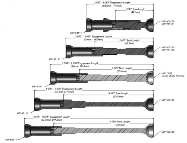

I don't know if you guys have saw this or not , but I came across it today . I was trying come up with what shafts I needed for a custom build . I could have saved several hours of reading if I would have found this first.

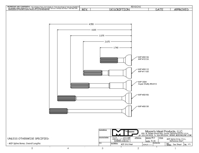

I got this emailed to me this morning . figured I would add it also .

What's the part number for the 3rd one (male, 3.375")? Cant find it on MIP website.
Or is it only available through super shafty as there 'exclusive' shaft?

Yup, it is. But good news is RPP is now carrying it."thumbsup"
