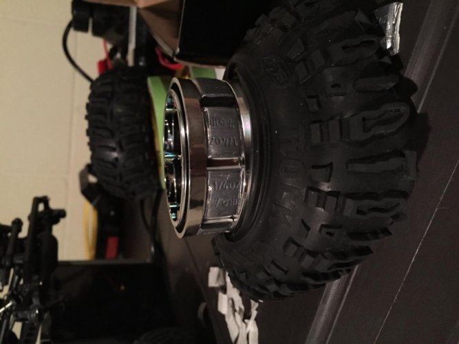

You can buy automotive wheel weights the stick on kind , take the tire off the bead locks and stick them to the hub of the wheel there is a Chanel in the center you’ll see it when you get the tire and foam off. Once you cut the weights they fit right in that Chanel. I put 3.0 oz in each front and 1.5-2.0 oz in the rear. The down fall to this is that it very rapidly wears out the stock servo. But any other weight added will do the same . My recommendation is to do that and replace the servo at the same time , opt. Also think about a bec with the servo if it don’t have an internal

I started taking the wheels apart last night because we had already decided to replace the stock RTR Super Swamper tires with Hyrax's. I did pick up some stick on lead weights like Rattzo showed in his pics. However, the channel on my son's wheel is much narrower than on Rattzo's wheels. Just eyeballing it looks like the weights will have to be narrowed by as much as 50% to fit inside the channel which means less weight can be added overall. I'll try to put up an image of the wheel this evening. Based on the wheel design it looks exactly the same as what was previously used on the Twin Hammers. So maybe y'all are familiar with the wheel I'm talking about.
