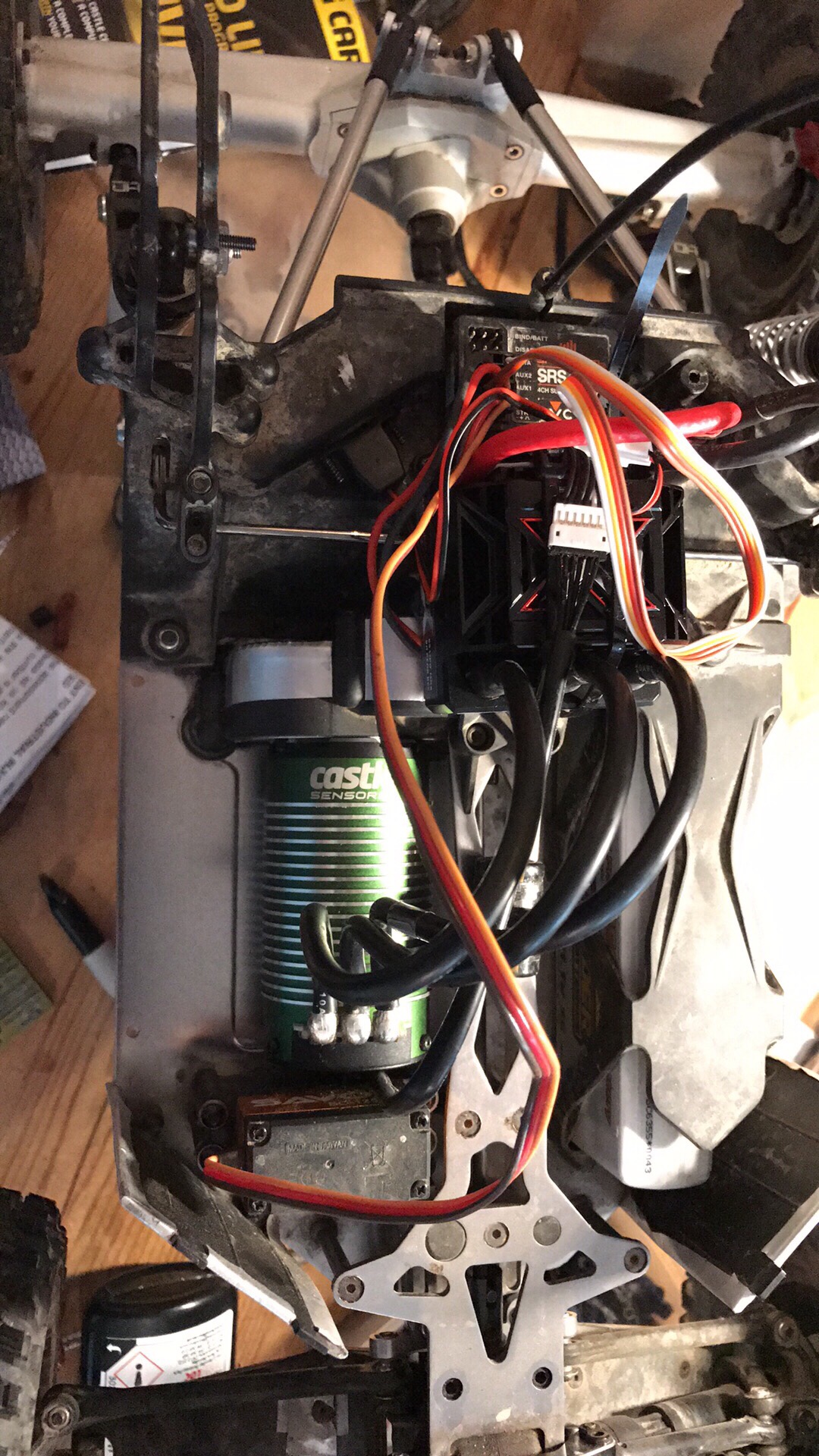

75 mm [emoji106]
It’s not a straight forward fit though , the chassis plate needs to be hallowed out to receive the larger can and some plastic housing surrounding the transmission needs to be trimmed to get the pinion shaft in and the motor mount can be troublesome , Iv found if your running 16T pinion then need 17T position on motor mount [emoji106]
this is the 1515 2200 kv
There is also the 1512 2650 kv
If your putting 1/8 power in it definitely 100% will need to build bulletproof diffs
If you need anymore info about the diffs drop me a message [emoji106]
