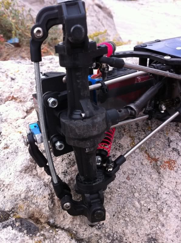

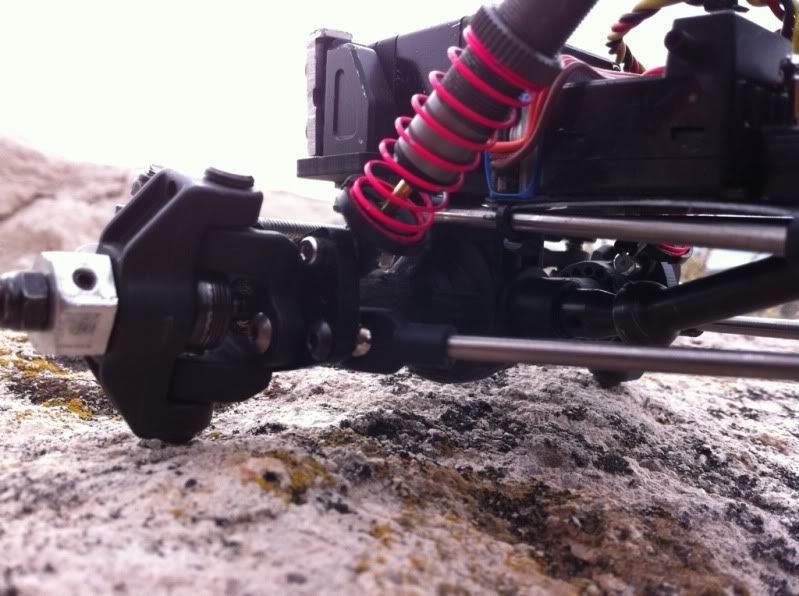

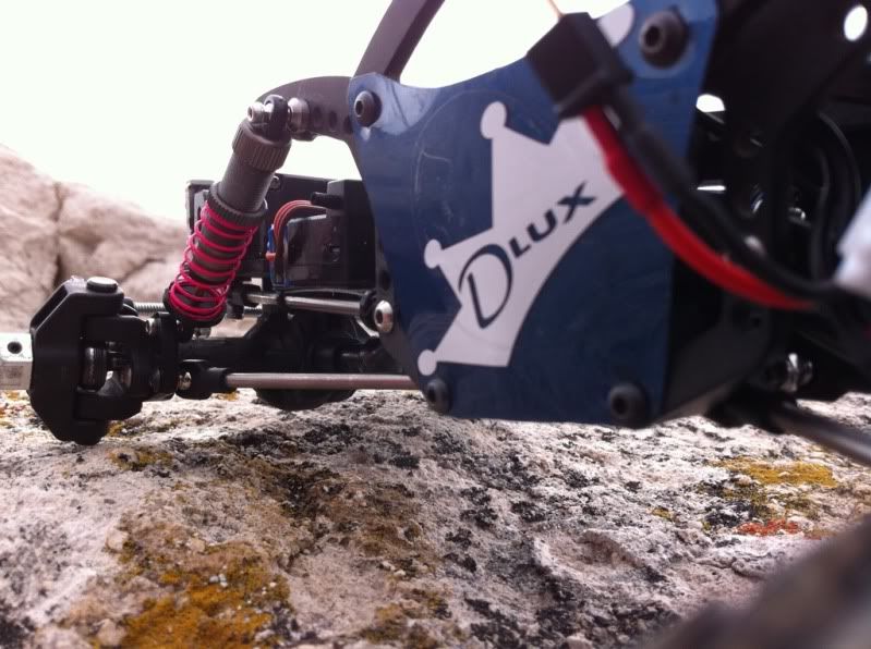

I have installed one set and its amazing how the mounts really firmed up the end of the axle housing. Everything is sitting super tight and solid.
Here are a couple pictures.
Each install will be different according to what parts you are using. If you use the stock MRC inner shafts with the LCC stubs, you will need to grind the chub down so that the inner shafts are long enough and reach the locker. See Jeremy H's thread below.
You will still need to figure out your steering tie rods and drag links at the least.

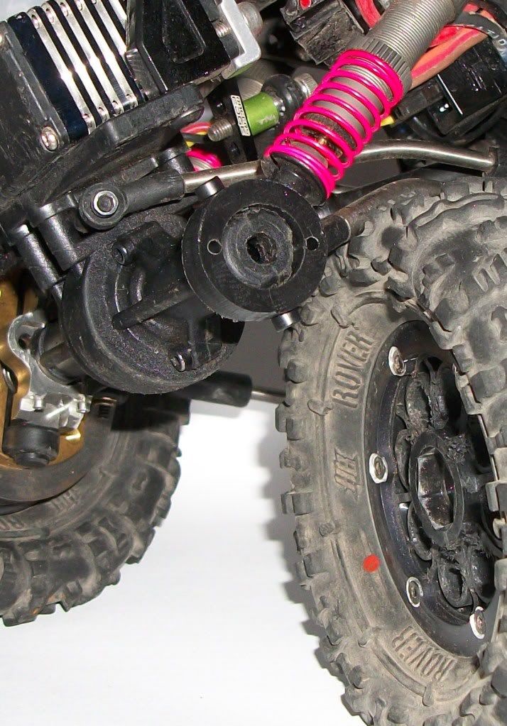

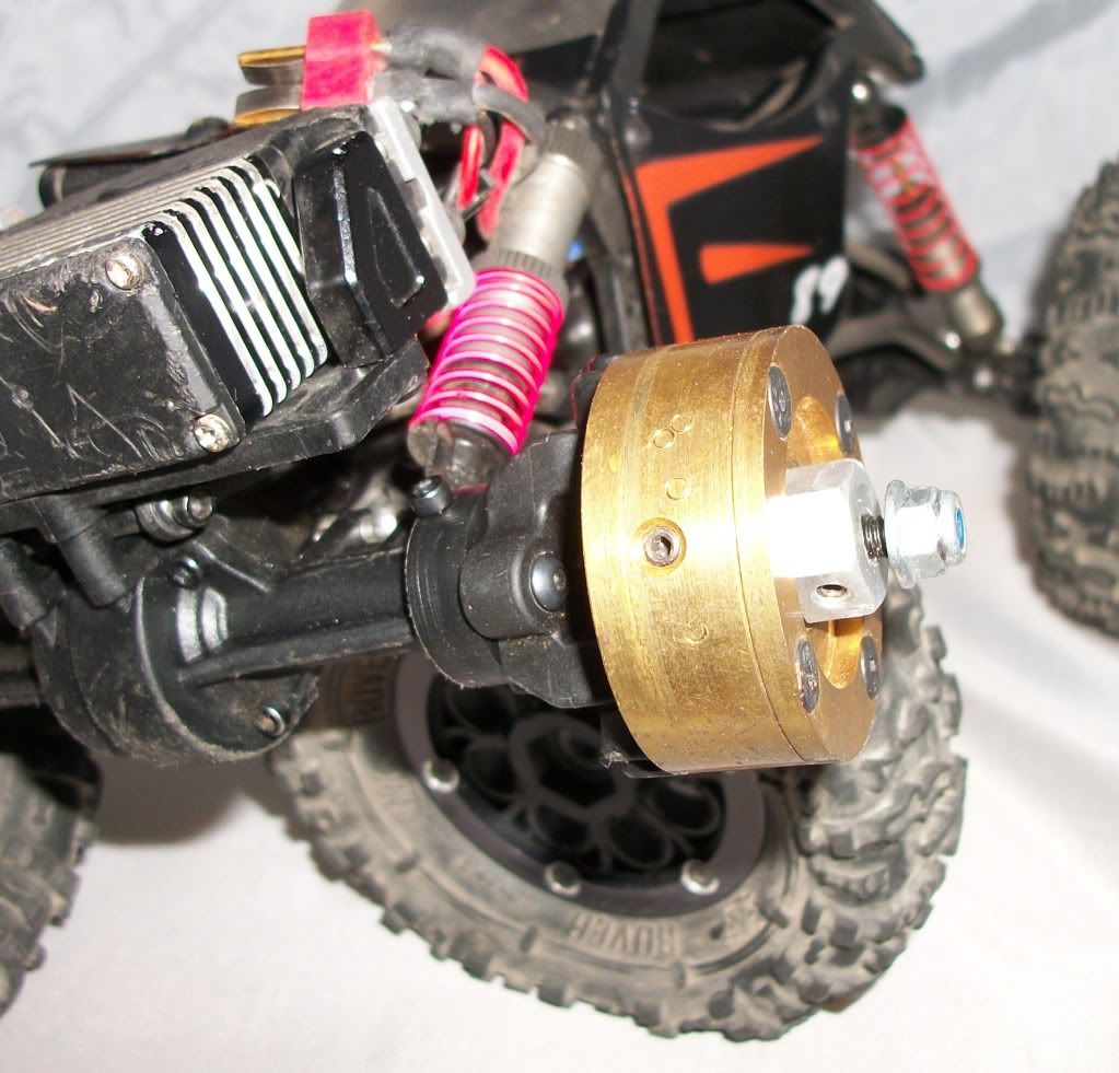

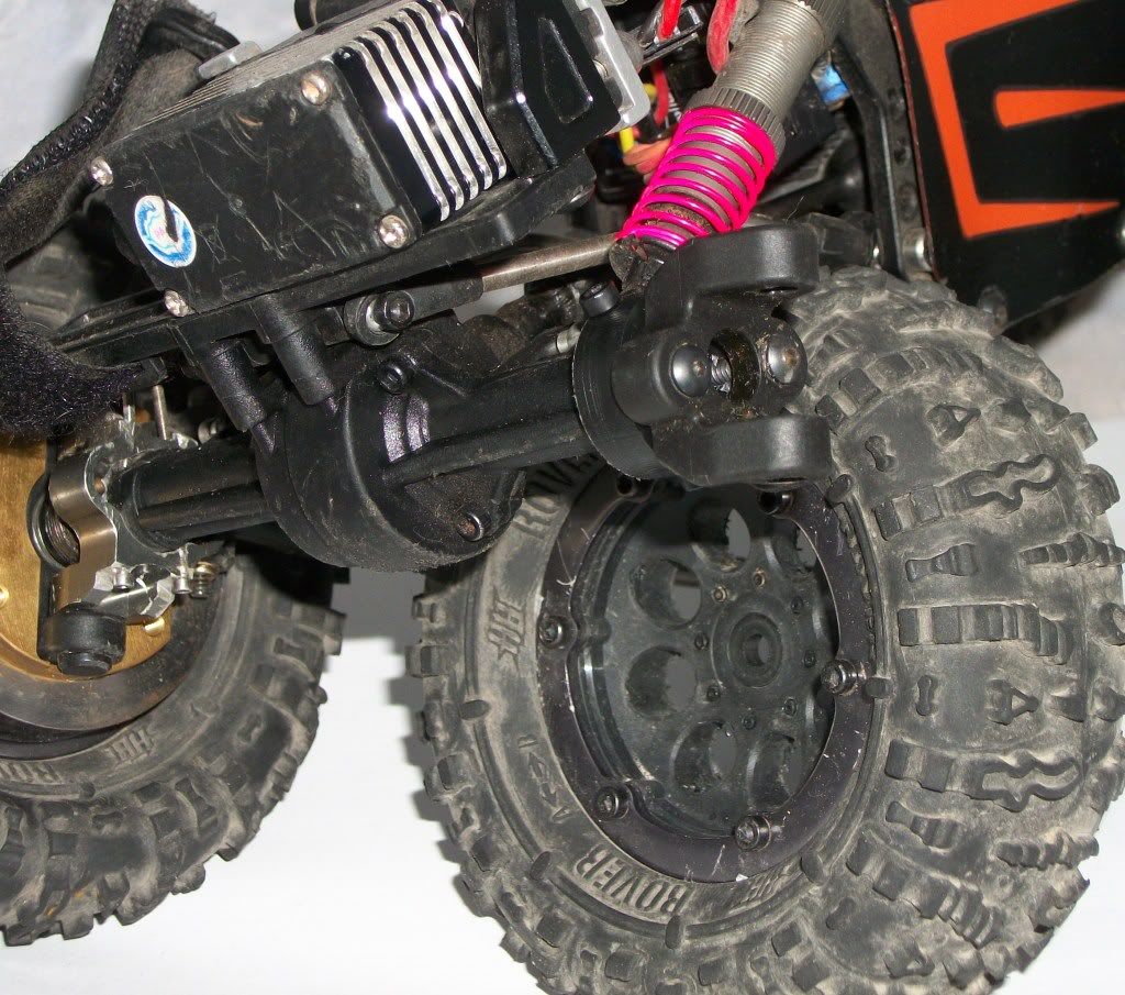

here is my take on this mod....I did it a bit diffrent then what others are doing...now ALL my link rod ends are the 3mm short traxxas ends!!"thumbsup"
and my stock MRC mounts are gone completly!!!:twisted:
one shot of the rear....
Thanks for replying with pics Mark! I am trying to find time to gather some info on Marks findings above.
