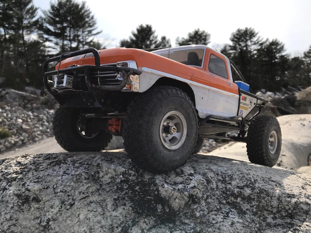

Great pics, area looks great for crawling!
Thanks! I've been up and down this mountain about 5 times this week (vacation).

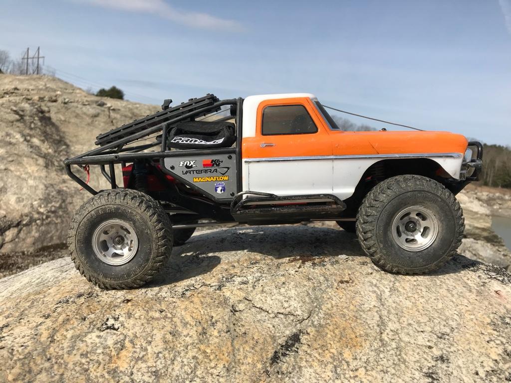

Wheels look good, I’m using the same.
Yeah, I might get some more of these. I wish they offered them in chrome though.
FYI You can stretch the wheel base a bit with minimal effort by installing longer rear links ( same as kit Ascender wheelbase 4 ) and the longer rear driveshaft parts too.
I figured as much. Honestly though, I like it having a shorter WB. Is this the Bronco WB?
The short WB makes it so manuverable. My TRX4 has the 12.3 WB and so does one of the SCX10's (other one is 12-even), so this gives some variety, instead of having them all be the same.

Had another great outing with the Ascender on Mt Cardigan Sunday. Got a group of us together this time. It was pretty cold and windy, but it kept the bugs away so I was pretty happy about that.
I really love the mix of terrain on this mountain.
Thanks, and yeah I was looking at how far away STL was. It's a little bit of a drive, but not all that far. Time and money is going to keep me away though. I do most of my crawling on the trails. I've done a few comps though. I hit up Mt Kearsage in Warner NH today and took the Ascender out for a run up it and was pretty happy with how it did. I had been thinking of trying some different tires, but after the way the ripsaws worked today I may have to re-think that one.
Dang, that looks like an awesome spot. Truck looks great on the rocks. I’ve been so busy I haven’t been out at all this year but would like to. I love my ascenders.
