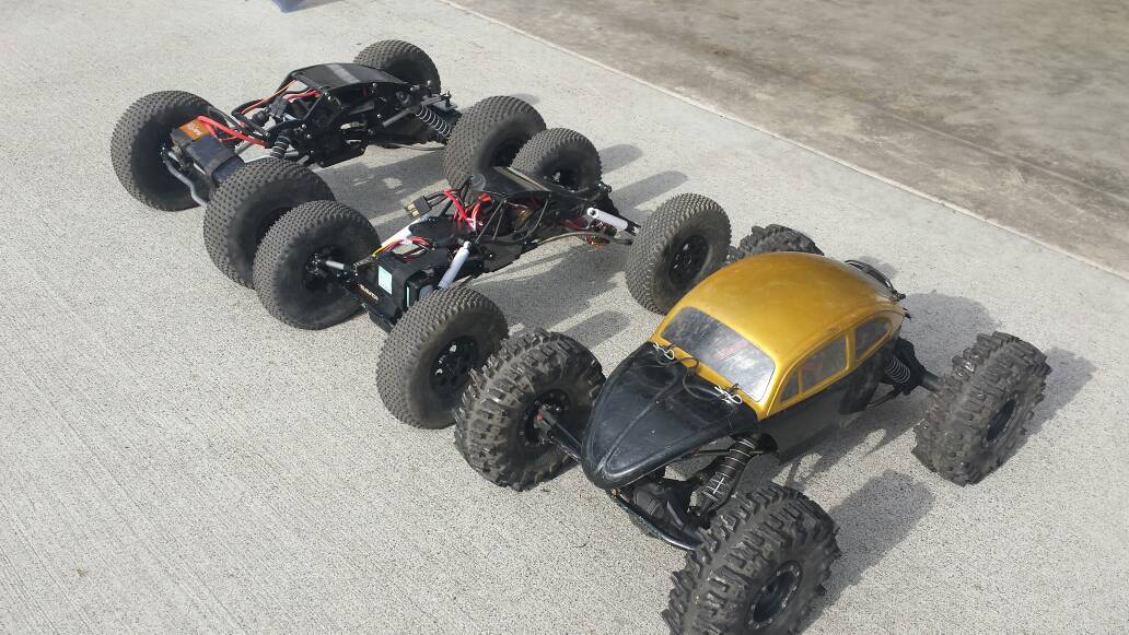

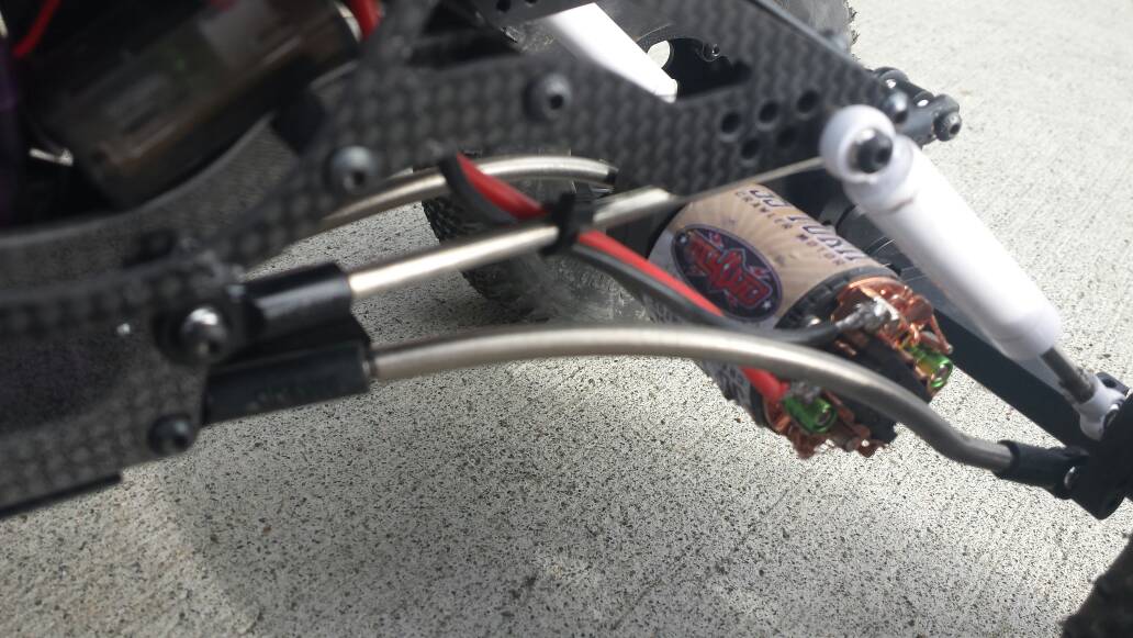

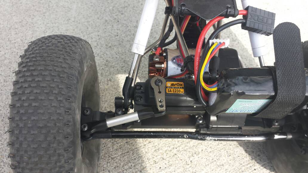

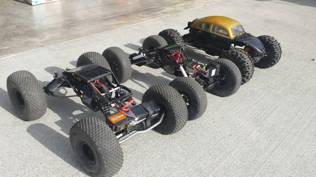

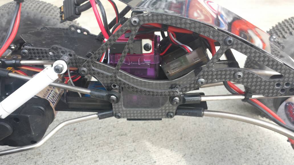

Received my new Bully 2 almost 2 weeks ago. I changed the shock location and put the lighter springs in. 30wt in the front and 60wt rear. Basically took cboggs suggestions. I didn't decase the esc or dig unit so they wouldn't fit down below. I did relocate the receiver and bec down below though. Cleaned up all of the motor leads. Also added a stronger servo. I ran it last weekend and am pretty happy with it. Drives a little different than my deadbolt/ UGC fastback. The dig feature works well. I would suggest going through the rig before running it. I did not and had a lot of stuff loosen up.
Here's a few pictures.

Looks good, always go through a new rig before you drive it.. If I were you I'd check the gear boxes for grease.
Clock the chub, and also more the steering link to the upper side of the knuckle.. And the drag link on top of that. Then the drag link runs flat and not in a angle like it does now
Verstuurd vanaf mijn Nexus 6P met Tapatalk
Thanks guys! I will rotate the chubs and move the steering links. Also going to order the knuckle weights and longer link ends for the rear upper links.
