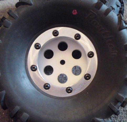

From the looks of it so far, I might have to do a bit of bending on the links to get them a slight bit more room at the gear case and motor for the way I like'm to be. She's got the choice of wheels with my new Eritex white Delrin six holes and Red DNA stalkers.

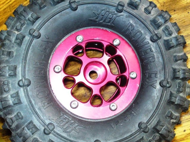

Yeah, it's pretty bright at the moment. Here's her wheel choices and a clue to the theme she wants.

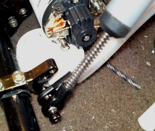

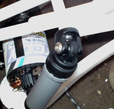

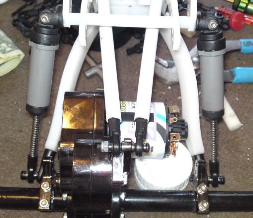

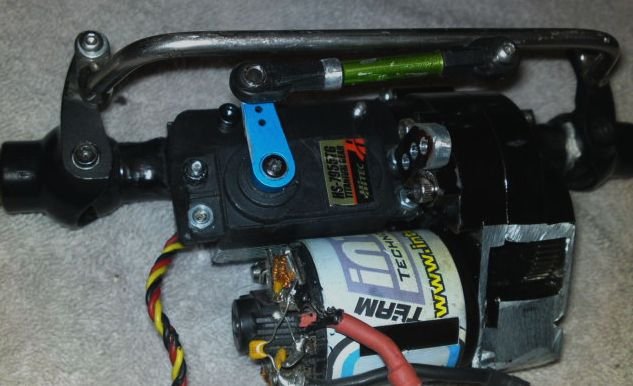

Trying out some Slash rear shocks for now. I've got my Krakker springs on them and did the drive shaft yoke mod. (pretty slick really) I chucked'm up in the lathe to cut'm off then did the drill treatment. I'm liking these for the rear, but i'm going to do the cap mod to some Slash fronts, for the front. Nice and light weight too.
So far this chassis looks to be a pain in the A$--$ to mout the eletronics into AND be able to replace the batteries. (I might have to get smaller batts for this one.)

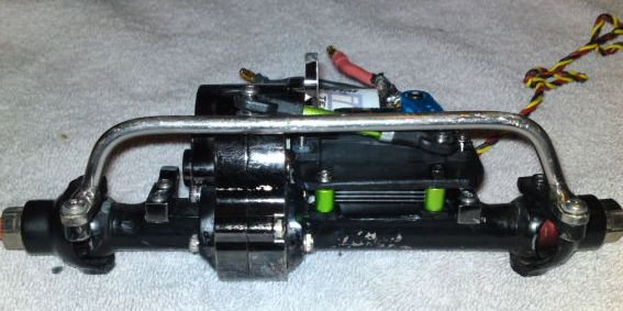

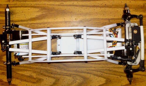

Been a LONG time since I had time or parts to work on this thing, but this past couple days I've managed to get the electronics wired in, BEC's set, gear cases shaved and the rear steering axle assembled with the 53Willy's servo mount. She's getting the spaced out front axle set from my PRO thread with a 7955 rear servo and a 7950 front servo.
