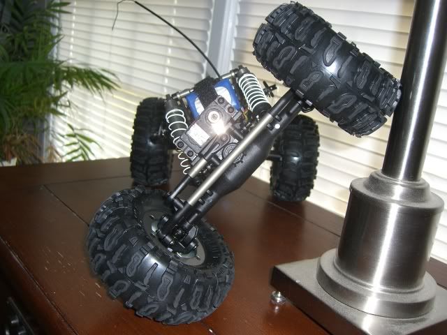

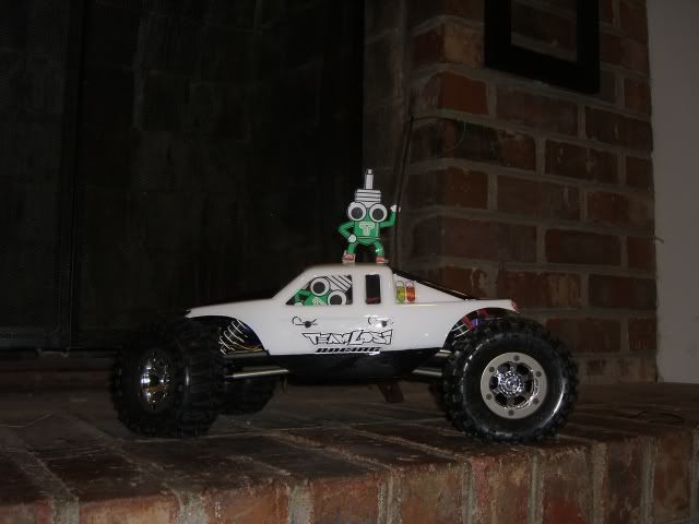

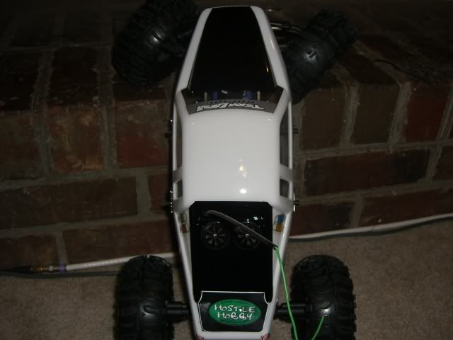

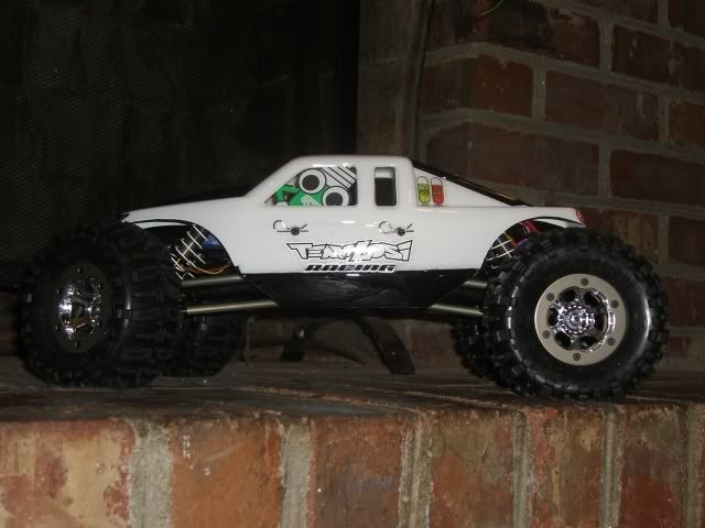

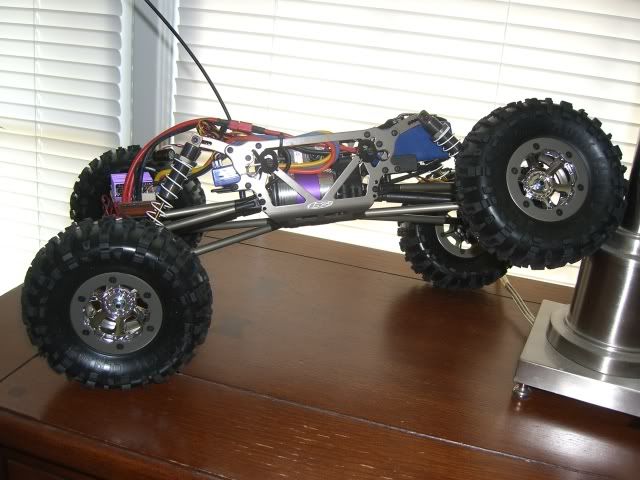

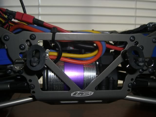

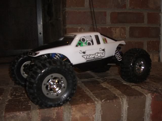

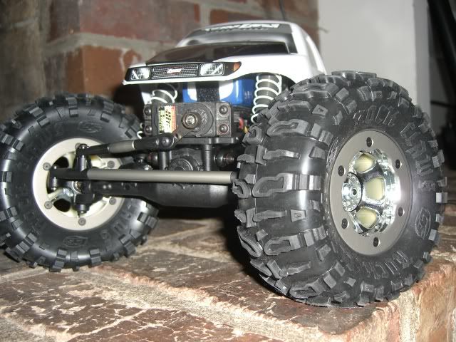

Well it moves on its own now! And thanks to the awesome design of the dig servo, it only requires 6 degrees of movement in each direction for locking the front or rear, so I can just reverse my 3rd channel on my radio and it will allow me to lock the front or rear remotely. Heres some more pics!
Truck has 7955tg steering, 225bb for dig, Goat powering it, losi 3300 lipo, 14t pinion, and airtronics MX-3 radio system
