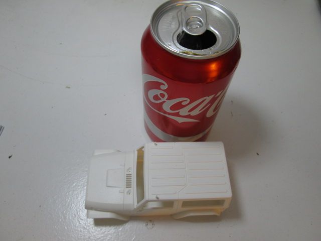

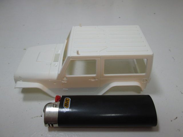

My first impression of the body was " No fricking wayThis is so small.. It is also very detailed for a model this small. Its more like a 1/24 model kits detail. I'm starting to worry a little bit..

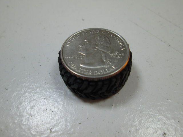

The tires are almost like baja claws in style and are about the size of a quarter in diameter.

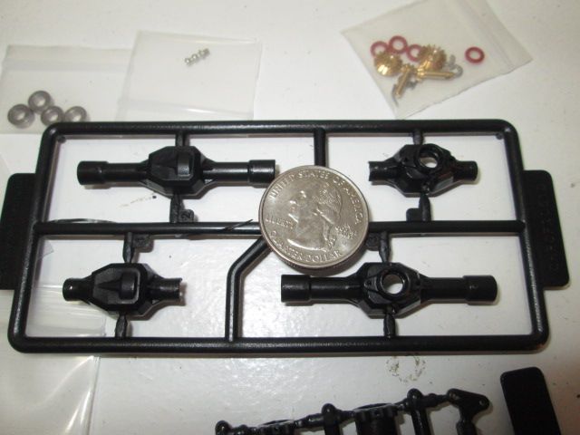

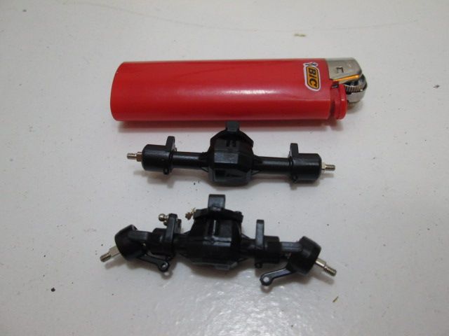

Axle housings with a quarter!? They are cleanly molded in a tough plastic, looks like a pretty solid design to me. Oh, did I mention everything is tiny?

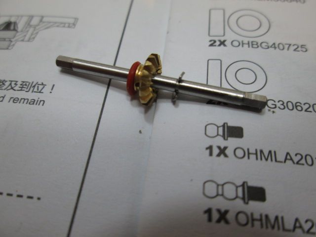

Ring gear on axle shaft, I bent the E clip a little getting it on the shaft but if fit after some tries and Sam also includes a couple of extras with the kit. In this pick the rubber O-ring must be slid over the ring gear slot to hold the drive pin in place. There is a round groove the red O-ring fits into.

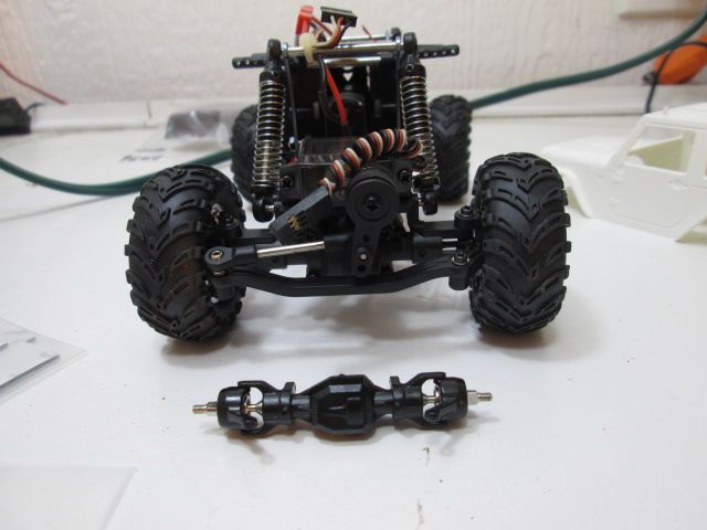

Here is the front axle assembled in front of a Redcat Sumo crawler. Its just a bit smaller than the redcat lol.
Here's the assembled axles. They may fit a couple of 1/10 crawlers with some work LOLOL.

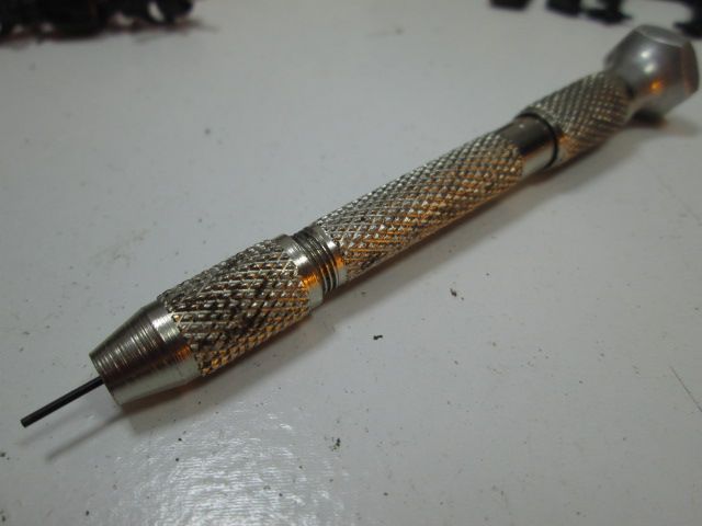

Ok, here's a little trick I use on rigs that are small. Take the included hex driver and cut a bit off the long end and slip it into a pin vise. Makes things 10 times easier to install the balls and screws for the kit.

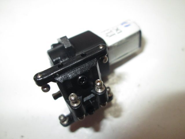

The transmission is really cool and I can see some using it for custom builds
Its an all in one trans + skid plate with all metal gears and bearings throughout and N20 motor attached.

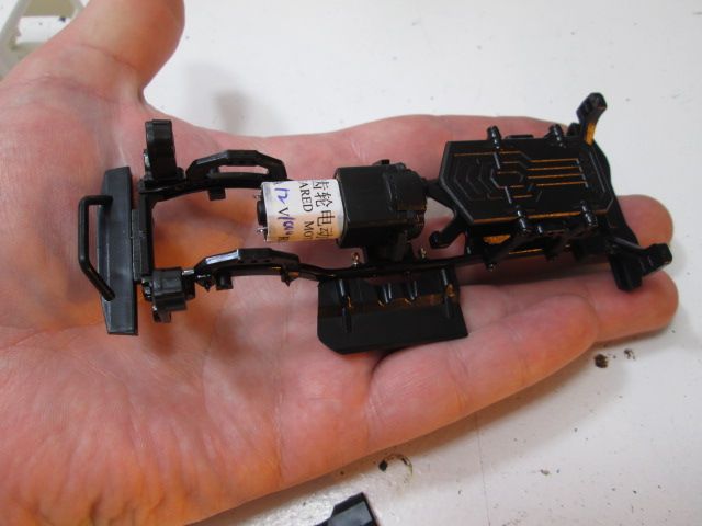

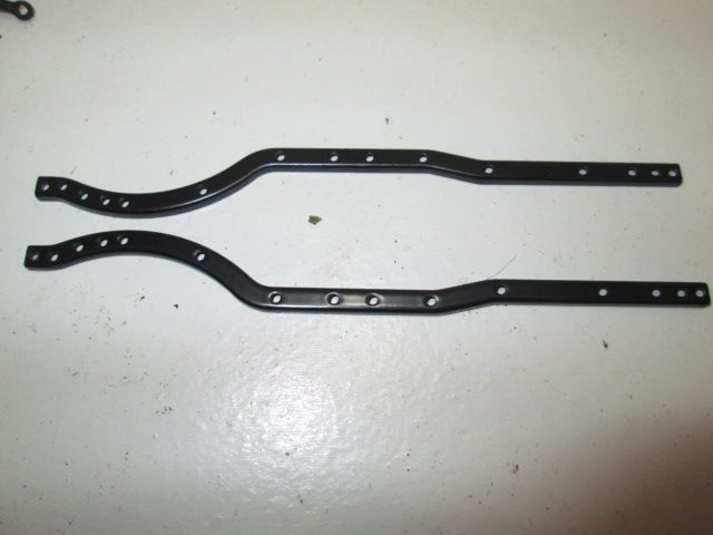

This comes with a steel ladder style frame. I wasn't expecting that. I was really impressed with this.
The chassis is a nice tidy setup. Everything has its own spot but can be changed up to your taste.

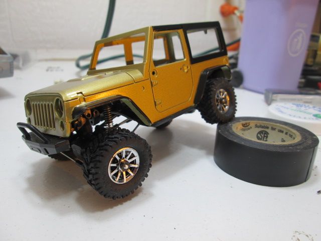

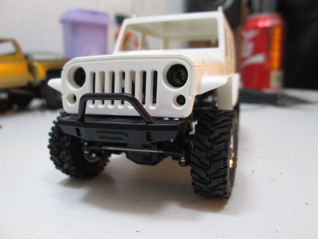

Um, must install body. Its only right to get a good view of the rig. I also really like that Sam has designed and put into production the aftermarket style bumpers. One less thing to mod.

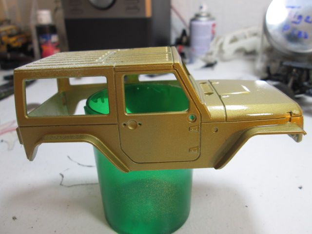

I could not wait to get some color on the body and get to detailing!
Just figured gold would work on it and thats about all I had laying around but I like it anyways. I started to paint the black parts by hand. The faskolor paints work well for me and are water based so its easy to touch up when shiz gets rough.

As for the kit itself, I honestly don't have any problems or issues besides getting the wheels to fit smoothly onto the output shafts. That can be remedied with a little use of a exacto knife to scrape some of the chrome plating off the inside of the wheel.
Good news: With some patience and taking my time I was able to successfully assemble the kit even with some physical problems and actually it wasn't so bad. If I can put this kit together myself I truly believe that almost anyone can put this rig together if you have the drive to do it. When your done, you have an awesome platform to run it stock or it'll be cool to see what mods some builders have in store for it.
