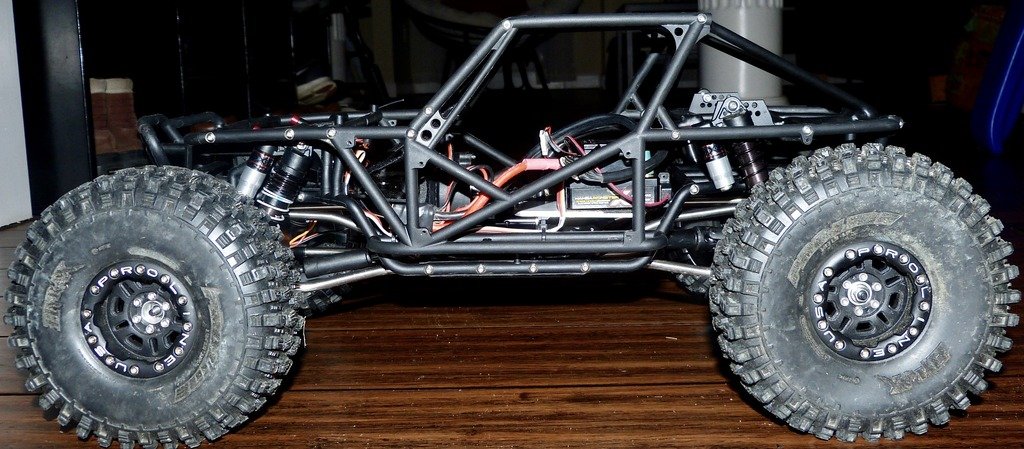

Hey guys,
I posted a couple Axial Bomber Builds I did with the B1B and B2B in the Bomber forum, and wanted to post my Wraith build. This is actually my 6yr old sons Wraith. Got him this for Xmas 2016 as a kit and we spent a lot of time putting it together, mainly because he is a kid and he is slow:ror:.
IMO, the Bomber Kit is head and shoulders above in every way, even down to the plastic strength of the cage. The Wraith Plastic cage feels flimsy and too flexible and can snap easily. However, the Wraith has a good base to it, with its shorter WB and I do like the 4 link suspension better than TAs. There is some torque twist to it, but it’s not as bad as the Bomber without it’s sway bar.
It is currently lightly modified to include:
Battery relocation to front mod
VP Stage 1 Kit
Axial HD UD Gears rear and HD Standard front
Bombproof tranny
Castle Monster X
Holmes PP BLE 3500KV
Runs on 3S Lipo
But the issue is this – I have 3 Bombers. 2 are highly modified to go fast, (B1B and B2B). One of them is built like this Wraith here, but as you know, Bombers are made to handle higher speeds better than a Standard Wraith.
So my son is trying to keep up when we’re zipping around and drifting corners, etc -meanwhile he is doing cartwheels attempting the same stuff. Even though his Wraith is turned down to 60% power on the radio.
I know he’s only 6 and doesn’t have the dexterity yet to handle the rig effectively, but I’m on a mission to try and build this thing to be able to handle the high speeds better, while maintaining its decent crawability.
My plan is to lower the COG with shorter shocks
Lower some COG with a Dlux Truss/Servo mount
Widen it with wider axles/hubs
Stiffen the cage with a DMG Stiffy
New Wheels/Tires
New Body/Paint
I know these mods will improve its high speed handling, but I’m very curious to see if it can still out crawl the Bombers.

Seeing it sitting on all fours, under its own weight, it looks much more balanced. Hard to see exactly, with the wheel on, but judging by the links, etc, the caster angle does appear closer to correct. Well done!"thumbsup"
