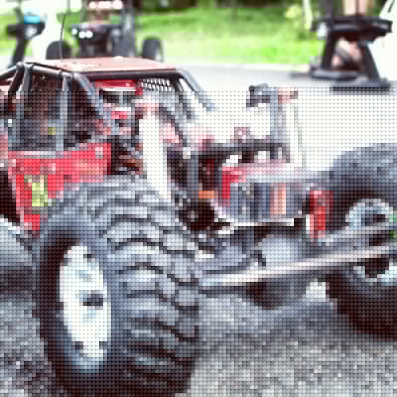

The one's in this picture are Gmade Zero's but I did the same with my piggybacks. Just picked up some larger aluminum ones.
