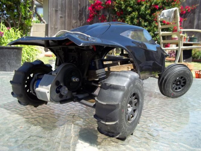

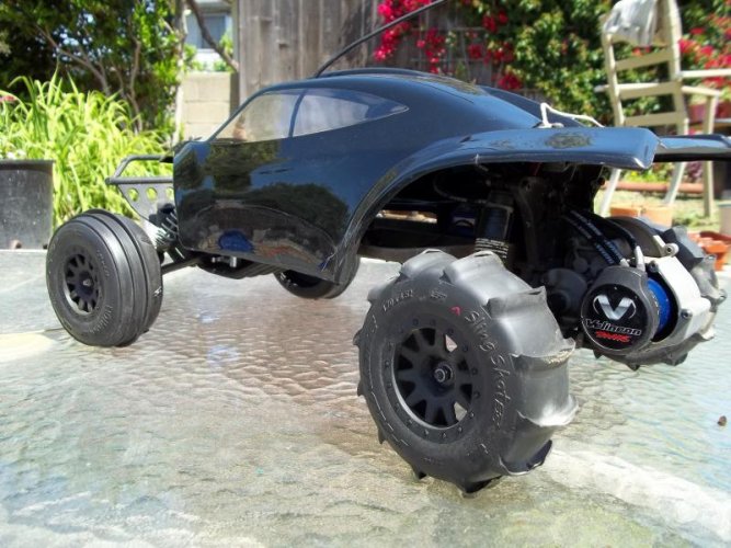

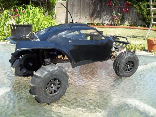

Here's mine. STRC LCG, ANZA towers, B-Bores,3-Racing bulks and carriers, RPM arms, AKAs, with the above-mentioned DTX 3900 system. Castle-Linkable too!! 2s . It's a monster!!!!!
