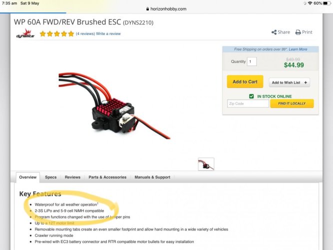

-I see that the esc is only rated for 2S and that's not gonna' fly. I plugged in a 3S and tried it, and it seems to take it okay. I was surprised when I heard the esc count off 3 beeps for the cell-count (since it's not rated for it), and am wondering if the LVC will kick off correctly for a 3-cell, or will I need to use a voltage alarm?

The RTR Ascender ESC has always been rated for 2S and 3S, you will have no problems running it on 3S.
