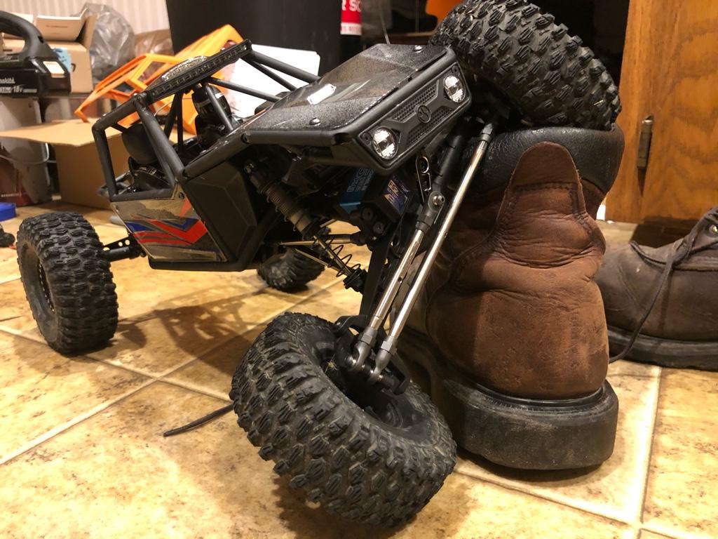

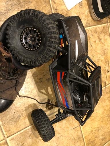

I had wanted a Capra since they first came out. I ended up leaving my LHS with a mamba x, slate 1900kv, savox 1210. I built the kit up as per directions except for using 45.5wt in the rear and 30wt in the front. I also installed a Robinson racing extra hard pinion. I’m running it off Goldblat 1500mah 3s and the wheel speed is great. It’s rolling on the just broken in hyrax’s I had on my gen 8 truggy.

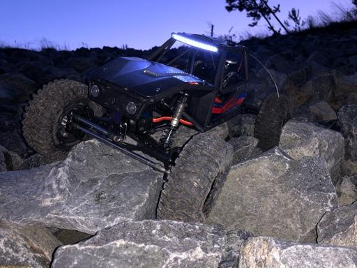

This thing just flat out crawls on the riprap underpass area I go.
I’m going to tear it down on my next night off and try to move my esc to the back of the battery tray to shift the weight bias mor forward.

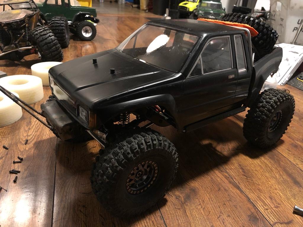

This is the red cat truggy I robbed wheels and tires from.
With a umg10, trx4 sport, barrage, and e10 tuber in the background.
