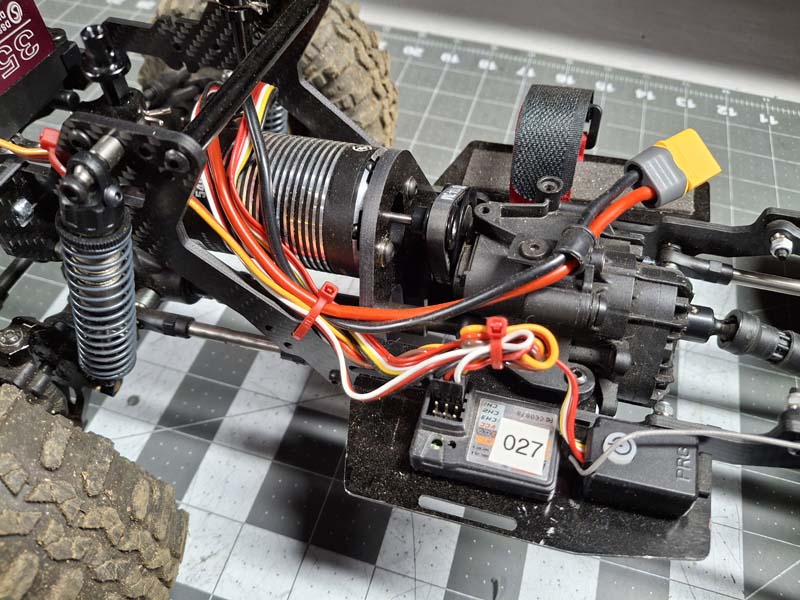

First is the TRX4 Carbon. I had a set of decked out TRX Sport axles with some serious brass, OD/UD, and a bunch of other goodies sitting here collecting dust. I took a chance and ordered an Injora carbon chassis for them and a take off sport transmission and it pretty much all fell together. The Ecto body fits it perfectly and overall it's a pretty nice setup. At this time I was running an outrunner to try and keep the overall chassis weight down.
I felt it did pretty good on the shakedown run, though first time out it had some issues. The GTS shocks are great, but don't have a ton of travel and were a bit stiff with the stock springs. After some head scratching and ebay surfing of shocks and spring options, I realized my SCX10 III has too much travel and way too soft springs. So in a fit of Wile E. Coyote Super Genius I killed 2 birds with one stone and just swapped them between trucks. This was it's first time out on the new shocks and overall I think they are a much better fit - spring rates are better and I get just a bit more flex. Jato was running his VRD for a nice comparison. The Carbon TRX absolutely held it's own.
Even sidehilled pretty good for a portal truck. The only issue was the noise. The Outrunner on a Castle ESC is just loud. I really like how it drives, but the constant whining in otherwise silent woods was getting to me. Plus the pinion and spur were a noisy combo for whatever reason so overall it needed a bit of tuning.

Got the TRX Carbon all back together. Actually, I had it back together last week and took it for a test drive, I'm just way behind on pics. I was not a fan of the Hobbywing system in my IFS Element, but I do REALLY like it in the TRX. Slow, precise and very smooth. When I went to the Holmes outrunner, the power was fine but I threw off the weight balance of the chassis and it was very noticeable, especially on steep climbs. Having a large can hanging off the front of transmission really makes a difference. It's back to it's old ways.
I went belt drive on this one too. 32p gears were very noisy for some reason, it's pretty much silent now. No issues with skipping or anything so far.
Swapping over to the SCX10 v3 shocks made a nice difference. It's just over 2 tires of flex, and that's good enough for me!
