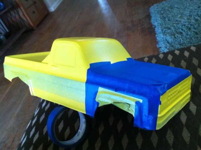

Here's a truck I did. I don't think I did anything but wash it thoroughly like normal.
Paint inside.
Paint outside
More
More masking
More painting.
And done.
I beat on the truck for about a year and then sold it to a friend who gave it to his 5 year old and it's still surviving.
