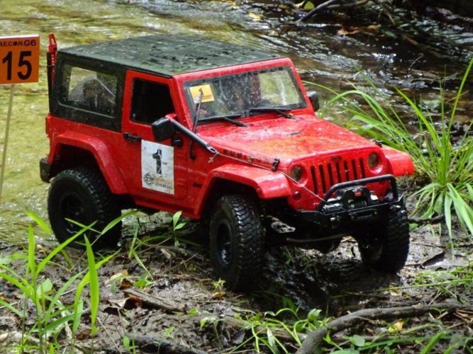

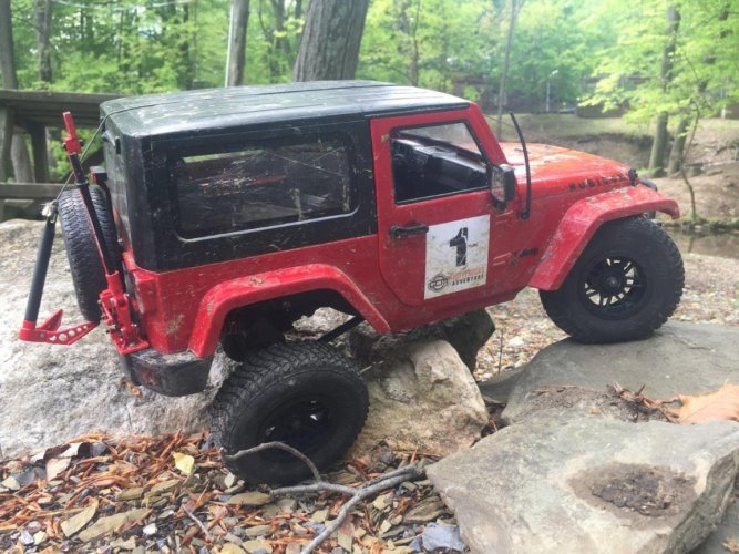

Here are a few pix with the new Pit Bulls:

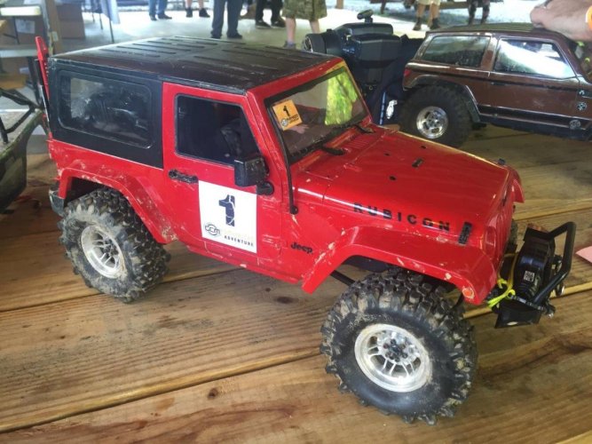

Here's what it looks like with my usual setup for comparison:
Those look really good. Where they broken in at all before the run, or brand new?
Thanks! The set I ran was broken in (came off Desmond's Hi Lift / TLT / Tundra). My experience with other PB tires is they get better the more you run them, esp. after 2-3 solid packs. I would expect the same with these.
Those look super good on that Jeep. Awesome little video chat about these! Ready for my set.
Thanks! We had a lot of fun out there, and Desmond and the Pit Bull guys are good folks. I agree about the combo with the Jeep body. Seems spot on. I look forward to seeing you put them through their paces. "thumbsup"
