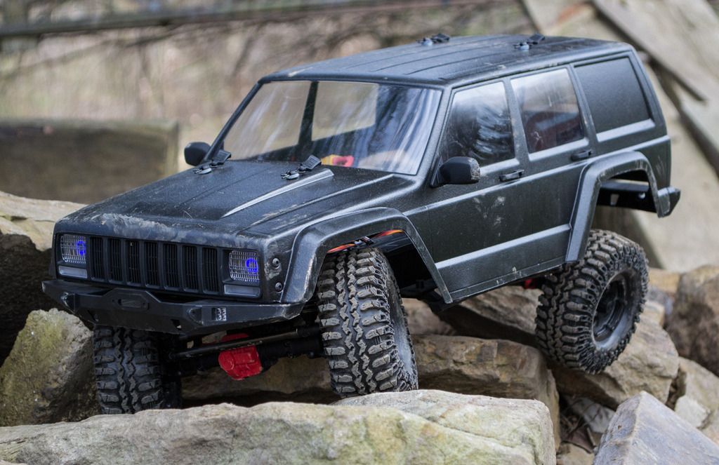

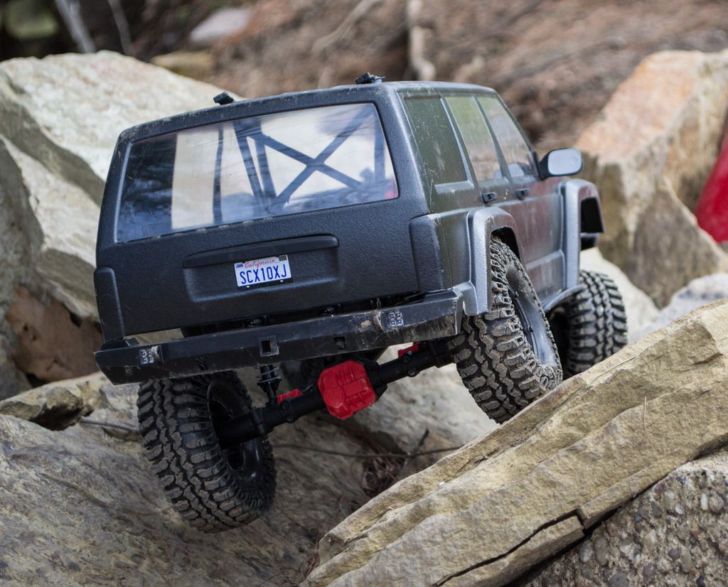

I can get behind this. I screwed up my SCX10 II body by spraying the fenders inside but ended up with a lot of overspray. I thought it was screwed, but saw this thread and figured I had nothing to lose. Ordered some Black #11203 and Metallizer #11287 and just went over the whole body about 7 or 8 times with black, then 2 shots of the metallizer. After that , just cut out the windows and peeled them right off, that was neat. It's kind of an odd feeling, feels like rubber and it does seem to get stuck stuck to it, but you can just hose it off afterwards. The matte look is awesome though.

I'll post up a pic in a bit, it was the SCX10 II kit lexan body. I had to do 7-8 coats before the light stopped coming through so much.

It sounded like a lot, but even at 4 coats there was still quite a bit of light bleeding through. After 7 I was satisfied, only a little bit of light, but I did the 8th coat because I needed to get the side skirts some more. I used this: https://www.amazon.com/Performix-11...id=1491347133&sr=8-2&keywords=performix+black
I think the black looks fairly decent...
maybe a little grainy,
but no more so then spraying bed liner on, and how that would look on a 1:1.
I've seen that applied on more then a few occasions and think the black PD mimics that look purdy well.
Now let's see how well it holds up to abuse !?
