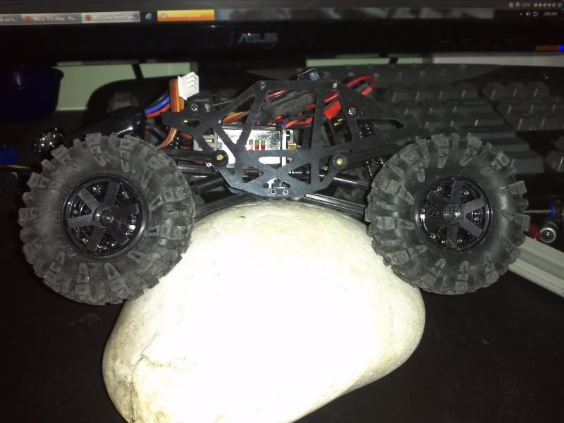

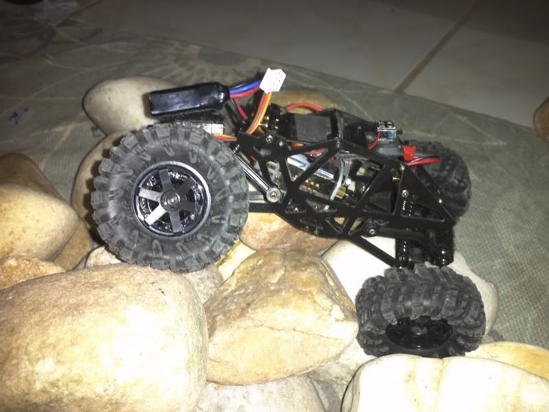

this trekker is stock other than the Micro Eclipse chassis,tires, & the Danally 180 stroker motor
Trekker is a great base for comp style crawlers. Its got a nice width & wheelbase. In fact some comp rigs use trekker links. the Hot Racing wheels are nice, but you are going to have do some cutting to the tire to get it to fit.
Someone on here has a post with pictures but most just use other wheels.
there are 2 threads on how to turn the wheels into the beadlocks, or you can try the RC4WD beadlock wheels.
I found this statement sort of funny. Other than the upgraded chassis, upgraded wheels & tires, seriously upgraded motor, that's a stock Trekker.

Stock in relation to the links and drive shafts. Axles,shocks,servo & electronics are stock.Most people lengthen McRC links and shafts to about the length the trekker is,many even use the tre kked/Mc4x4 parts on a comp McRc. Maybe with the McRC discontinued there will be some longer chassis to fit the trekker. The Micro Eclipse chassis I used is no longer made last I knew. As far as servos a more popular replacement because of price is the MG90 servos.you can find them on valuehobby.com as well as liposuction for around the same price.

Btw if it matter the eclipse chassis pictured is the same wheelbase as a trekker and keeps the links in the same place.

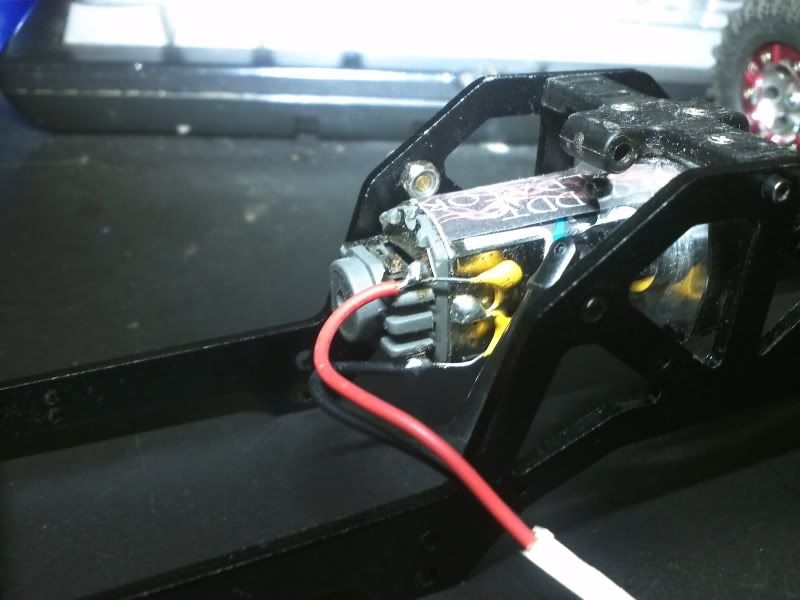

Thanks for all the help guys really appreciate it. The MG90S is it the tower pro from the what to buy sticky for 7 dollars? Also thoughts on a regular DDT not a big block and the miclaws? I'm looking for a nice controlled Crawler not a race truck. How many turns in the motor as well that still confuses me. And yes ill be running a 2s lipos probably 300mah thanks again. Glad allthread and tubing is really cheap!

The higher the # of turns a motor has the slower the speed and the more torque. lower turn motors are faster and have less torque.
the small stock sized motors are great, affordable and a direct drop in, However the big block kits should be a direct bolt in to trekkers & micros and offer even more low end torque and most importantly better low end control while still giving you enough speed to bump over things.
On the trekker the big block & the 180 stroker are a bolt in with the Danally kit, the 180 stroker is cheaper than the big block and gives you INSANE low end control & torque even over the big blocks. Danally provides all the parts needed in the kit.
The 180 stroker in the Trekker (MC4x4) is a tight fit but requires no mods with the kit. the 130 big block is the same diameter just shorter
